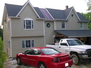

well the sheathing is already gone! Actually, there wasn't any sheathing. The house was built in 1900 and it had 5" wood dutch lap siding directly on the studs. Most of it is off. I prefer for it to be off to open the two attics up to each other. The old house doesn't have adequate ridge venting in my opinion. I argued with the roofer that they should have cut the opening bigger in ridge. I was hoping to create more open area between the two attics to help with ventilation. There was a gap between the old siding and the new trusses. If I really want to tie the rafters and trusses together, I think it would be best to cut something to fit snugly in the gap between the two and then nail or trusslok it to the rafter and the truss. Here are some pics.
front view-old house on right. new house begins at metal roof. Note that there isn't any siding needed above the rafters. The overhang of old roof sits on top of the new roof sheathing.

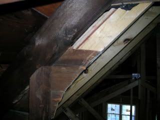

rear view-old house on left. the area in question is the 12/12 pitch roof where it meets the new large roof on the right. note that in back the new roof is higher than the old roof, wheres is front the new is lower.

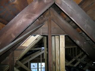

view from new attic looking into old attic. the front is on the right. You see the rear rafter sitting below the rear section of the truss. the peak of new roof is right above the vertical section of the truss. near here is where the truss and rafters cross each other and are tied together.

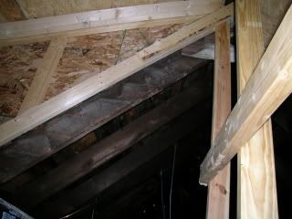

from inside old attic looking into new attic. the front is on the left. note old rafter sitting just above the new truss. note the roof sheathing for new roof just below the rafter

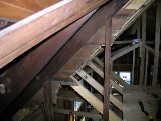

another view as above except a little wider angle. Note the platform with pry bar. That is my access to heat pump in the old attic. The stud that is under the peak is right in my way! better view of this on last photo.
so I really need to cut out the stud in center to get a 24" access. I put up platform on the trusses and it had to be 24" and I had to go up until I got a 24" wide space. But the center stud falls about 8" from edge of this space.
