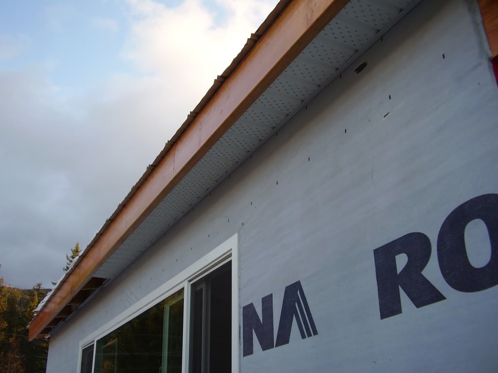

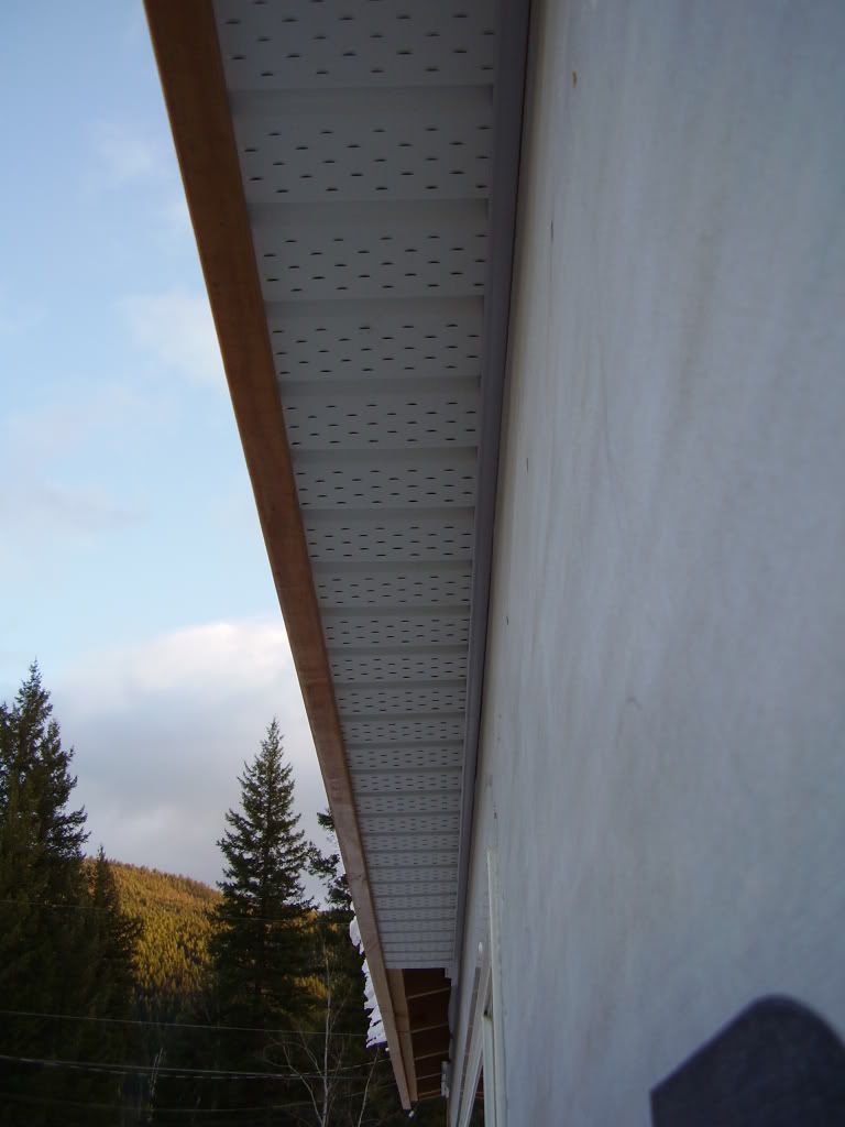

I wouldn't put a 1x8 facia on a 2x4 nailer board.
Will definately cup
Install a 2x6.....might have to cut the tails of the rafters a bit to make it flush with the bottom of the nailer board....all depends on your pitch
That's where your metal J-trim will be installed to accept the soffit material.
Level over and snap a line on the wall to install another matching J trim.
Soffit should be slid in from an end of the trim if this is the method of application.
I eliminated my J trim at the facia by cutting a groove in the backside.
Cleaner look....asthetics and all....
The rafters and nailer boards in the pics are 2x6....with a fir 2x7 facia

I am a carpenter by trade.Beer 4U2Beer 4U2
FYI....those were pics of my own cabin.... I'm finishing with a little more detail.....much cleaner look.
