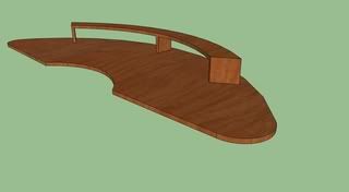

. Now you will have to decide on the wood. If you have a hardwood distributor than I would go check out the prices and selection they have there. They may have maple, oak, or birch plywood. Otherwise, like I said before you will need to do some edge gluing.

What type of wood would you recommend? I've been told to use grade A plywood for the sides and then oak for the surface, but as far as different hard woods go, I don't know much about them.
If your uncle has a planer in his shop you could make your desk out of plain old 2x3's. Glue them together and plane them smooth. I made this bench for about $80 dollars. You could build three sections and bolt them together. The edge is a 2x4 so there is room at the bottom to bolt through.
001.jpg picture by mgmine - Photobucket
