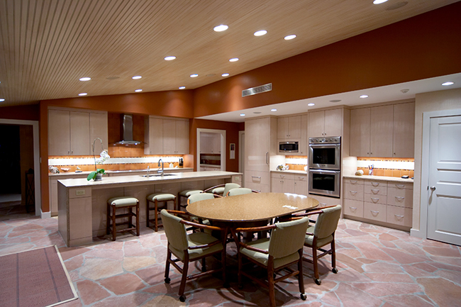

Are you applying this T&G over existing sheetrock? If so, you should not have the problems mentioned by Bud, but if a raw installation, you will need the barrier. The longer the length, the more unwieldy it will be. If you are doing this by yourself, then shorter pieces, although seams are inevitable, would be best. I have never had any substantial warpage with 6" T&G. You will possibly encounter some shrinkage if you don't acclimate the wood properly.
We did this one over sheetrock, using 2 1/2" finish nails through the tongue and into rafters. Good solid fit using 12' lumber.
You'll save your self some time and effort if you stain [or not] and apply 2 coats of poly [sanding between the coats] prior to installation. It's lot easier/quicker to finish the wood on saw horses!
With the exception of some beadboard T&G almost all the T&G ceilings I've finished have been 1x6s. IMO the joints are acceptable as long as they are tight. My youngest son's house has flat ceilings but has T&G like Larry pictured.

I agree on finishing while down. These were stained and lacquered in a paint shop prior to my taking possession for installation. Marksr KNOWS I don't paint
