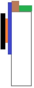

As the title says, I'm going to be mounting this TV, (42 inch Vizio weight 35 lbs) on the wall. Here is the wall specs. the wall is 7'6" floor to the lip, ceiling is unfinished. At the top of the cement wall is a 5" space before the sill.
Caveat: we are in isolation and will be until there is a vaccine. Wife is immuno compromised and we just won't risk it. so, I have to work with items I have on hand: I have screws for the back of the TV to go through the wood (1x4x8) and washers for a good solid hold.
Problem here is that I have only 1 piece of wood. So, I plan to cut it in half and mount the tv to the wood. Next, I will cut 2 small pieces to go over the lip, these will be from scrap 2x4's which I have. I plan to attach the 1x4 to the2x4 scraps using 2 black construction screws and glue. (Loctite Power Grab) Then I plan to put the whole thing up and attach the 2x4s to the sills again using black construction screws.
My concern is whether or not this will hold the weight. I have no engineering experience and hope someone here can lend me some thoughts.

On the TV screws.... they are metric thread and you must make sure they don't penetrate to far into the TV. When I hang a customers TV I use a plastic probe to determine the maximum length of the screw.
this TV, weighs about 10lbs, (ev42 inch Vizio weight 35 lbs)
Not sure what this means. The TV is 10lbs or 35lbs ?
In the picture..... looking from side.... is this what you mean ?
green = sill plate
brown = 2x4's
blue = 1x4's
orange = wood ?
black = TV

@PJMax, Yes, i have the correct size M6-1.0 for the tv, in the correct length to not work. sorry, I've edited my errors, it is about 35 lbs, not 10.
In your diagram, no orange. The tv would be attached to the 1x4s (2 of them). I plan to drill pilot holes for everything.
@PilotDane RE: constructions screws, I have nothing else with which to attach the 1x4 to the 2x4 or to attach the 2x4s to the sills. I had planned to pilot drill all holes, and yes, your comment about 1x4s splitting is important.
Mostly, I'm concerned about the weight. I had originally planned to use 2 8 foot 1x4s but only have one and cannot take the trip to get another one at the hardware store. I don't want to come down to the basement and discover a tv on the floor. LOL

One 1x4 should be enough. You're hanging it from the ceiling. (top of the wall)
Two pieces of 4' 1x4 should be plenty low enough to hang the TV on.
Gluing the 1x4's to the 2x4 should give it enough support.
If you have washers....... use them on the screws. They will reduce the splitting.
