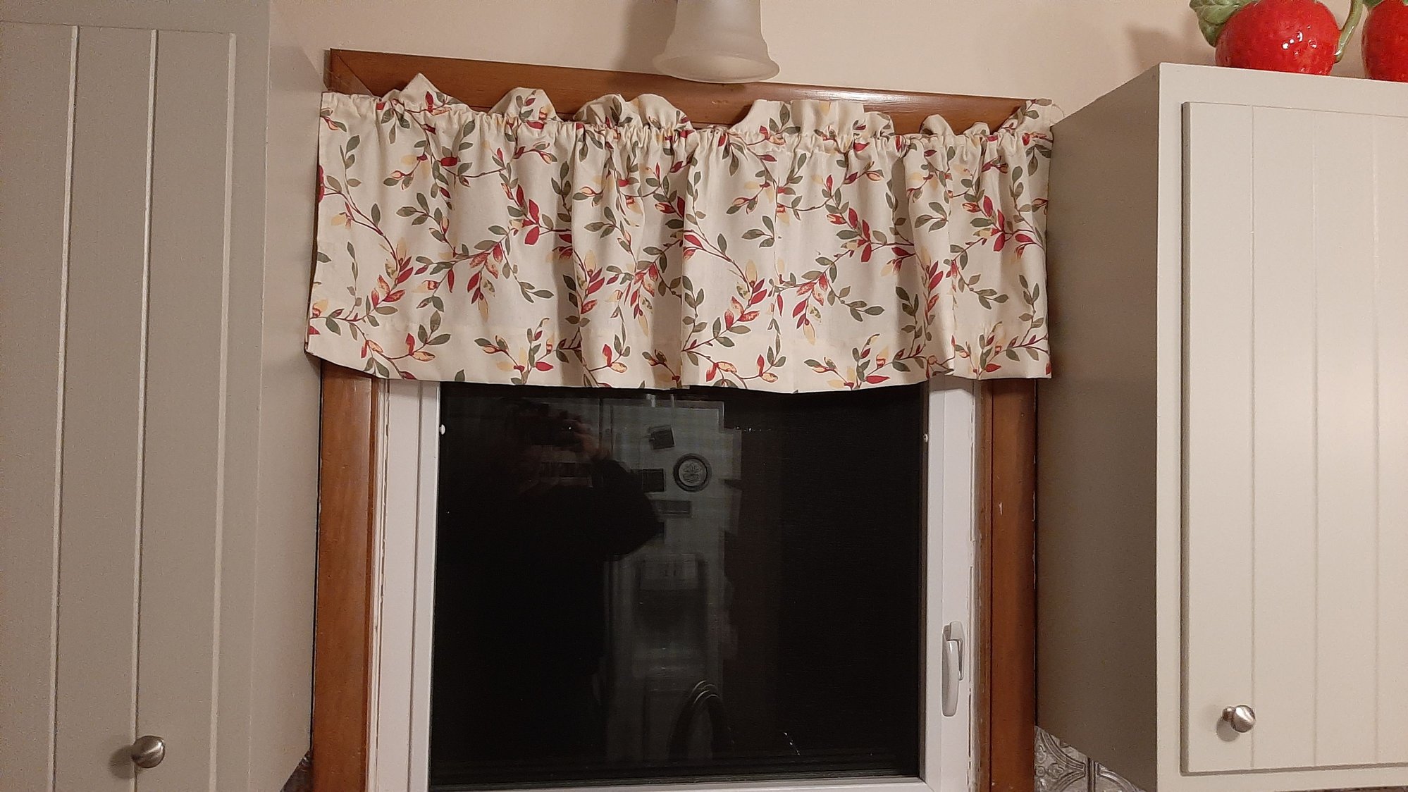

I would like to put glass shelves over the kitchen sink from cabinet to cabinet which is about 37 3/16. I planned to use quarter rounds on each side to slide the tempered glass in. Problem is the length of glass I can find is 36 inches. Any creative ways to kind of extend the mounts out further to avoid having to get a piece of glass custom cut (pricy) and allow me to use 36 inch length glass in 37 3/16 opening?

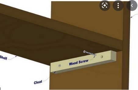

You might want to think about how your going to mount this.
Your glass is getting heavy, planted pots are heavy, quarter round molding is not very robust and certainly not used for anything load bearing.
Thinking a board up each side, securely attached to the cabinets with grooves cut to install the glass or even boards up the side with support cleats!

You will have to build out each side of the cabinets by approx 1/2" then possibly paint or stain to match.
36" of unsupported glass shelving seems a bit wide?

Ok, I elected to custom order a 1/4 inch tempered glass. My question now is, the measurements is 37 3/16 from cabinet to cabinet. Do you all think I am safe ordering 37 inches wide or should it be a little less to make sure it is not too wide any part of the cabinet? Not sure if there is a general rule of thumb when ordering the correct size to fit.

One would think 3/16 of end play would be sufficient... assuming the cabinets are square to each other. If you have a piece of paneling or plywood you could cut it to size just to check that your length will work.
Only reason it wouldn't is if it's 37 in back and 37 1/4 in front. Then it might be a tight fit. And you can't shave the glass.

Marq,
Thanks so much for bringing this up. I guess if I elect to do grooves, I really do have to get the measurements right, depending how deep the grooves would be. Support cleats would be easier, I think. I am thinking if I want to make it a little more pleasing to the eye, I could place something over the cleats to cover them up, or is there something that would be more robust then quarter rounds that would hold them up? (I don't have a router)
Not sure if this changes anything but I am going with 8 inches deep instead of 10.
