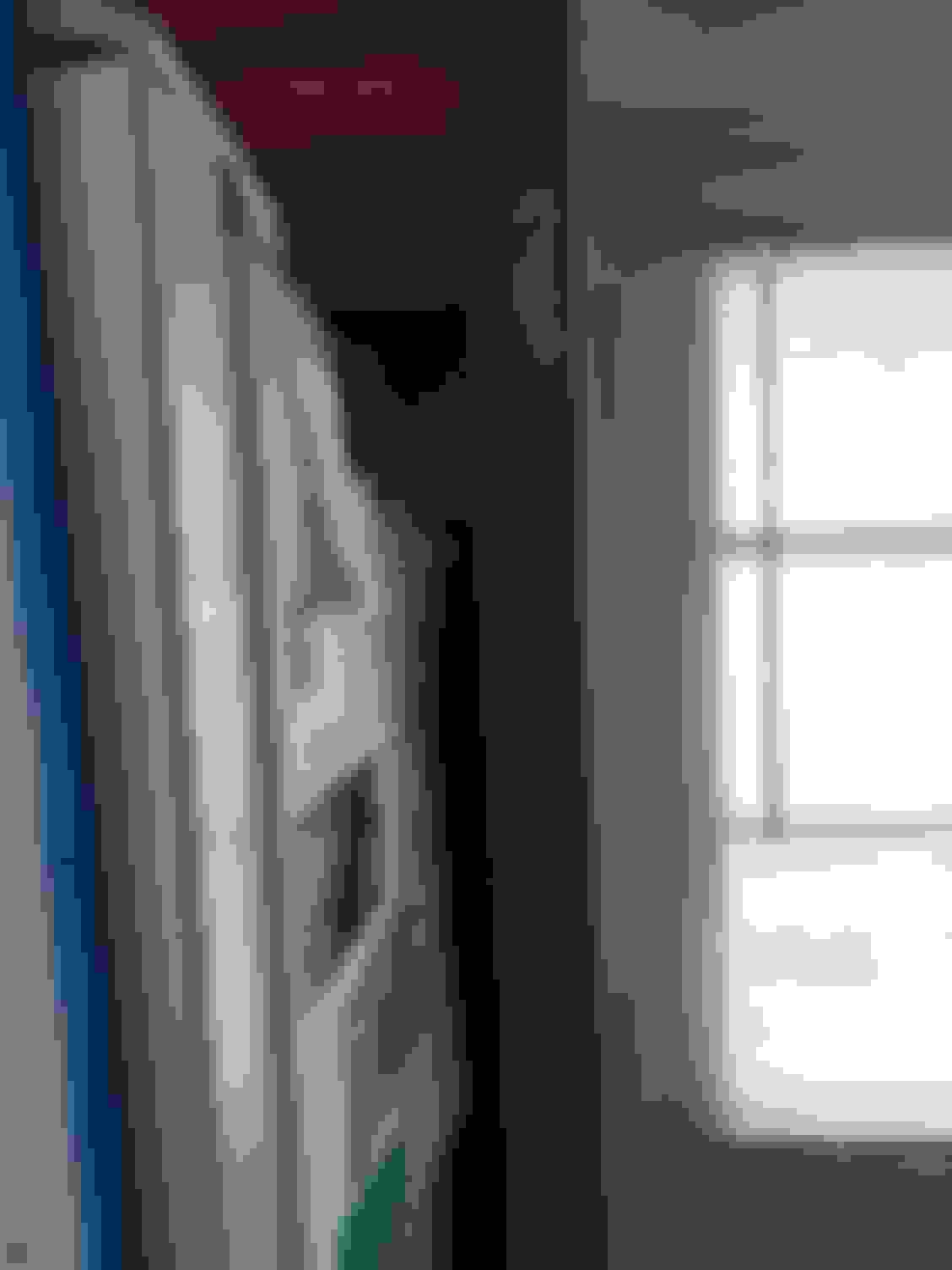

back to the fun. i spent the past week doing non fridge projects that had to be done so we are back
1, last night pulled out the fridge enough to get behind with a tape and measured top..middle and bottom. they dont appear to be all equal. thats a problem of course.
2. even the widest 'interior' dimension..meaning what you cannot see in the picture....it's barely 36. i do know some fridges are 35.75 so it MAY fit. or may not.
3. my pro i want to pay to come evaluation is swamped. unsure when he can come out.
4. i did not post a pic of the cabinets above the fridge BUT now that i pull it out a bit, i saw theres at least 6 or more inches of space behind the cabinets! geez um. is there a way to safely attach them to the wall ? just put a long bolt thru back to the wall? gotta find the studs lol. this would make them seem like they are hanging in mid air if i removed the right side pillar and id have to somehow keep the upper right side panel up there to hide the ugly
conclusion. wouldnt the easiest thing to do be get rid of the cabs above the fridge., and thus the vertical member to the right of the fridge? however if you look at the pic i posted about the left side of the fridge, im not sure how to cut that down. i know i need to post a pic of the upper cabinets for assistance. just dont know how the cabinet will look once i do cut it down. or how to even cut it down. to answer the question above, the right side veritical is right against the door frame.
also huge problem will be i know behind those fridge cabinets is ugly horrible 1952 tile. so how do i hide that! im sure is behind that vertical strip too. . also now wondering if door opening literally INTO fridge is really a good idea. bang! knob meet fridge. i guess will put a hinge stopper thing in

cabinet guy came out and said he could easily cut where i have the line in this pic. he said the most he would have to do to hold up the fridge cabinets is a few screws thru the upper frame. we got to talking about my other projects and i neglected to ask how he would finish off the horizontal edge once he cut the side panel off. any ideas?
a bigger project for me is covering all the tile/glue and wallpaper behind the fridge since you will be able to see behind the fridge and it's ugly

ok another place has the fridge in stock so i wont be getting it thru the original guy. which means its ME cutting this down. fun times. drilling thru the upper frame and screwing into the wood there is ez.
so i guess ill use a jigsaw and cut where the blue line is above. first should i screw a piece of wood to the lower section so the jigsaw goes straight? ill have to finish the end with a handsaw. also unsure how to finish the underside where i cut.
also have to buy a hinge door stop so the kitchen door doesnt hit the fridge.
Yes. Or clamp.
​​​​​​​? ill have to finish the end with a handsaw.
OK. Or a multi-tool. Or if you are up to it, an offset, flush cutting blade for your jigsaw. (I always use new projects to enhance my tool supply if not too expensive.)
​​​​​​​also unsure how to finish the underside where i cut.
De-pending on the thickness of the panel, you could attach an "L" shaped piece of trim, or create one by nailing two thin pieces in an "L" shape to cover the side and bottom of the cut.
​​​​​​​hinge door stop so the kitchen door doesnt hit the fridge.
If the gap between the bottom of the door and the floor is not too large, a floor mounted stop could be used. It should not be a tripping hazard since it will be at the hinge side.

so heres something i just realized...ugh..i HAVE to cut down the left vertical in place. even with the entire right side gone thats only 35.5 inches. i need that extra 1/2 to 3/4 on the left but i still wanna try it. i dont wanna take off the upper cabinets if i dont have to. it looks so much better with the up for continuity of the room
so is a jigsaw with that blade still my best option for 70 vertical inches.
You only need that blade for the last couple of inches at top and bottom. A regular blade will work in between and with finer teeth will make a smoother cut.
Whatever you do you will need a guide attached to the cabinet to keep the saw running straight. Small jigsaw blades are difficult to keep in a straight line. A circular saw would be better. A multi tool blade against the cabinet side cutting from inside the fridge opening to the front of the trim provides an automatic guide and might be the easiest solution. Light planing or sanding the cut edge will be necessary to smooth out the blade marks.

If you are cutting the face frame your best option is a skilsaw that has a rip guide. As mentioned, the oscillating tool would only be used on the top and bottom corners that the larger tool will not reach. You might also need to sand the edges of the cuts you make.
The quality of all these cuts will largely depend on your skill. One way to get a really clean cut would be to rough cut it with the skilsaw, leave it 1/8" long then use a router and a straight pattern bit. The pilot bearing on the router bit would follow the inside edge of a bulkhead, if you are wanting to trim the face frame down to the width of the bulkhead.

thanks to all the help it's done. hope fridge fits in the hole and i dont have to cut down the right wall. hardest part was jigsaw left side top to bottom. should have done bottom up but realized it too late lol. it's far from pretty but for a first timer but main thing is it's done at last. i did use the router to cut some mistakes where the jigsaw didnt go straight. even with the fence i put on the left side. right side was done totally freehand. but dang that was wild seeing all the wood fly high in the hair . cutting vertically is not fun.
i did use hearing protection but other than my glasses i should have used goggles. i still think there's sawdust in my eyes. i put 2 new screws up through the existing cabinet to be sure they are sturdy if i have to cut down the wall.
2john02458 voted this post useful.

You guys can roast me but to be brutally honest that really looks bad,
Trying to cut trim pieces in place was never going to work. Should have left alone or done it right and taken them all apart.
IMO you ruined your cabinets!
