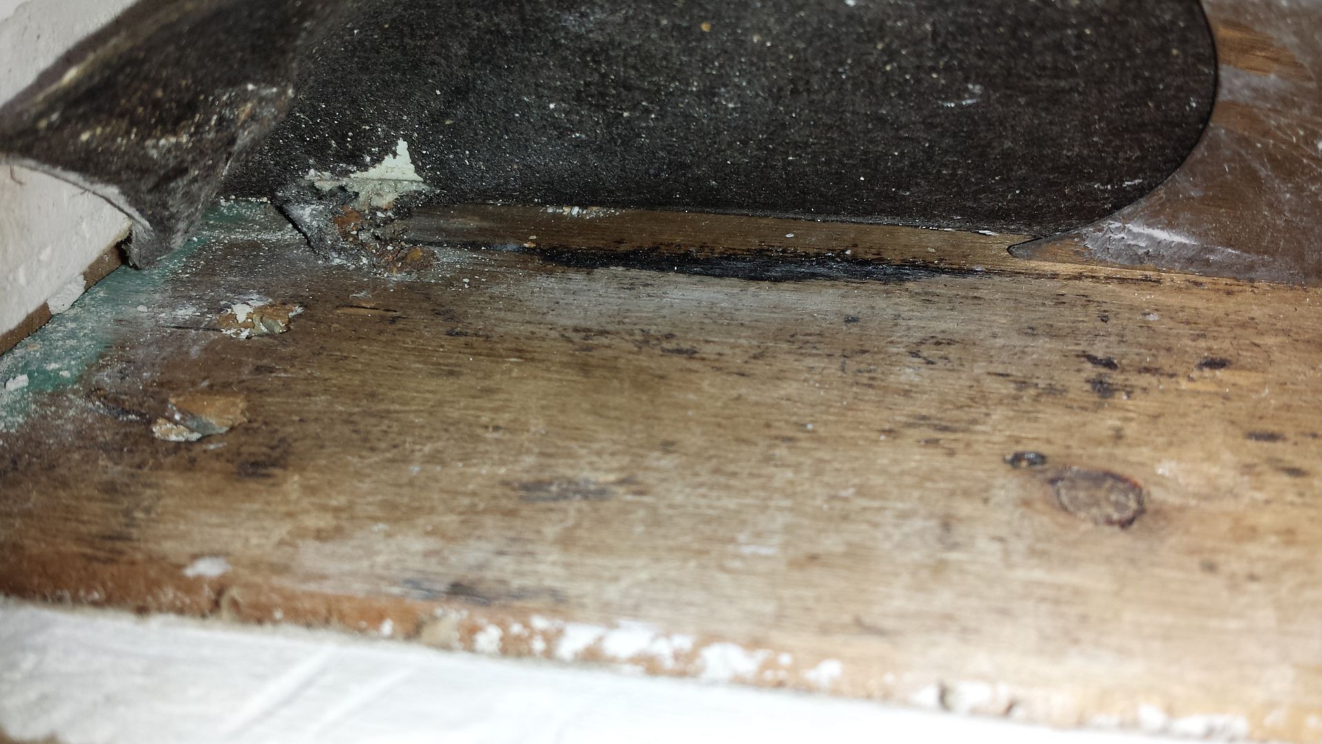

Old 09-04-16, 11:21 AM
J
Join Date: Mar 2013
Posts: 86
I finally got time to take a look... this is what I see when I removed the window stool. There was what looks like black felt type paper ontop of the 2x and under the felt It's a black substance that looks like tar almost.. has a shiny appearance too... The thing that worries me is it smells musty. Any ideas what I should do???
Old 09-04-16, 11:40 AM
XSleeper's Avatar
Join Date: Dec 2004
Posts: 29,248
Received 1,528 Votes on 1,372 Posts
Huh... a black substance under the tar paper that looks like tar. Better call in csi. (j/k) Heh heh. Put it back together and don't leave your windows open when it's raining. There is nothing to worry about here.
Old 09-04-16, 02:43 PM
J
Join Date: Mar 2013
Posts: 86
We never open the windows, mich less while raining! After we got like 3" of rain the other day there was standing water on the stool. I tried sealing outside so we'll see how that goes. The musty smell has me worried because just in that corner smells that way, not the rest of the sill. With that smell it has to be something though right??
Old 09-04-16, 03:46 PM
XSleeper's Avatar
Join Date: Dec 2004
Posts: 29,248
Give us pictures of the outside that shows the entire window and siding.
