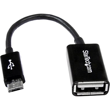

Two suggestions
First, I'd suggest picking up an "On The Go" OTG usb adapter.
Android 4 supports plugging usb components INTO the android device, e.g. use like a computer.
should look something like this
Second, find and install a free program, "es file explorer" for android.
This is an excellent multi functional program, almost a program suit, for reading and moving
files around on an android device, between network locations, to cloud storage, etc.
So, what you should be able to do is - plug camera usb into into OTG adapter.
Plug camera & adapter into tablet, tablet should recognize camera as external usb storage.
Open es file explorer, browse through camera storage, copy pics you want, browse to tablet storage, past to where you want.
