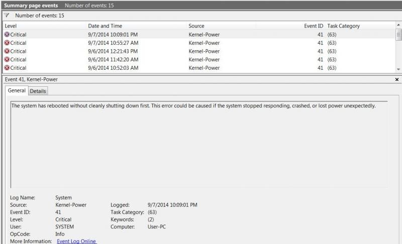

Usually Blue Screens are due to faulty hardware. The key to your problem is Locale ID 1033. For example, one user found a faulty memory stick. However, look at the event viewer. In the run box, type eventvwr.msc & press enter. Look for red error messages in each of the categories. Try to find a corresponding Event ID #. Post it here or search for it on eventid.net

Thought I had it, changed out the HDMI cable to my monitor, no joy. Damn thing ran all day and then puked.
Old 09-07-14, 10:29 PM
Join Date: Jun 2002
Location: Northern Minnesota
Posts: 1,621
All the critical messages were the same. This morning it ran for 2 hours then crashed. Changed the HDMI cable and it was fine for hours (fantasy football) then crashed later in the evening.

Event ID: 41 Source: Kernel-Power
That site contains various comments on Event ID 41. I haven't read all of them yet.

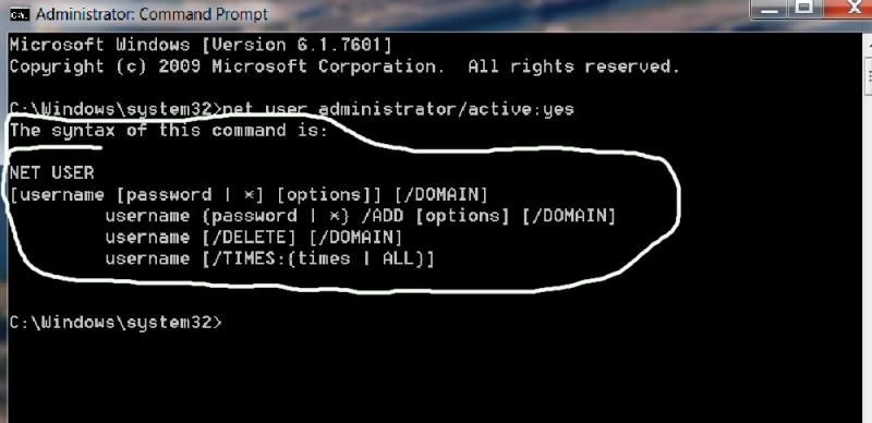

I want to read the minidump but I must be an administrator I guess, "access denied."
Found a video on how to do that but a question: nothing in the video shows anything about the password and the other stuff circled.
If I hit 'enter' at this point I won't be somehow locked out of my computer will I? I don't think I have passwords for anything.

If Windows is asking for your administrator password then you need to use it or Windows will just deny you access to whatever you want to open. You can crack your password that was used and there are several programs that let you do that. I found a website that lists several programs one of which I have heard of called Ophcrack but have never used it and several others I never heard of before. Here is the link to the programs 7 Free Windows Password Recovery Tools.
Supposedly too you can crack windows administrator passwords by going into safe mode and changing your password that way. Some say it works and others say it doesn't I will however give you the link to that too How to break windows password ?. If you use the software scan the download first before installing it and then scan your computer again to check your hard drive.

So sorry, I guess I didn't explain that too well. I did manage to create an administrator account and the minidump file I wanted to look at was just code gibberish.
