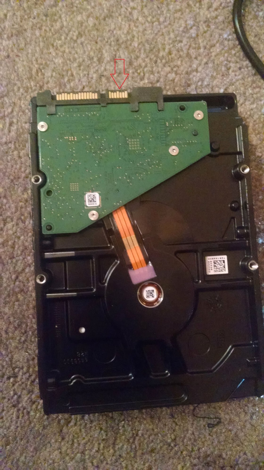

I tried to install internally. I found only one of the 2 clips that attaches to the HDD. See attached photo. The clip to the portion with the arrow is missing.

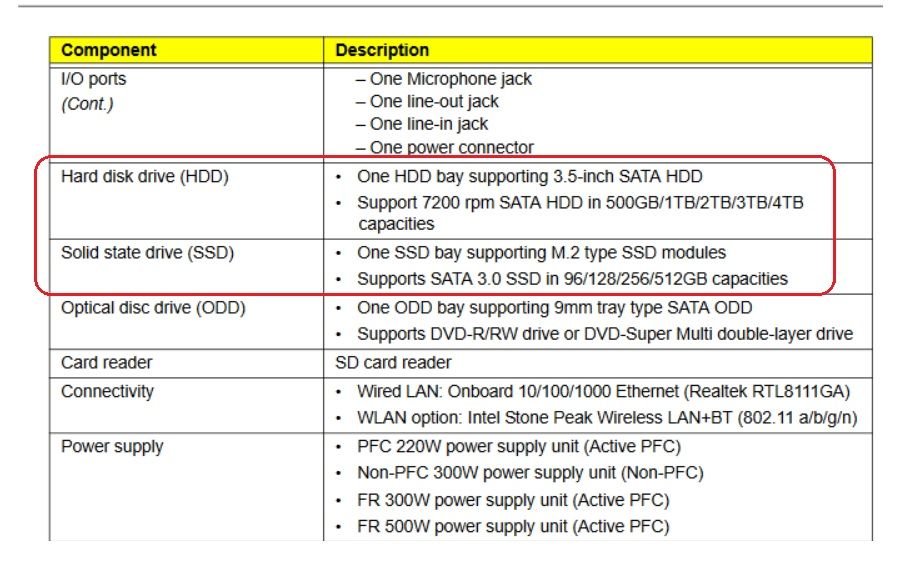

Dixie - thanks. I came across the motherboard specs. Do I read this correctly that I can only go up to a 4 TB drive?

That's what I see. There are guys here that are more educated on this than I, but what I'm seeing is a 4 TB HDD drive, connected to that internal port is your max. In other words, even without an internal HD connected, you probably couldn't boot up a 4 TB HD via USB in one partition. Connecting via USB would still give you 2 partitions even without an internal drive.
I would suspect probably a 2TB external drive via USB is gonna be the max your system will allow.
You should be able to connect a 2TB external HD via USB as one drive, along with your current internal HD & be good to go. I dont see any reason why not.

The cable that you're missing is the data cable. I looked at a picture of your motherboard, and unfortunately you only have 2 SATA ports. The only option you have is to temporarily remove the SATA cable from the DVD drive and plug that into the hard drive.
As to whether your motherboard supports an 8TB drive or not, I don't know. The chipset is recent enough that I suspect it should, but I can't say for certain.
