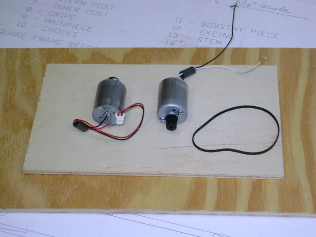

The 2 motors in the attached pic are 1.25Ē long by 0.75Ē OD each. I removed them from an old printer years ago and I didnít pay attention at the time to see how they were connected to establish if they are AC or DC (my bad)
Do you know by the looks if they are AC or DC? Is there a way to establish that including the voltage?
The 2 power wires attached are tiny like a thread

While I can't say for certain, I would be willing to bet that the motors are DC. Almost all printers use DC voltage to run the electronics and motors. As for voltage, I would guess 12VDC maximum. Unlike AC synchronous motors, the speed of these motors depend upon the voltage (higher voltage equals faster speed).

I also vote DC as the one with Red/Black wires the red one has a red dot meaning the positive pole of the DC circuit what voltage I have no idea. Most printers use 32 VDC (at least the ones having external power bricks I am looking at you HP with your weird proprietary connectors). The motors might be 24VDC if you know what make/model printer you can possibly find a service manual that states the motor type and voltage.

Thank you guys for the help. It is true that one motor terminal, in both motors, has a red dot so that indicates the motors are DC. Unfortunately I don’t remember what printer it was to find out the specs but I do have both 12 & 24VDC power supplies and will give it a try soon

Got a chance tonight to try the motors. First I used a walwart of 12.8VDC and nothing happened.
Then I used a 24VDC and the motor went like crazy. Fortunately the motor shaft has a tiny gear mounted on so I should be able to gear down to the RPM I want.
I plan to use these motors as an elevator to lift 1/2” marbles on a marbles track system I make as a hobby
