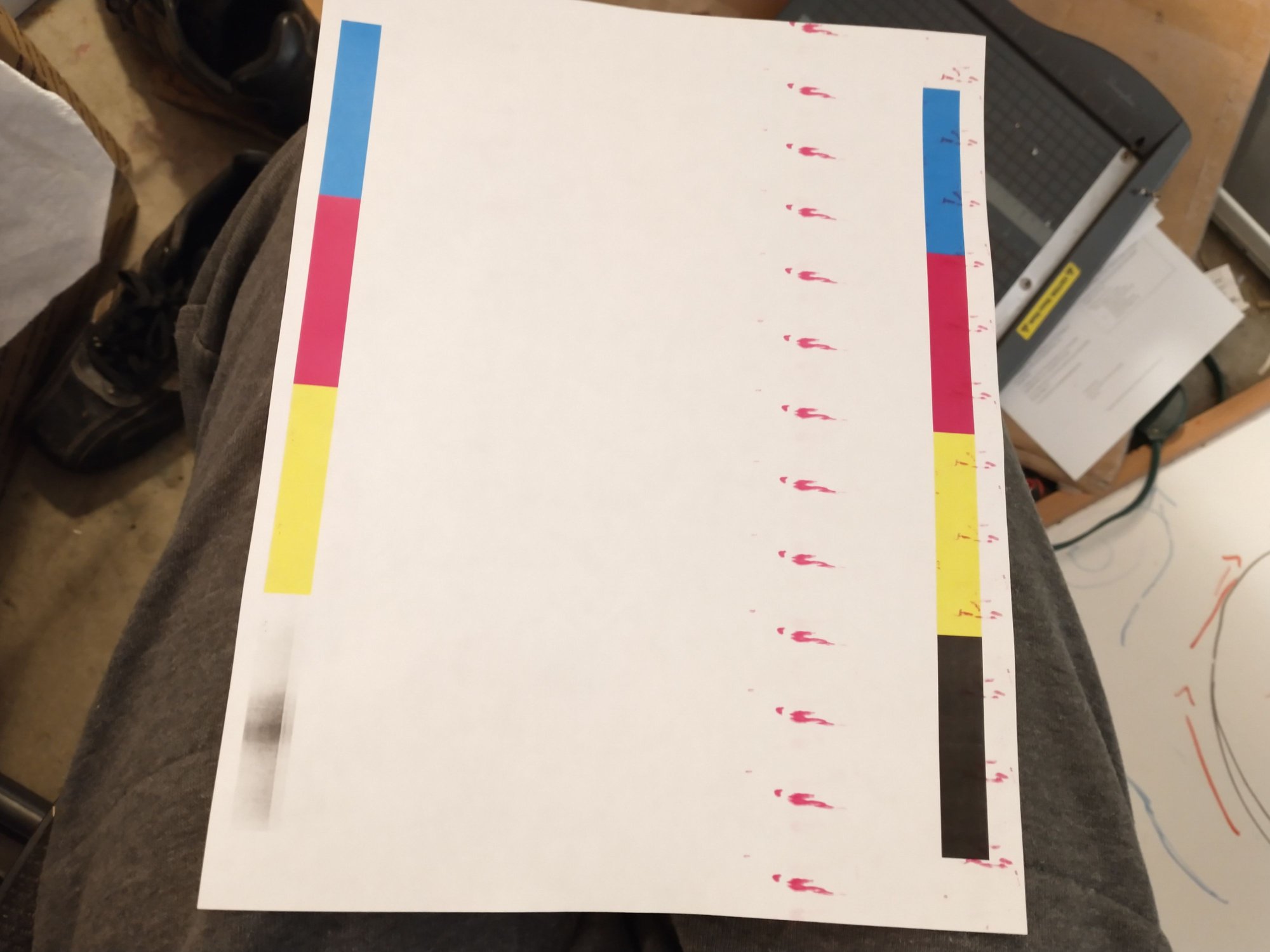

This basically sums up my issues. The Magenta specs have returned. I think that's due to my messiness refilling it. Apparently I didn't clean it up enough.
And yes I did shake it up a few times and nothing changed

well I'll just update this thread: I took apart the cartridge and cleaned up all the parts with no success. I then swapped the drums between this cartridge and the blue one. No difference. I then swapped the cartridges themselves in their seats. It worked on the left side, albeit blue/cyan. So some other part in there is responsible for the left side fading. Anyone have a clue? I've actually watched a couple educational vids on how these things work and they went over my head. Magnetism and electricity. So is there a chip in there holding data about charging up magnetism on the left side no producing the right data for the left side or something? Obviously the a $13 cartridge from China is not a bad option but I'm just curious if maybe I just gotta dip the left end of one these parts in vinegar and viola!. Yeah? No? Maybe so?

I was able to print correctly using the cyan cartridge in place of the black tho. So I think that narrows it down to the cartridge. Right? Some part in there on the left side isn't doing right. I just wish in the end I get to find out what the part is that's faulty. That's the one thing I don't like about DIY'ing, all the unsolved mysteries.

I don't know of anything in a toner cartridge that is left or right. You can see there are electrical connections to the cartridge but they are for applying a charge across the whole thing. I would be looking for a mechanical problem. Maybe the pickup roller is scratched. Maybe the tolerances are off and there isn't enough clearance between the pickup roller and reservoir causing it to scrape the toner off the roller. None of these are "repairable" pieces and need to be replaced. Still, it's fun to take the stuff apart to see how it works.
