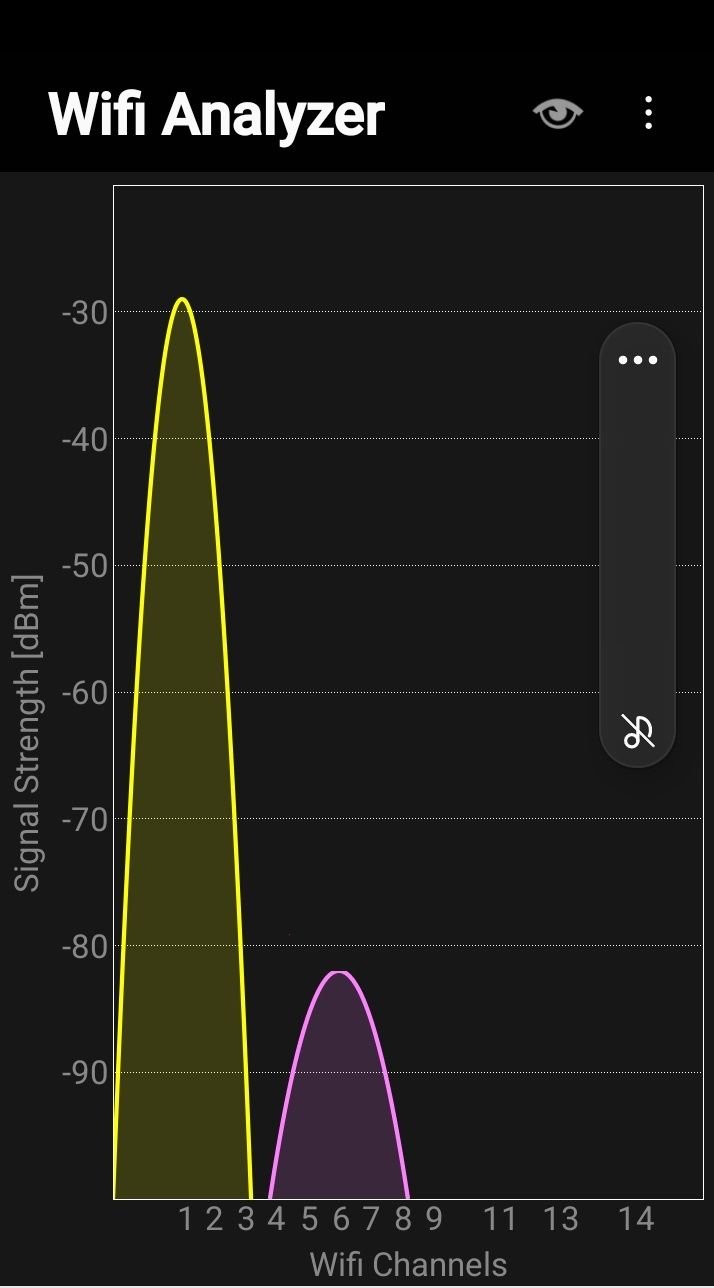

For most routers you CAN choose the WiFi network name- I ALWAYS make the new router SSID the SAME as the old SSID with the same password *(make sure it's a strong password). THEN you just set the routers to broadcast on DIFFERENT CHANNELS. This way you get a reasonably seamless handoff as you go from one area of WiFi coverage to another.
I also HIGHLY suggest doing the same if you have any other routers available-
One final suggestion, a smartphone app - "WiFi Analyzer' will help you see what channels YOU have, but also what channels your NEIGHBORS have. Because if everyone in the area ALL defaults to WiFi Channel 6, then you'll never get good throughput.
For myself, I use the same SSID and password for each router, but spread them across 2.4 channel 1, 6, 11 so there is no overlap and thus no interference.
