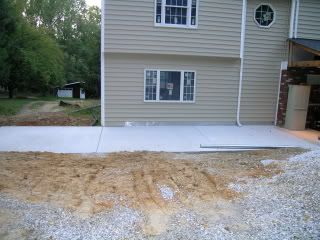

here is photo. The entire slab is sloped away from house, down toward where picture was taken, which is fine for area in front of the house, but the area that is to left of house should basically have an angle on the slopes so that part of it slopes the same as rest of slab and the other part slopes down to left to match what the slope of the deck would have been. But can't change that now.
I don't understand about raising ledger? If I do that, then I will have toe stubber at that location. Since going to be covered, do I just put top of ledger 5/4" below the top of slab (5/4" being the height of decking) so that deck and slab are even? and don't worry about fall. I guess I could keep ledger at that height, plan for fall in deck, and then transition the decking where it meets slab by some kind of shimming so that there is gradual slope from the slab to the rest of deck. how much fall should deck have? It will be 12' out from house on left. 1/8"/foot or 1 1/2" for the 12'? then I would have to transition that 1 1/2" out enough so that it isn't trip hazard as it would not be identified as a "ramp"
no support for deck on slab was planned. although this slab does have 30" frost footing as it will be carrying the roof load of the porch roof in front of house. So I would think I could use it for support if I wanted?

hammer rash. I don't see a door there yet restricting you on ledger height.
Maybe we aren't on the same page hear. Is this deck actually laying down on the Crete? Give some better details here please so this middle age G.C. can help you. I'm looking at the Crete as basically dirt unless its supposed to be the actual floor for the addition ?? The unsloped Crete tells me there wasn't proper work done and nobody caught it.
Is that flat are supposed to be a parking area and that changed?
I also see 2 b clean crushed stone there. Was that left over from the slab pour? That dirt area looks bit to high or all of the Crete including the pad sloped away from the house too low.
In a nut shell standing from the picture angle shoot the far left pad and level from there. snap/pencil line on house. Thats level. So raising that line will give some slight slope and then do mini post elevate the deck accordingly. now if I'm off base here let me know. Give better details on what lumber you are using in dimensions and is all the Crete getting decking over it?
If you are planning on just laying down 5/4 grids and the 5/4 on that for a floor this is also bad construction. for drainage under the floor not to mention possible mold starting, and the treated lumber will rot due to wet Crete especially in that flat area. So please get back to explain more thanks!!

no, the deck is not going to be sitting on slab. but the deck will be on left of house and will meet the slab in front. The slab IS sloped-water running down that downspout does fall off the front of the slab. The deck is going on the left, and will wrap around the back, which is where the door will be. So there is some restriction on height. If I made the deck so it is same height as the slab, I will end up with a 4 1/2" step into my house. Inspector was fine with that.
You are right, I do have grade issue in front. What I was thinking was putting a retaining wall on the left edge of concrete and extend it around the left front corner to about the end of the first "groove" in the pad, which is where the end of house is located. The concrete has adequate footer for this as I did plan it out. Just forgot to have them slope the leftmost section of slab down to left, instead of down to front.
you are correct that is 2B stone. It was from pour and will be using it in driveway also.
will be using 2x8 for ledger and joists. Undecided about surface. Looking at composites. Trex samples are 1 1/8" , EverGrain and AZEK are 1". I will decide which I am using first, then plan ledger accordingly.
If I snapped a line even with slab at left front of house and then raise that up, I will have toe stubber as you walk from slab to deck.

sorry its been a while. I think you are confused lefty. The slab does NOT have any slope in the direction that the deck joists will be running. see above photo. the entire slab slopes down in direction of where photo was taken from. water falling on that portion of slab to the left of the house will not run off the slab to the left, it will run off the front of the slab. I have another problem, but since not related I will start new thread.
I'm not confused -- your slab slopes to the left in the photo, and your joists will be perpendicular to that slab (running out to where the photo was taken from). If you make the deck level, you'll have a 'toe-stubber' at one end or the other where the deck and the slab come together.
So, you have two choices. You can build the deck with a slope that matches the slope of the slab, which eliminates the 'toe-stubber', or you can raise or lower the deck one step and make it level, which means the rise of the step at one end will be slightly different than the rise of the step at the other. But nobody is going to stub their toe on THAT!! It's a gradual change.

NO, there is no slope to the LEFT. If I were to put a level running left to right in the photo, it would show that the slab is LEVEL. But if I put the level with one end at house and the other pointing to where to photo was taken from, it would show fall away from house. All three areas of the new slab are that way. And the left of the house is where my ledger board is going to attach with the joists running left to right as seen in the photo. So if I put joists even with slab along their entire course, the deck will be level. Since this is going to be covered and 12' wide, I guess this will have to be OK as no water is going to be anywhere near ledger. I suppose I should have caught this when they were pouring so I could have had them slope to the left.
OK -- it's been a while, but now I see what you are looking at.
You don't want to build the deck "level" as that will create a 'toe-stubber'. Build it to match the 2 slabs that you will be attaching it to. In one direction, that will be "level", and in the other it will have the same slope as the slab.
Don't concern yourself with "level" -- keep it flush with the slabs involved.

I guess it is hard for me to explain any more. the pic shows the front of the house. you see how the slab extends past the house (by 12')? it was done that way because I am going to build a 12' wide deck on the left side of the house. you will walk from the concrete directly onto the deck without any step and then you will be able to walk all the way to the back of the house. This will all be covered-notice on the far right of the pic that there is a roof over porch from old house. This will be extended all the way to left edge of slab and then will make a 90 and go all the way to the back of the house. So the ledger that I am describing is attached to the left of the house. the joists will run left to right in the photo. so I guess they should fall away from house, meaning the leftmost portion of joist being lower than the side attached to ledger and thus house. but the slab does not have any slope in this direction. anything falling on slab will fall toward the vantage point of photographer. it will not fall to the left. so if I put ledger so that the part of deck near house is even with the slab and then put some fall in the joists, the leftmost portion of deck will be below the slab.
5 1/4" from finish floor height to slab. I think i said 4 1/2" before but that is using subfloor. forgot to add 3/4" for hardwood inside.

hammerash I am going to build a 12' wide deck on the left side of the house. you will walk from the concrete directly onto the deck without any step and then you will be able to walk all the way to the back of the house.
So form the level pad ( on the left in pic) heading toward the back small garage theres going to be a deck for the wrap around porch roof. YES??
Think I got it now. The deck flooring coming out from the ledger on that "return" will need to be sloped. And the 12' pad that goes against that first joist "band" will slowly rise above the deck because of sloped deck... YES??
What is the elevation drop off from the level 12' slab to the dirt on side of house the " return"
If this is right do far let me know. If it is I have some solutions here.
Join Date: Jan 2004
Posts: 1,054
Received 0 Upvotes
I think you got it. it is a wrap around porch-shape of L. Actually the more like a C as it will eventually continue around the back and that is where there will be another entrance into house. the roof may not continue in the back of house.
if looking at left elevation view of house, with slab being to the right of house, you have the following:
at far right of house near the slab, the distance from top of slab to the dirt is only about 1'. At the far left of house (the house being 29' deep), the distance from the projected top of slab to the dirt is about 4'.

I think whats throwing you for a loop here is how you are perceiving the 12' slab.
To get this in the head right pretend that new 12' Crete level pad is part of an inside corner of a house, and not a slab. Normal for decks and floors.
Starting from where the new 12' level slab is( point of it touching the house) , head/chase down the back side of the house toward the old garage and level that. From that point slope out for the fall you want. Normally 1/4 per lineal ft.
Form that lowest point furtherest away form the house chase a line back up to the level 12' slab where the width of the deck would be. From there starts the other slope. A compound slope. The ledger/finish floor can now be level with the new 12' slab and no toe kicker and still have slope coming off of two points of the deck
Its splitting hairs here all wood decks drain through the cracks unless its a solid floor.
So Do I have this correct in understanding the problem??? and solution?? If not get back...

I think you got it, and I got it! So the joist closeest to the slab would be level (like the slab) but as you go back toward old garage, each successive joist would have gradually increasing slope away from house. I guess that it is such a small amount that it isn't noticeable, and since the ground is sloped around there it makes it even harder to perceive that the deck slopes back .

The water overall slope is right after the 12 slab to the furtherest outside corner to the old garage. That corner post will dictate the whole compound slope of the deck. You are water shedding from the slab and from the ledger board on the house. Its a bit of a pain for the porch roof post but thats what you are stuck width.
If you are getting a roof above that deck then even better. It WILL drain on the compound slopes. Actually if a windy storm came through on any sloped deck the slope become a moot point. Its the counter flashing where the ledger board is against the house that counts the most here.
Hope this clears it up for you and clear it with the inspector.

If you leave the end of the Azek overhang the joist by several inches, the end of the deck boards WILL curl down.
The Azek can overhang the back side of the ledger 1".
I would use redheads to attach the first joist directly to the side of the concrete, 1" down from the top so that the Azek is then flush with the top of the concrete. I would put a "U" shaped flashing on top of that joist.
#25
Join Date: Jan 2004
Posts: 1,054
Received 0 Upvotes
I know about the "Z" flashing. I already have it -prebent vinyl. I thought that the siding was considered counterflashing (not flashing). it goes overtop of the flashing and extends up higher on wall than the flashing.
OK, so I should attach the first joist to the slab-flashing it first. That is what I needed to know. I wasn't sure if I could put it about 2" away so that I would have room to nail a hanger onto the ledger. If attaching to the concrete, I don't need hanger. May just put an "L" bracket between it and the ledger.
#26
You can put an "L" bracket where the ldger and joist meet, but if both are properly attached, it really isn't needed.
I suggest using a flat waher to space the joist off of the concrete so you will have a small gap to slip the "U" flashing between the joist and the concrete. Another option would be to use Grace Vycor on the joist, which you could stick on just before you slide the joist onto the redheads.
The joist tops are the part of a deck that are most suseptible to water damage. They collect debris and that debris holds water/moisture on them. I always cover all joist tops with Vycor before installing the decking.
