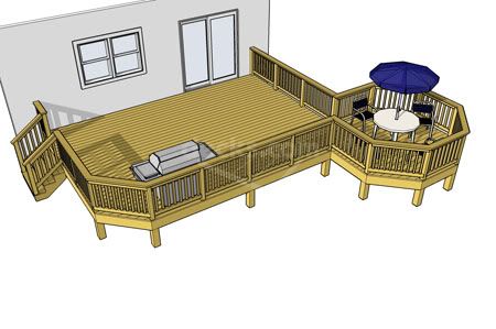

Ok guys heres my dilemma . . .
Its my first time building a deck , but I am proficient with carpentry tools and such , and have all the toys to do the job . … just never framed a deck.
The deck will be 20’ wide along the house and 16’ deep . on one of the furthest corners away from the house will be a octagonal shape like you see in the attached sketch . I plan on putting 4 or 5 footers along the very end of the deck , and was planning on attaching the 20’ ledger board to the house .
If you have a sharp eye , you can see below the French doors that I don’t have very much room to work with … in fact, after I regrade the soil close to the house, I will have about 14” from the ground to just below the French doors. I plan on using 2x10 framing so I can span the entire 16 foot depth of the deck .
So ive realized I will have about 2” of ground clearance  .
Anyways, since I don’t have the houses rim joist to tie into, that means ill need to attach the 2”x10” ledger board to the hollow masonry block ! and NO , I don’t have access to a crawl space or basement to get to the other side of the masonry so I can sandwich the concrete with another 2x10 on the inside of the house . it’s a fireplace room on a slab… part of the garage.

Well, just for reference , the french doors in my photo will be dead center with the middle of the deck , unlike the picture of the sketched deck . Thanks in advance and I hope someone can help
HERES A FREESTANDING OPTION I HAVE IF I FEEL ITS NOT SAFE TO PUT IT IN THE CONCRETE BLOCKS. . . NOT BAD, JUST MORE DIGGING

As low as it is, by all means, free stand. We don't have that option where you walk on the deck at grade level and by the time you cross the deck, you are 20 feet off the ground. Mountains. The less you drill into your house the less possibility of leaks you will have.

Your attachment problems would become nitemares. Make the thing free-standing.
As close to grade as you are, I wouldn't try to get joists to sit on top of the beams. Install the beams (level, of course!) and HANG the joists between them. Doing it that way, your beams need to be set at a level that will become the bottom of the decking.

hope that info helps. heres the deck plan i am doing. i bought the blueprint plan for 30$ .,.. kinda nice to get an idea of footers ,etc . it also came with a triangulation page to help with footer distances , post to post distances, etc.
again , the original picture of the back of my house is deceiving. the grade looks high up on the concrete below the french doors because of the mulch bed there. i rototilled that and will remove a bung of dirt. until then i wont know how much height ill have .
i really would like to keep it to 2x10's so it can span that whole 16' from the house. but ill do what i have to do .. just trying to make it simpler on me since its my first deck build .
i guess the blueprint's measurements below would still work with it being feestanding instead ...

im going to run (3) 2x10 beams perpendicular to the house(6 total 2x10's for the main deck) . there will be 2- 2x10s sandwhiching 3 posts each, along the depth of the deck and there will be a 2' overhang of the beams towards the house. so in other words, 3 double-stacked beams running the 16' . i will have a single 2x10 rim joist running along the house and itll tie into all the main beams . the same applies for the beam out furthest from the house.
my floor joists will comprise of 2x10s.... but since i am keeping the floor joists flush with the main beams theyll tied into the beams with hangers and the max length of each beam is 7' or so . thats where the EXPENSIVE comes in with all the hangers!
there will be 13 posts holes all together on the main deck: 11 spaced evenly and 2 in the lower right corner to tie into the octagon .
i think im gonna make the deck 22' wide (entire length of room where deck is) and make it 22' deep from the house.
does this make sense to anyone?
ill have a drawing soon . i know , the decking will be perpendicular to the house, but hey .. at least i wont have to have footers right next to the foundation .
progress............

no , the beams WILL run away from the house. i was just going to extend the beams 2 feet past the closest footers to the house. so the beams will end up going towards the house and about 3" away from the block foundation , and then i was going to cap the BEAMS with a rim joist. of course ill have no room , so ill have to mount the rim joist on the main beams and then slide the frame closer to the house.
whats messing me all up is the clearance . you have to remember the beams are FLUSH to the joists , therefore i cant do it traditionally resting on top of the frame.
i know a true cantilever is the joists HANGING over the beams towards the house... but to hang over beams you need at least the clearance of the beam height AND the joist height... that which i dont have .
ill draw up a picture here soon and scan it. the very end closest to the house will be the main beams FREELY hanging 2 feet with a couple joists run with the house to support the unsupported hang . hope it make sense....

a good way of seeing what im doing running along the house would be to look at the FIRST DRAWING of that computerized picture . the first pic of the post.
look at the LEFT SIDE of the deck from our view.... thats what im gonna do to the area next to the house.
you kinda have to rotate the deck 90 degrees clockwise in the pic.

ok , everything on the main deck is laid out perfectly and ready for the one man auger this saturday.
the octagon is good to go , all squared and everything .
my question is this :
i have 19" to work with from the top of the 5/4 decking to the grade . . . how should i make the octagon frame if i plan someday of putting a hot tub on it?
so far, i was thinking tripled 2x12's on each of the 2 beams, and running 2x10 for the outer octagon frame and 2x10 joists.
that would bring me to 5" of concrete above grade, 11 1/4" of beam height and joist height, and 1 1/4" high decking.
i would have 8 12" footers 42" deep . i planned on cantilevering the beams further out than their corresponding footer holes by about a foot on each of the beams....
i would then have the other 4 footers not touching beams be on the outer frame edge of the octagon . i would run the joists flush as well .
would this be stronger that having triple 2x8s for the 2 beams and putting 2x8 joists ON TOP of the beams the traditional way ?
this way would also bring me close to the 18-19" i need for total deck height ( 3-4" concrete , beam height of 7 1/4, joist height of 7 1/4 , decking height of 1 1/4 ")
i guess if i knew how to calculate live load i could figure it out... i heard i need something like 100 psf for a hot tub!
i could also put a 16" footer in the middle somehow too .
i just want to know where to drill the footer holes by saturday .

Others may work it differently, but I'd just put in a couple of extra holes and footings under where you plan on having the hot tub. Adding the extra joisting would be odd, and the footings would be solid support.

well ,then ill keep it the same flush style as my main deck... but change it to 2x12's .
i was thinking... maybe one big 16" hole in the middle... but how would i support it seeing how the 2 main beams would be on either side of the middle.
well, i could just make the main 4 footers that the beam support be 16" instead of 12" , and the other 4 peripheral footers on the outskirts be 12" , maybe?
think im complicating things again....

Yup. I have a helper who does the same thing. Wants to make a rocket swing when the customer only wanted a tire on a rope.
Why change to 2x12's? All you have to do is add support under the original joisting where the tub will be.

yup im that helper !
anyways. i marked out all the footings tonight.
theres (8 footings as of now) .
if you looked at it like a square (how its laid out with batter boards) , the 2 footers on the left and the 2 on the far right will all be on the outer edge of the octagon frame.
the two up top and the 2 down low (closest to main deck) will be set in 2 feet per hole . this is supposed to be max cantilever of beams past footers for a octagon shaped deck... and i also wanted the 4 footers as close to being under the hot tub as possible .
i was going to change to 2x12's cus i can , and its not like a need a ton of them . plus ide rather have 2x12 framing (2" taller than 2x10s) than just adding 2" more inches of concrete footer coming out of the ground and 2x10s for the frame and beams.
heres the thing .
i have 19" to make this thing, and i want to make it as strong as possible . im not having posts, as i will place the beams right on the footer caps on the concrete.
so heres what i have for height if i used 2x12s :
5" concrete comin out of the sonitube
1 1/4" tall footer cap to hold the beams
11 1/4" high triple 2x12 beams and hung flush 2x12 joists 16oc
1 1/4" decking
thats 18 3/4" .. just where i need to be
the REAL question is this... what would get me 100psf that is recommended for hot tubs? i cant find a calculator anywhere.
keeping the 8 footers ALL 12" would help, as i wouldnt have to hand dig as much as i would have to with 16" footers since my well water line is close by and 35" down .
i can change anything you suggest. .. but as of right now, the holes are not moving, and they will be dug at 12" in diameter tomorrow when i rent the hydraulic auger.
i can switch to 2x10s if need be for the joists and just leave the beams 2x12.. just need to make up for the 7" height rise this octagon will be compared to the lower deck... since i want to step up onto the octagon .
ok ... ill stop now
