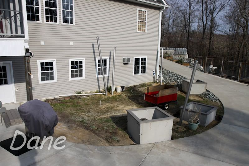

The photo was taken last year. Just added this spring are three commercial sized planters 4 feet square and buried to varying depths. One is in the rock area to the right behind the raised bed. The other two are on either side of the closest sail post. Part of the wood decking shown in the photo was removed to make room (I'll have to take another photo). They will be faced with stone veneer to match the foundation of the house.

Yea. When I was working I kept thinking I should take some photos... Oh, I've got enough daylight to get another planter set... and the photos were forgotten.

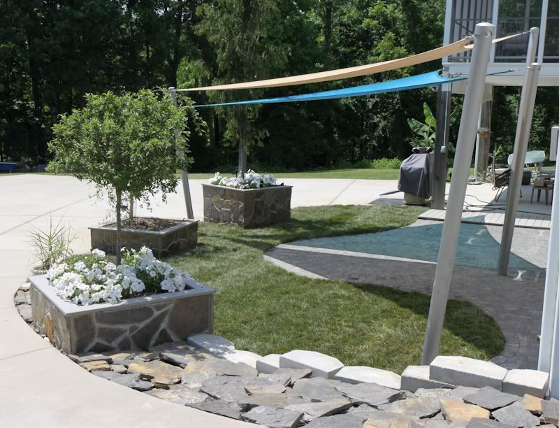

I totally forgot to post some photos until now. Here is the same area with the planters in place.
From above you can see some of the markings where the concrete paver patio will be installed. The circle is for a circle pattern of pavers.
Thank you for all the advice. I have been working on the area this spring as I've had time and I've finally gotten it mostly finished. I used Belgard Bergerac pavers since I had quite a few left over from another project and they match the walkway at the front of the house. I killed the idea of artificial turf because I was concerned with the life span. I hate the idea of spending so much time and money for a product rated to last about 8 years so I went with real grass and installed a small irrigation system.

I purchased the 4" schedule 40 posts from a local metal fabricator/welding shop. It's a pretty common material so they had it an stock and cut it to length for me.
The top of the posts are capped with PVC schedule 40 caps. My sail attach points were near the ends of the posts so I cut half circles out of the PVC where the attachments are to create a bit of detail. After the posts were on site I simply pounded the caps on top of the posts and painted.
One sail has one corner attached to the screened porch of our house. Prior to building the shade sails our weather station has recorded gusts over 100 mph during thunder storms and have done a bit of sailing I know the power a sail can harness from the wind so I was concerned about attaching to the house. I engineered everything so in very high wind the sails should fail first. If they don't the next weakest link are the attachment hardware and as a final security measure nothing is attached to the main house. Now that the serious stuff is out of the way, not mounting to the house was done for aesthetics. Most people attach them to the house or vertical poles because it's easy. I wanted a dramatic impact that looked more professional and less DIY. There are no vertical, parallel or perpendicular lines. The back of our house is quite tall and flat. The angled poles and gracefully curving sails look very cool.
This patio are was planned long in advance. I engineered the shade sails and their mounts to commercial standards so the first part of the project was installing the poles. Their footings are massive and then everything else was built around them. Adding the poles to an already existing area could be "interesting". One nice thing of doing it clean slate it that I could put in the footings to support tall poles. If you can't destroy the area you might have to reduce the height a bit to keep the loads manageable.
