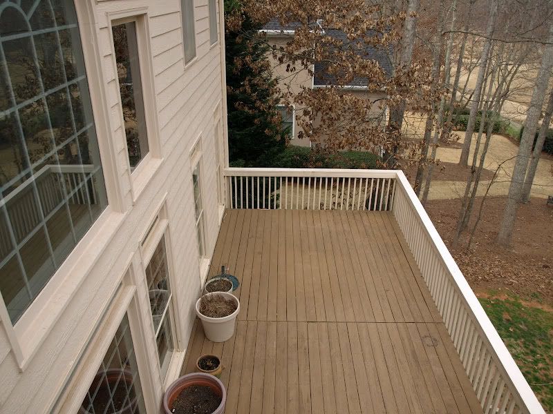

I have a contract on a house; today was the inspection. The house passed with flying colors..... except for the deck. The home and deck are ~17 years old. While the deck boards themselves have been well cared for, it appears that some of the supports under the deck itself are separating from the wall. The deck is approximately 32' long with 24 support beams ~16'' apart perpendicular to the house. About 9 of the support beams are separating from the wall (just slightly).
I'm including pictures below. I included the most egregious examples; basically, I want to know, is this something that will require a massive overhaul or is this something that can be relatively painlessly fixed.
Any help is greatly appreciated. Thanks!!
Here is a picture of the supports themselves --
And one picture from above --

I don't think they are pulling away from the house. It looks like they were cut poorly when built. You can see where they are still touching at the top so they can't get any closer to the house. The only way they can be pulling away is if the outer end of the beams were lifted which should be easily noticed.
Personally I do not like to see the joists resting on a 2x2 even when done properly. I much prefer joist hangers which could be retrofitted to your deck pretty easily.

The joists shouldn't have been notched and toe nailed to the ledger. They should have been installed in joist hangers, and their full width maintained.
Retrofitting hangers, like Pilot Dane says, will be pretty simple. That may be enough to satisfy the inspector, depending on the mood he's in.
The problem with the notches is that they reduced the effective size of the joists. If the joists are 2X10's, those notches effectively reduced them to 2X8's. And the overcuts in the saw kerfs has comprimised them even farther.
Not sure why the builder went to all of that trouble. Hangers would have been faster, cheaper, and stronger.

The deck's hand railing does not appear to be compliant with most building codes, in that interior support posts are missing. I think the IRC requirement (it calls them "guard posts") calls for a post every 6'-0", or less. Your picture doesn't appear to have any.

You are correct that the posts are required by the current IRC, but keep in mind, this deck is 17 years old, so when it was built, a different version of the code applied. May have been the IRC or it may have been the UBC, or something else even. (I've never lived in GA, I don't know.) But built in '95, under the UBC, and depending on the jurisdiction it was built in and what their rules were, it may have been legal then.
As far as the missing hangers and the ledger bolt pattern -- who knows?? Those items may have met whatever code was in force when and where the deck was built as well.
Obviously none of those issues meet today's code, but today's code didn't exist in it's current form 17 years ago.

Actually, your situation might be a lot more dangerous. There should definitely be brackets on the joists but if the joists were square cut, the gap could mean they have been pulling away, either through frost action or rotating away from the house. You don't show the lower structure but I am assuming it was minimum code, 4x4 posts, maybe a couple of angled wood brackets.
The deck needs to be held to the house structure. Simpson and others make tie downs that are also used to hold a wall to the foundation that can be used and are referenced in the codes. Stop at the library (IRC, Section 5) and look it up or better still, the town building office, for advice. I would recommend that you make this connection now, before you use the deck, lest it pitch to the yard taking your family with it. Or get the advice of an architect or engineer for the proper connection. It's a lot less expensive than rebuilding or hospital bills.

All the pros have pretty much weighed in but from what I see, at best, just install joist hangers. At worst sister another joist and add double joist hangers. Either way it would be a rather easy fix.
