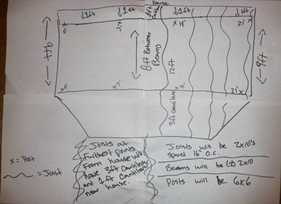

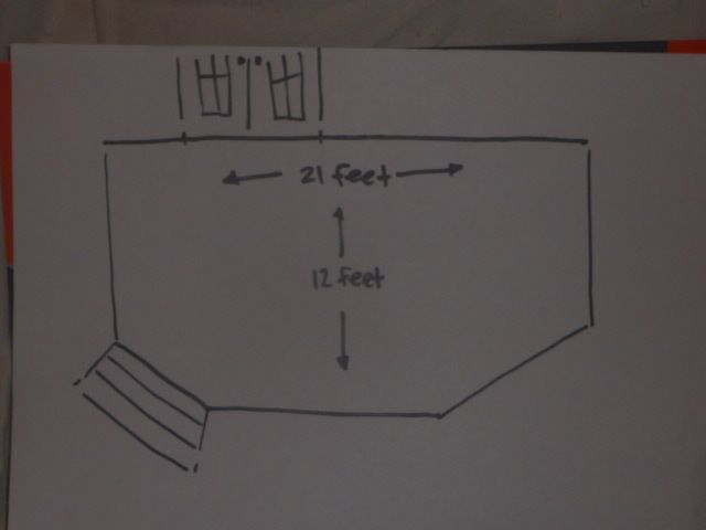

Hey there i am building a free standing deck off the back of my house that will be 24" above grade. The deck will be 21 ft long and at its deepest point 12 ft wide..I have a few questions...
1..For the beam that is near the house it needs to be 21 ft long there is no where i can find that sells pressure treated wood in any more than 20 ft..?there is douglas fir beams that i can get at 24ft length. and apply the stuff that is used to pressure treat?And for a beam that long what size does it need to be if i am planning on using 2x8 joists spaced 16o.c and posts will be put 1 ft from both edges and spaced 5 ft apart using 6x6.
2...What is the max allowable cantilever for the 2x8?
3..How much can i cantilever a beam over the end of a post?

Your beam won't be a single board anyway, so sistering of shorter lumber, say 12' +10' alternating the joints would give adequate support. Glue with exterior glue and screw the beam together, setting it on your posts using post-to- beam Simpson Strontie brackets.

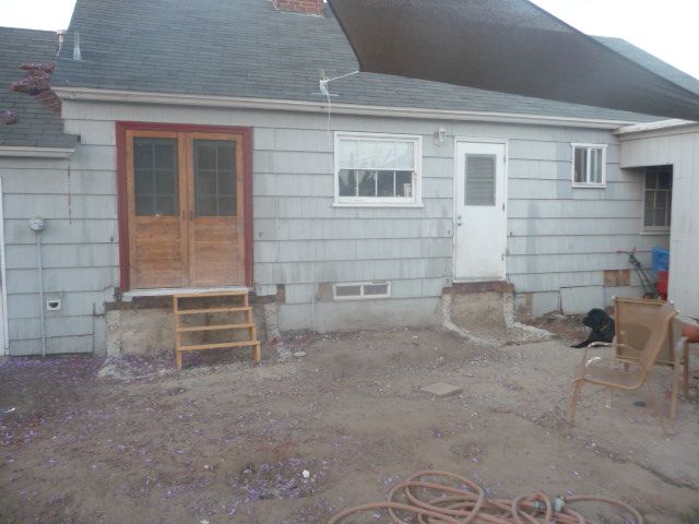

Is that a vent or window under the window between the doors? Will it be covered up by the deck?

Ya that is a vent to underneath the house.i have once on each side of the house..I will not be covering it up the bottom of the deck will be about level with the bottom of that vent. and from the french doors i am going to build a wide single step that comes down 6 1/2" to the deck landing..the single door is going to be closed up and sided.

So chandler what size lumber should i use for beams and how many thick per beam? when i stagger the joints i will have to make sure the butt ends end up on a post right?

I'm sure Larry will be along to answer soon, but IMO, I would use a minimum of 2x10. For the beam in back I'd probably get 14's, and plan on 4 posts for it to sit on, each 7 ft apart. (0, 7, 14, 21). Your 2x10x14 (you'd need 3 of them to make a 21' beam) would be made from two overlapping pieces (14+7 and 7+14), with each joint landing on a post.
But that's just me. Seems to be a good use of materials that way.
Have you thought about what direction you'd like your decking to run? Because you'll want your joists to be perpendicular to the direction the deck boards will run. If you are expecting to run your decking planks perpendicular to the house, for example, you would probably need 3 beams, each perpendicular to the house so that your joists will be parallel with the house, as they run between the beams.
If you want your decking to run parallel to the house, then your beam will be next to the house and your joists will run perpendicular to the house.
If you run the decking at a 45, it doesn't matter which way the joists run... but you would need to space them according to the strength span of the decking you will be using.

Brant covered it pretty well. Yes, your seam should end on a vertical support.

hey x sleeper i am going to run the decking boards parallel to the house so all i need is the beam in the back and beam in the front, i don't need a 3rd beam in the middle right?and all i need is a double 2x10? heres a pic of a drawing with dimensions what do you think? thanks for all your help so far.

A double 2x10 beam is fine. You shouldn't cantilever 2x10 joists 3 ft. To make that shape, I'd suggest you have 1 beam next to the house, and your other beams will be the 3 pc that form the front edge of the deck. I'd suggest your joists sit at the same level as the beams, so use joist hangers for all the joists that will be laid out in-between. They make skewed L & R joist hangers for your 45 angles.
Wait for Larry to add his 2 cents... he's probably built 10x the decks that I have.

those angles are not going to be 45 degree angles more like 60 degree. I thought you could cantilever 1/3 the length of a joist? what size joists should i use if i want to cantilever that much?

The IRC shows L/4 for maximum cantilever, where L is the main span distance. In your case, 3' is not allowed (being too large). Shorten your corner diagonals to make the cantilever shorter, and still use just 2 main beams.

For the L shown in your sketch (8'), allowable would be 8 / 4 = 2'. If you increase the beam spacing and joist span to 10', you can cantilever 2.5'. We can't tell you what joist sizes to use until we know the span configuration and loading conditions (i.e., if you decide to put a hot tub out in the middle, the joist requirements will be considerably "beefier" than if you just use a normal IRC design load of 50 PSF).

The total joist length (12') is not the same as the net span length (L = 8'). As I said earlier, a 3' cantilever for an 8' span IS NOT recommended. You will be very unhappy with the finished product. Unless you deliberately want to achieve a "spring-board" effect.

Trying to consolidate all this. Your cantilever can't be more than 2' based on your joist length. Bridgeman covered that. Your last post and beam should be where you are showing it.....at the beginning of your angle and cantilever. 2x8's will span 9' without problem. Using 2x10's will ensure no bouncy bouncy. Definitely 16oc no matter what you use, since your final decking will require it. Having the joists at the same level as the beams won't allow for the overhang behind the deck, nor the cantilever. Set all your joists on top of the beams so you can effect your cantilevers on both edges and reduce deflection of the joists.

OK -- so the left coast has finally found a little time and would like to chime in on this one.
First,peescal, there is no reason for you to build your own beams. You're in CA -- use a 4X6 for the beam and avoid all of the labor of making sandwiched beams for this thing. You will be hard pressed to find a 4X6 over 20' long, so use a 4X6X10 and a 4X6X12 (or two 4X6X12's) and have the joint in the beam occur at the center of the post supporting the beam. Lay your post spacing out so that this can happen.
Check with your local Bldg. Cept. about the required depth for the footings. They know your soil type. Clay soil doesn't require a footing anywhere near 2'. Sand does. Sand and clay are at the opposite ends of the spectrum. Which one do you have?? (WHERE in CA are you??)
Cantilevers -- you bldg. dept. won't allow anything more than 2'.
Your original post said the deck will be 24" above grade. An inch off of that for the deck boards and using 4X6's for the beam, that will only leave 17" to be filled in by your joists and your posts. Using 2X10's for you joists means the bottom of your beams will be 7" above grade. Are you SURE that's what you really want??
If I were building this deck, I would use 4X6 beams, 2X6 joists, and have posts that were about 12" tallsupporting the beams. Figure the spans based on using that size lumber at whatever spacing is involved. (I've only built about 300 to 400 similar decks in CA, and all but about 5 have been free-standing. I didn't like using ledgers under the UBC, and the IRC totally eliminated them for me!!)

As far as a cantilever, no matter what size of dimensoinal lumber you use, a 2' cantilever is all you can do. (Or at least that is all I would ever do!!)
