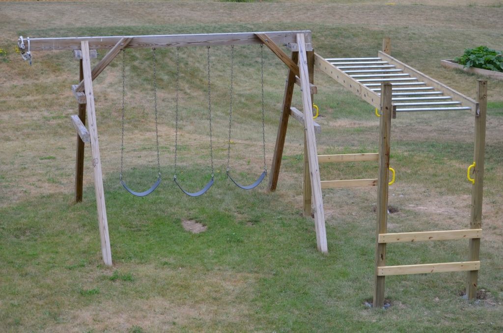

Got the set built this past weekend. I did set one post initially and then the next day hooked the monkey bars to that, and set another post that day (so that only one half of it was connected). The day after that I set the other two posts, and as I was connecting the ladder to the posts prior to concrete everything was nice and snug with no weirdness.
Construction consisted of 4X4 posts and then the ladder was 12' long 2X6" on either side with 1" galvanized steel in between them every foot. Had a guy at Lowes spend 15-20 minutes cutting my lengths from 10' sections.
The posts I set into a thin bed of gravel and prior to putting the concrete around them had drilled 1/4" holes through the bottom, through which I hammered a 60D galvanized nail, this way it's impossible for the post to move vertically independent of the concrete. This was possibly overkill but each of those nails was something like 16 cents
Materials and wood ran around $200.

Will be bolting the post next to the swing set into the swing set, which will end up giving both more stability.
I'll keep an eye on the wood. If I think there's too much splitting at the end where the ladder attaches to each post I'll screw some short 2X4 ledges to the posts, so that the ladder additionally rests on them.
The holes for the steel are offset from center by design. However, my original idea was to have the bolts (each one has a single bolt going through it from bottom--out of picture in this case) at the top so that there would be more wood "below" each hole. Then I thought I'd flip it so the top is smooth. Again, I'll keep an eye on wood splitting and if I think it's too much I will sister a 2X6 to each side, which will give it more strength and also cover the holes.
As it is right now though I can go across it without issue and I weigh the same as several small children

I do plan on cutting those carriage off. Had thought of cutting the top of posts and ends of ladder, but may keep them there as a little extra wood.
Through the bottom of each bar end, through the wood and then into the bar is a 1/4" hole, and I have a bolt terminating inside of the bar, within which it's secured with a nut. Was pleasantly surprised at how easily this steel is drillable.

Although I started this thread re. monkey bars, a few years prior I built the biggest baddest swing set in my neighborhood with a classical A-frame shape and heavy lumber. Kids still use it. It's awesome. I don't think you can go too tall. Basically, make a swing set an adult could use, and then just change the swing height over time.
That looks quite safe to me. The only thing worth noting is that even four 4X4 will move quite a bit that far off the ground--more than you might think. The one thing that should mitigate that is the piece in the middle, as I think if it's tight enough it may try to lift the side that is now pointing up, and so stiffen the entire thing. If you're willing to use concrete it's a much simpler setup than building a set out of a ton of lumber. Worse case you find it sways more than you want and you could put two diagonal braces in later on, also embedded in concrete, then you'll be good.
I'm happy to report no noticeable movement in the posts I put in back in 2012 even though last winter in particular was just hell on heaving in our area.
Not sure if I mentioned it above, but I kept the concrete a few inches from the top of the holes so that in the future when kids are grown I can just cut the wood off at the concrete line, soil over it, and grass will grow without ever removing the conrete.
