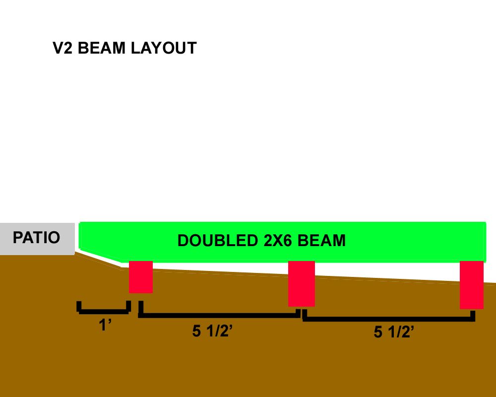

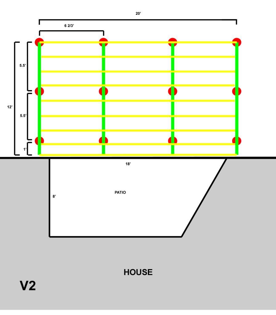

Ok thanks, I'm thinking about moving forward with a 12x20. I still need some assistance though. I think I have come up with a plan. I don't want to dig right next to my house cause the patio is only 4" thick or so. If I did once I get the 2x6 and 5/4 decking in there I'd have to dig down 3" below the slab, it would crumble soon after.
So now my plan is to cantilever the last 12" closest to the house. This will keep me from digging right next to the house.
Here is a few pictures, The first is an over all plan, the green are the beams which are doubled 2x6's. The yellow joists are 2x6's also, except for the one closest to the house, it will be a 2x4. The red are the footers, which will be 8" or 12" diameter 2' deep. The second is how I will notch the beam for the cantilever. Let me know what you guys think.

Why can't the footings closest to the patio support the patio & the deck? A 12'' diameter footing would be big enough.
Old 04-01-13, 05:09 PM
Join Date: Mar 2013
Posts: 81
I suppose it could, but I'd still rather not chance digging right there, plus I'd have to move a sprinkler line and 2 cable lines right next to the slab.
If I did will the 6' span on the footers still be ok?

Ok, if I do go with the cantilever, will my plan work? will the 12" be too much and make the deck spongy?

The 12" cantilever won't cause any problems. In fact, I like the idea of not fastening it to the slab, and keeping it free standing. You have good support elsewhere, so the short cantilever is not an issue. It also keeps you away from the edge of the slab and the possibility of degrading it's support. If you were to get too close, you would have to undermine the slab and pour additional footings both under the slab and the deck. Good call.

Around here anymore we use 2x10s for joist/beam and sometimes 2x12 for the beam. You are definitely within code there, but there is code then there is reality, and nobody likes a bouncy deck.
Make sure you run the design past your area inspector before you get going, or you could run into trouble later.

That's a lot of overkill on the posts so you can frame in with 2x6s. A deck is more aesthetically pleasing with wider framing. I would be using double 2x12s for the outer box and inside with 2x10s sitting on a ledger on 16"oc. I take it you want the decking running perpendicular to the house. That way you can eliminate many of them posts which what you have is overkill.
The footings instead of going with a round form I usually just free dig the hole and make a 16" ID box out of 2x4s or 2x6s. Below ground doesn't have to be pretty.
With a square design you can round over the edges and again it looks better and is stronger if you bump it with a mower.
I like using 6x6s for the post continuing up for your rail design.
Definitely screw your decking because the hot Florida sun will draw the nails back out. That's the purpose of the raised footings is all the rain you have down there. Setting the posts in the ground just invites rot.
Cantilever is okay if you chose. You can cantilever 1/2 of what's behind it. So if you have 65" behind it you can cantilever 32 1/2" if you chose.
You can dog ear the four corners to eliminate any shifting.
I really need a picture of the house and what siding you have. Stucco? Is any part of the porch at ground level?
I'm not sure of your diagram but framing resting on framing looks cheesy to me.

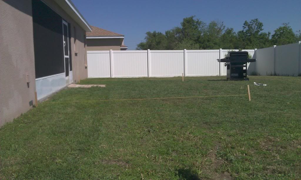

Ok I laid out and remeasured. at the house I have 3.5" to the grass, and 12' out I have about 6" to the grass. So assuming I dig down another 1.5" I'll have 5" at the house and 7.5" at the end. I'll be digging everything 2 feet wider and putting mulch down around the deck instead of letting the grass grow up to it. So here it is, will it work? I dug a small hole to check the patio slab, it's 4.5" thick.
Think I will have any water issues? I was thinking of doing a french drain under it just for added insurance? Thoughts? Here's what the back yard looks like.

Based on the recent photo, it appears close to the bottom half of all beams and joists will be below top-of-ground elevation. To avoid that, you'll either have to raise the deck (and step up onto it coming out the door), or excavate a very huge hole in an effort to keep the wood from being buried. Wood floats, so there's a chance parts of the deck will be subject to uplift forces when the hole fills with water.
Believe it or not, but we're trying to keep you from making a big mistake. For your situation, a concrete patio is the practical way to go. Do it yourself for less than $500 in material costs (concrete, mesh and curing compound).
