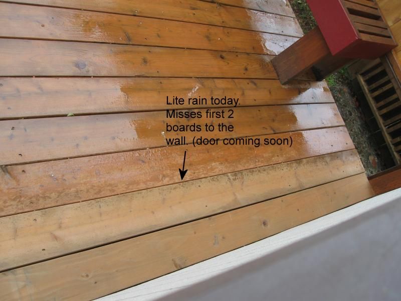

Hello, I am having a master bedroom window changed out to a Andersen sliding glass patio door. My contractor went ahead and built the deck out the proposed door while waiting for the patio gliding door to come in. He built the outside decking exactly equal to the interior floor. I wanted at least a 1-1/2 inch step down like other doors in my house. We haven't opened up the wall as yet. It may be even a touch higher than the interior floor?? He said he would frame it as such and caulk the heck out of the bottom of the door jam so no water will come back into the house. Will this be enough to keep water out? He had an existing 'show and tell' deck door 10' away with the 1-1/2 step-down but built this new deck higher?? Will there be future trouble having both floors the same height? I live in a very snowy area of the USA. This is a single story home and the orignal deck off my main living room doors is about 26" off the ground. It is block foundation. Could it be the contractor did not want to fight the concrete block with his lags when placing his ledger board? I doubt this since he had hydraulics. Everything put in with hydraulic guns. He used a heavy duty nail gun to secure the header and then he used a hydraulic drill gun to put his 1/2"x 6" lag bolts in to the header. He put the ledger header board into the wood. Should I have him lower the deck?

In areas of significant winter weather, it is recommended that the deck be 6" below the threshold of the door. At 26" why didn't he build it free standing? Holes in your house can equate to leaks later on.

Your right to be very concerned.
It's not even code any more to build a deck that high and will 100 % of the time cause moisture issues.
Hydraulic Gun's? Guess you mean hammer drills.
I 100% agree, this should have been free standing and at least 6" below the threshold.

I would have booted him off the job if I saw a single nail in a deck board.
ACQ approved screws only on my job sites.
Caulking is a last line of defense a should never be counted on. It will fail at some point.
Proper flashing and or a sill pan and building that deck below that threshold would be the right way. Not some hacked up blobs of caulking.
Jamsill Guard Door & Window Sill Pan Flashing

Here are some pics. The new door is here and he will place it on Tuesday. No way to dismantle this and take it down being nailed and all? He said he always builds his decks even to the interior sub floor. Had I known he was going to use pier blocks, I would have waited to build deck after door. I, at least, wanted to get the foundation(sona tubes but he used pier blocks) in before ground freezes. If the deck level is, at all, higher than the subfloor by the smallest enth, I will refuse to pay him. If you notice, we had to put a board, 2x8, under the stair risers. If he had brought his level down 1-1/2", we wouldn't have had to give more height on the riser. What a mess. I don't know what else to do? I almost didn't have him back for the door install but I wanted him to see it is off when we opens up the wall. I didn't want another contractor to half come up on this and the height difference, so I kept him around. I used the old stairs on the new deck. The old stairs were where the juniper tree in the pot is now.
Plus I built the extra landing at the bottom. The step-down from last stair was not natural so I built that landing. Everything off because of his miss.

No, no, the deck to the left in pic is new. That was all lawn and bushes under window in picture. He built that new. No other deck under there.
The 'existing deck' darker color in right of photo is the deck I personelly built myself about 15 years ago. They are two individual structures. There is a 1/2" clearance between the two decks(I said 1" above). I did not want more weight on the existing deck. I wanted each to carry themselves. So they are not touching. He said he would lay a slanted coupler there to meet the two up so no trip factor.
Not part of my problem but....
I used sona tubes (3) on the existing deck to right in photo. That deck is 16' wide x 20' long down the wall by main door. (2) sona tubes on each end settled more than an inch. I re-leveled the existing deck this year. I used a car jack and put spacers where needed.
He said that(in our many conversations) that his measurements are true. Right where they need to be.
I took a photo this morning. It is lite rain today. There is a 1-1/2 foot overhang on the main house. And the rain fall misses the first 2 boards touching the house(Amen!) For normal everyday weather here, neither rain nor snow will come right up to the door. But sometimes we have hortizontal rain and snow and it will make it to the door(wall).
I have already paid him for the deck. It's been complete for about 2 weeks.
He will be here to be the door early next week.
Problem
He nailed the deck boards down but I made him leave the first board to the wall lose. I can lift that board and take it away. I thought he would be high and when he cuts the T1-11 down the wall, cut right into the first deck board. At least, I thought that far ahead. I can 'screw' that down when finished. Through this week, I lifted that first board and tried to pound on the hangers and joist, hoping maybe I could get a small amount more depth. No way, solid as should be! When I think of more I will post.

I often see contributors to this forum suggesting that decks need to be 6" below, sometimes even suggesting that this is now code. There may be a city or state code somewhere that I'm not aware of, and I don't dispute that when a deck is at the exact same grade as the interior floor, that it could possibly increase the chances that the door could leak as a result. There are certainly benefits of having the deck be 6" below the finished interior floor level.
However, I know of no code anywhere that specifically says that decks cannot be at the same grade as an interior floor, period.
If you'd like an authoritative source, check out: http://www.awc.org/publications/dca/dca6/dca6-09.pdf
Their very first illustration shows a deck very much like your own, built at the exact level of the interior floor. Also, see figure 14 and figure C19, which show "code" for proper detailing of ledger attachment. Note that the top of the flooring is level with the interior subfloor. When it's done correctly, there will never be a problem with this type of installation.
Not everyone wants to step down 6" when they open their door. If the deck is level and the door leaks, its usually the fault of the door installation or the deck flashing, or both.

I agree with Brant, in that I have never heard of a "code" issue with the placement of decks in relation to door openings. Common sense, however, will take over in heavily snowed in areas. Our daughter's patio is poured about a full step (7 1/2") down from the door, but that's in Denver. Here, we always give a couple of inches, but never enough to become a trip factor. Move a ledger down too much and you will lose the rim joist of the house should you be attaching it to the house.

I think I should go forward with the door. I don't even like the fact that it will be level with the sub-floor(doubtful) but I have to accept that. My only hope is that a future roof line will keep the snow a good distance from the door. Once door is in, I can watch it for leaks. If all else fails and I get water in my house, I will take and disassemble the new deck with a sledge hammer board by board and have it lowered by at least a couple of inches. He nailed each joist hanger on both sides too(each joist hanger has side nail holes). Not sure what else to do. I want to post about the installation of the door on another post. I am really running out of time here. I've got to stain the new trim before it goes up. It will be much easier that way instead of staining it when up on the inside wall.
Do you think I could have him cut a quarter inch off (long ways) of the lose board (at the wall) so that water finds THAT opening before that reaches the house? I know the ledger will take the water punishment and not the threshold and eventually the sub-floor. Just a thought.

Nope. Let it ride. Let the door be installed. Make sure he silicones the heck out of the bottom and up the sides a few inches before he sets the door in place. THIS will be more of a barrier for you, as XSleeper mentioned.
Well, thankfully he nailed the joist hangers properly. They put a dozen holes in each hanger for a reason.....fill 'em with nails.

Maybe it's just my tired, old eyes, but I don't see any ledger flashing in your first photo of today's posting. Also, it appears the ledger was installed butting up to and on top of the house's T-111 siding. Not a good idea, and not in compliance with the IRC DCA-6, either, if the T-111 is considered siding when there isn't any sheathing under it.
Also, simple arithmetic tells me the new deck will be 1" higher than the interior floor. That's the difference between your old deck's 1-1/2" drop and the new deck's 2-1/2" rise above the old deck. Not a good situation, regardless of how many tubes of caulking and silicone are applied--water and melting snow like to run downhill. You will have long-term performance problems.
