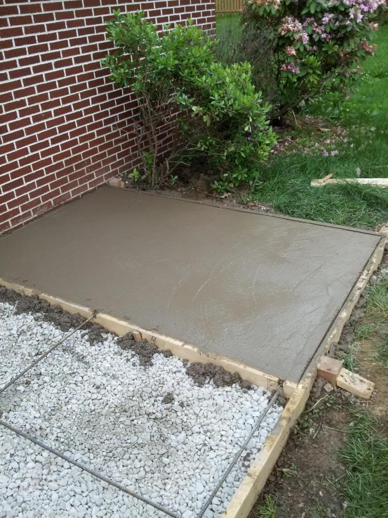

Poured one half of the slab last night and it actually came out decent. It really wasn't as hard as I thought it was going to be, once I caught the drift of how much concrete to place before screening it went smoothly. So far I have done this entire project myself, and with the help of a new holland sub compact tractor. I am glad I went this route instead of redoing the deck, the deck would have definatly been more of a headache then the concrete.

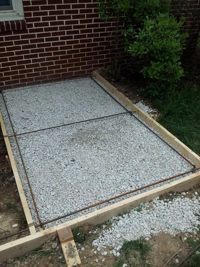

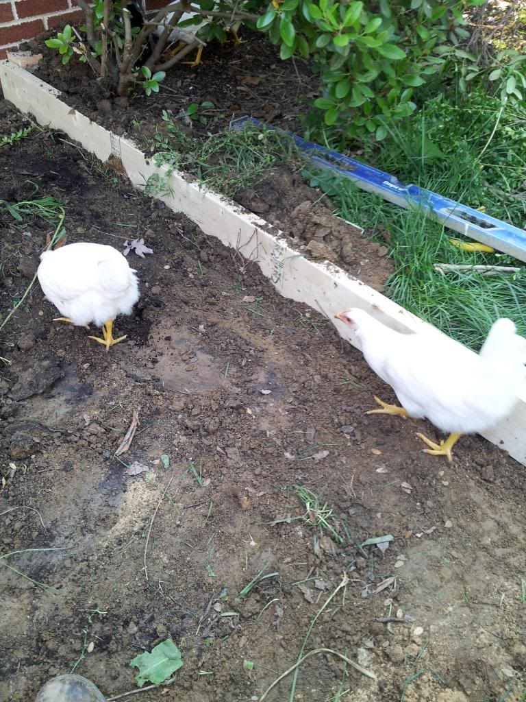

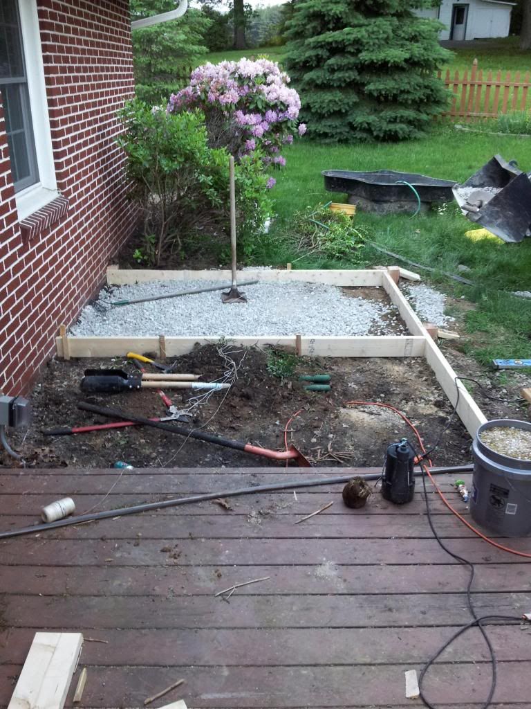

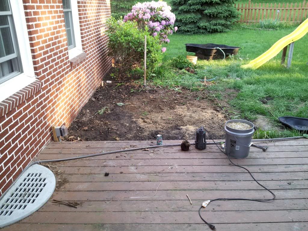

I do have pictures.
Started with this. There was a pond, and two shrubs here that I had removed.
Built the forms and finished excavating. The chickens were helping me out.
Picture of the forms, started adding stone and tamping.
Stone finished on one side and added the rebar. I actually put another center piece in on both sides, I had leftover so I figured why not.
Here it is all finished up!
I'm lucky to have access to a tractor, its my parents, but they let me borrow it. They also have a business that has an enclosed building with garage door and a forklift, so I was able to take my whole skid of quikrete off and store there without breaking a sweat. I also have connections with a excavator so I got my stone for free
You should have rented or borrowed a bull float, so you wouldn't be left with all of the hand float indentations in the concrete finish. You also should have used some additional rebar midway between those shown in the photo, along with some dobies. Also, I hope you used an expansion joint filler between the house brick and the slab--couldn't tell if it's there in the photo. If you forgot it, don't be surprised to see some edge spalling there after the first winter, when the slab heaves but the house doesn't.

I agree about the float, all the reading I did said it could done be with a hand float, but after I see how it is now I wish I had done different, but it will be covered up so its not that big of a deal. I added more rebar and if by dobies you mean rebar supports like I have around the edges, I added a couple more of them in the middle.
I didn't add an expansion joint, all the reading I did, I didn't come across the use of an expansion joint at all, so I guess I will have some cracking there.
