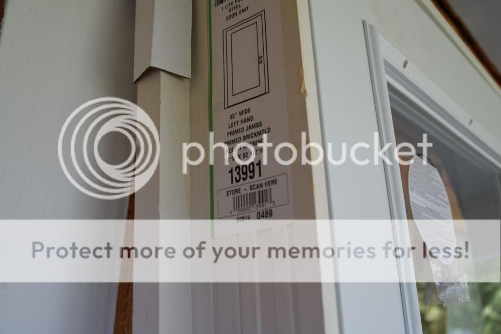

Entry Door: I'm not sure how I should measure the studs for my prehung entry door. Here are the measurements that came on the side of the door. Should I use the rough opening measurements or actual opening measurements? I assume the measurements are for the door frame that the door came prehung on, and not the actual door itself correct? Here's the specifications on the door I got at lowes...
Glass Style Clear
Glass Caming No
Glass Insert Shape/Style Full lite
Brickmould Yes
Door Swing Inswing
Masonry Opening Height (Inches) 82.25
Masonry Opening Width (Inches) 34.5
Lockset Bore Yes
Collection Name N/A
Prefinished No
Primed Yes
Paintable Yes
Caming Option N/A
Construction Insulating core
Glass Insulation Dual-pane insulated glass
Lockset Option Ready for lockset and deadbolt
Look and feel of real woodgrain No
Fire Resistant No
Lowe's Exclusive No
Blinds Between the Glass No
Prefinish Color None
Optional Additions Available Sidelites
Sidelite Width (Inches) 0.0
Transom Shape None
Door Style Full lite
ENERGY STAR Qualified Northern Zone No
ENERGY STAR Qualified North/Central Zone No
ENERGY STAR Qualified South/Central Zone No
ENERGY STAR Qualified Southern Zone No
Iris Technology No
Door Handing Left
Rot-Resistant Frame No
Slab or Prehung Prehung
Hinge Finish Polished brass
Common Height (Inches) 80.0
Common Jamb Width (Inches) 4.563
Common Width (Inches) 32.0
Height (Actual) (Inches) 81.75
Jamb Width (Actual) (Inches) 4.563
Width (Actual) (Inches) 33.5

Use the measurements posted by the door manufacturer. I wouldn't drive 3,000 lbs over a septic tank. The building dept may have plans as to where it is, if the house isn't that old. If not, the top of the tank should be high enough to find it with a probe. How you correct the pitch depends on a lot of things. Some pic might help.

Framing
These are the dimensions for the framed rough opening.
