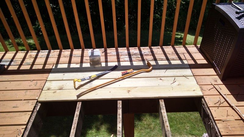

When we remove the decking boards, the nails don't come out with the boards. Can I just bend them over the side with a hammer instead of removing each one?

That depends on what you want to do. If you are dismantling the deck then there is no need to remove them. If you are going to install new deck boards I would pull the nails so your new boards can rest flat on the joists. Even hammering nails over some bit of them usually ends up sticking above the wood.

there are several rows of deck boards, each replaced at different times for some reason. This row was in poor condition so we are replacing it. My friend is taking up the old boards, which crumble as they are pried up, leaving the nails behind. I try to remove them but they are very difficult to remove.

Claws on a hammer are there for convenience, and are not necessarily the best choice when pulling nails is the primary task. Stop by your local hardware or big box and ask them to point you toward flat bars. They have a long and a short leg, each with a slot to pull nails. Once you have that in hand, you may find that a short piece of the scrap wood makes a good fulcrum to place under the bar and increase your leverage.

I keep two different pry bars in my truck at all times. A flat pry bar and a larger wrecking bar. Both are much better at pulling nails than the claw on a hammer.
Are the boards you're putting down pressure treated? Those boards look awfully white. They should be pressure treaded and they will require special fasteners not just plain uncoated nails. The modern preservative is corrosive to unprotected steel so there are screws specially coated for use with pressure treated lumber.

.... and when a flat bar or nail puller doesn't work, clamping on to the nail with a vise grip and then using a block of wood for leverage works well. I'd cut the nails as the last resort.

I am off to lowes to find a flat pry bar and a larger wrecking bar, which looks like it may make this nail removal a lot easier as well as prying up the other boards. Yes, they said these boards are pressure treated. They have been sitting on my deck for a week, hoping they will dry out a little.

Yes, I have goggles to use, thank you for mentioning it though. ok here is my new (heavy) pry bar and 21" wonder bar. Between the 2 of them I am able to remove every nail without any trouble at all.
