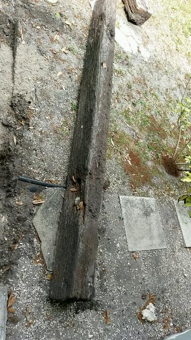

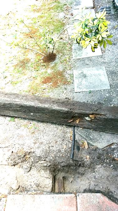

I have some 8"X8"X8' railroad ties that were used as borders to patio stones in the back yard. They were there when I bought the house in 2011 and now are badly rotted. Some of them are hollowed and I saw lizards and squirrels go in and out of them.
So I finally took them out and I need to get rid of them.
The city told me if I cut them into manageable sizes (say 3-4' lengths) they can pick them up on bulk trash collection day. I need to cut them up anyways so I can bring them from the back yard to the front yard.
These have been half buried in dirt for years. There are roots and dirt/sand inside of them.
I tried a recprocating saw with a fresh pruning blade on one and it cuts about 1/2 inch thick in a minute. At that rate it will take 15+ minutes to make one cut. Too slow.
What is the best tool to make these cuts?
A circular saw rotating the log making 4 cuts one on each face?
A chainsaw?

From the pics they're 8" landscaping ties, not actual 7" x 9" x 8' RR ties (which would be "juicer" and would not have rotted at the center).
