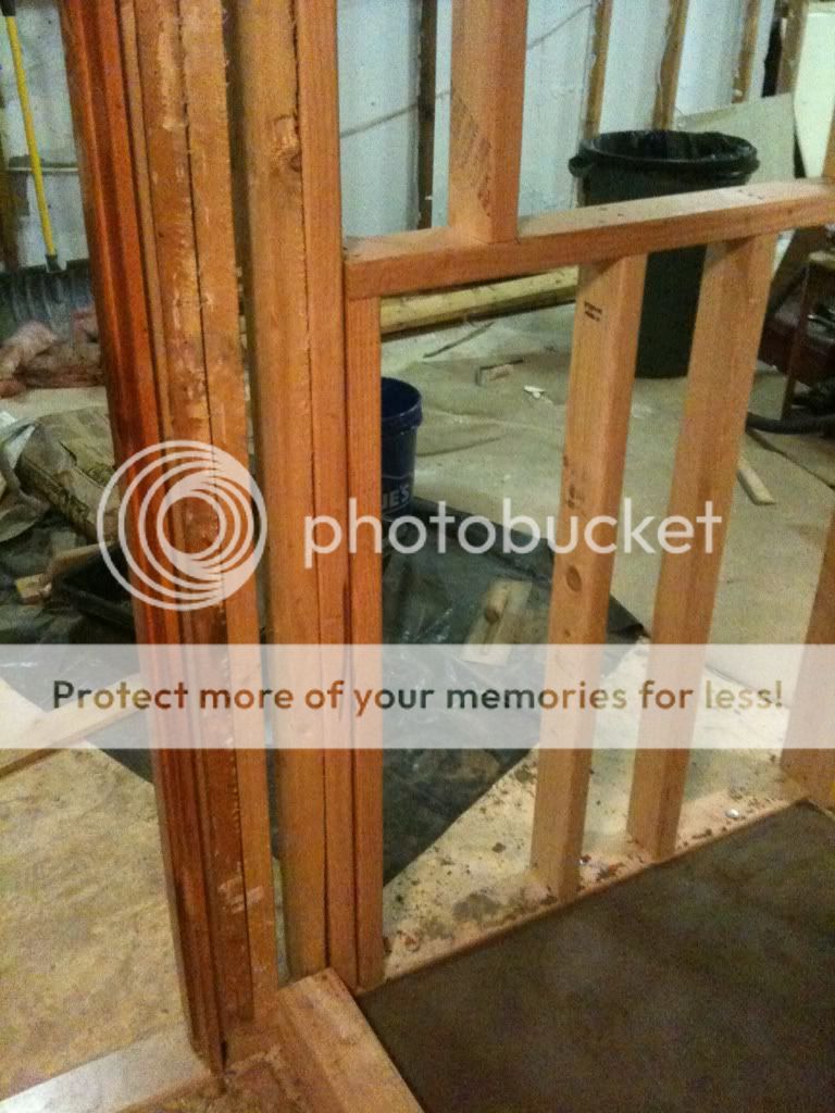

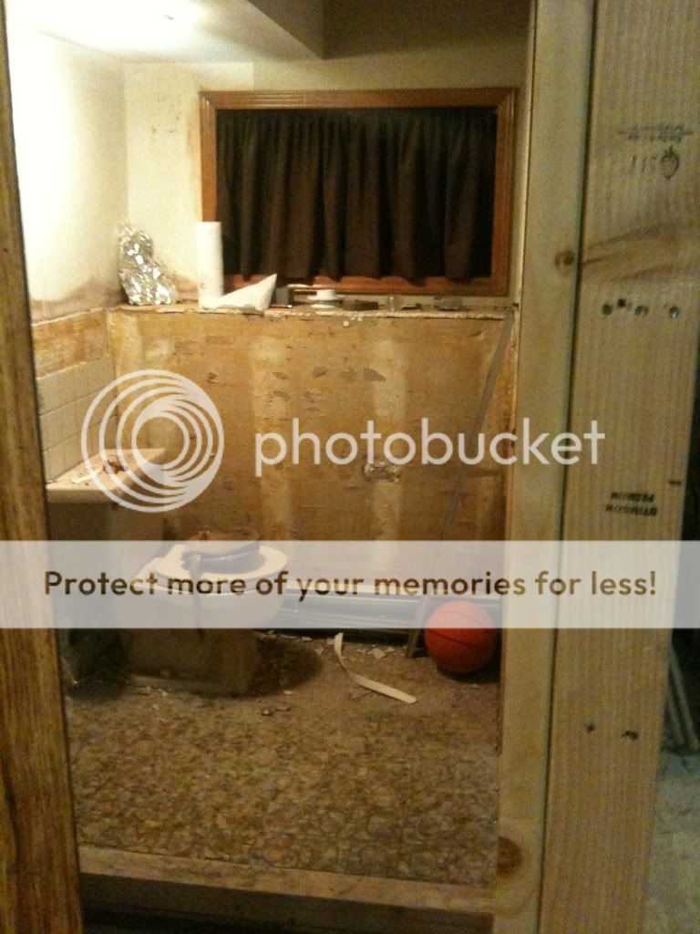

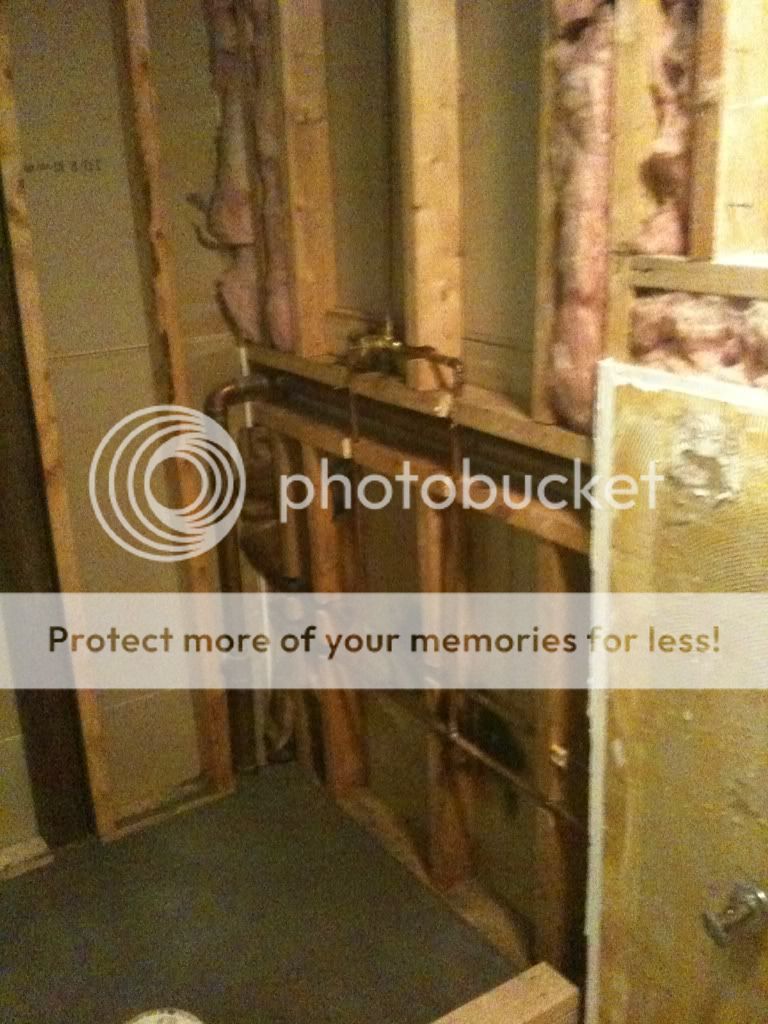

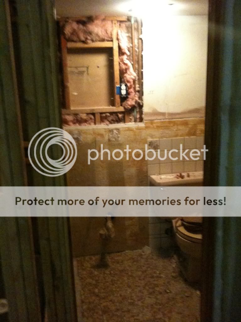

<a href="http://s385.photobucket.com/albums/oo294/tonylongdong/?action=view&current=897F3FBB-AF28-4193-BAF6-1849BE79B902-694-000000B6BA5D5CF5.jpg" target="_blank"><img src="http://i385.photobucket.com/albums/oo294/tonylongdong/897F3FBB-AF28-4193-BAF6-1849BE79B902-694-000000B6BA5D5CF5.jpg" border="0" alt="Photobucket Pictures, Images and Photos" /></a>
Old 12-20-12, 06:02 PM
Join Date: Nov 2012
Posts: 187
Ok so those are pics of where the curb meets the studs from the curb to the ceiling. I also put a pic looking into the bathroom from the door and from the shower looking into the bath room.

Cut the triple stud out and slide it over to close the gap, you need good wood right where the gap is. It might not be such a bad idea to build a 1/2 wall on the service end of the shower as you will have a vanity that butts into it. This is going to limit the size of the door, but you can install glass above it. The door only really needs to be big enough to enter and exit. Also take into consideration that the door needs to be orientated so that water splashing from the shower head can be directed back into the pan for exit to the drain. Lastly, consider the bathroom door and how it will be orientated in relation to the shower. It's pretty close to where the shower is, would not want any broken glass should the door be swung open and the knob hit the glass.

It looks like the triple stud is just toe nailed in at the top. Use a pry bar to remove the nails and you should be able to knock the top free and pivot it down to release the bottom nails. If the studs are nailed together pry them apart enough to get a reciprocating saw in to cut the nails. You want beef behind the door hinge and chances are that if you slide a 1/2" filler in, the screws will the seam between them and not give great support.

Building a small return will complicate the tile installation IMO. A short 4 to 6 inch wall will cause a lot work using bullnose tile to wrap around. It is easier to move the 2 studs over to close the gap.
