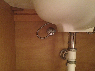

Thanks so much for the advice. Here are some pictures of what I'm dealing with. I'm a beginner at this if you can't already tell so here are a couple of my beginner questions. I know to unscrew the vanity and turn the water off, but how do I get the back piece of the vanity off when there is that silver cover around the water shut off valve? Does that make sense? It looks like you have to cut out a big hole in the back to get the back piece out. Also I think the flour was tilled after the vanity was put in so I think there might be grout up against the wood. I'm guessing I chisel that out if that's the case, but would there be anything else holding the vanity down from the bottom?

That is definitely a factory-built cabinet. You will need to remove the top (it is likely glued on with a silicone adhesive) and remove all the plumbing. As Joe stated, there should be several screws holding it against the wall that will need to be removed.
The main water valve for the house will need to be closed and the pressure relieved before you remove the shut-off valves. The escutcheons between the valves and the wall may be the hinged variety that can be removed easily or they may be the one-piece kind.
If the latter you will need to get a "ferrule puller" from a good hardware store or a plumbing supply to remove the ferrules on the water supply piping and then remove the nuts and escutcheons. The drain pipe will have a trap adapter that will need to be removed.
I suggest that you go to your local library and check out several DIY-type books on plumbing and bathroom remodeling. Yours is certainly a DIY task but it IS a fairly large one.

1-Take down the mirror and the channel the mirror sat in on top of the backsplash
2-Disconnect all plumbing underneath the sink. Shut off water at the valves and remove supply lines. Disconnect the drain from the sink tail at the trap
3-Remove the left wall backsplash. It is glued to the wall and probably caulked in place.
4-Cut the caulk from the main backsplash and see if you can lift the top off. If not, if is glued in place and you need to run a putty knife between the top and the cabinet.
Top should be off.
5. Remove all doors and drawers to lighten the load.
6. Remove the base molding and door casing
7. Remove the handles to the supply lines and cut off the escusions. You may need to enlarge the hole in the back cabinet slightly, but hold for now
8. Remove the fill piece located against the left wall by unscrewing fastners located on the left door hinge side of the face of the cabinet.
9. Remove any screws holding the cabinet tight to the wall
10 Lift and wiggle to see if you can clear the tile floor
Let us know when you get this far.

Thanks guys so much for the help. I was able to get everything out. See the picture below. I got the vanity out without any damage so I can reuse it and we ended up smashing the tub into a billion pieces and that was the easiest way to get it out. All in all it went mostly well.
One more question now that it's out. I turned off the water to the house, disconnected all the plumbing for the sinks but had to cut the little silver disk that cover the hole where the pipes come through the vanity. The reason I had to cut them and not slide them off was because there's a little ridge on the pipe that holds the nut that screws the water shut off valves on so I couldn't slide the nut or those silver disk off the pipe.
My question is, is do I need to replace those and if so how? The only way I can think to do is is if I cut the pipe so that I can slide everything on and off, but I don't want to do that.
Thanks so much for the help.

Escutcheons
Escutcheons, hole covers, smitty plates, shower arm wall plates
The two-piece one should work.
