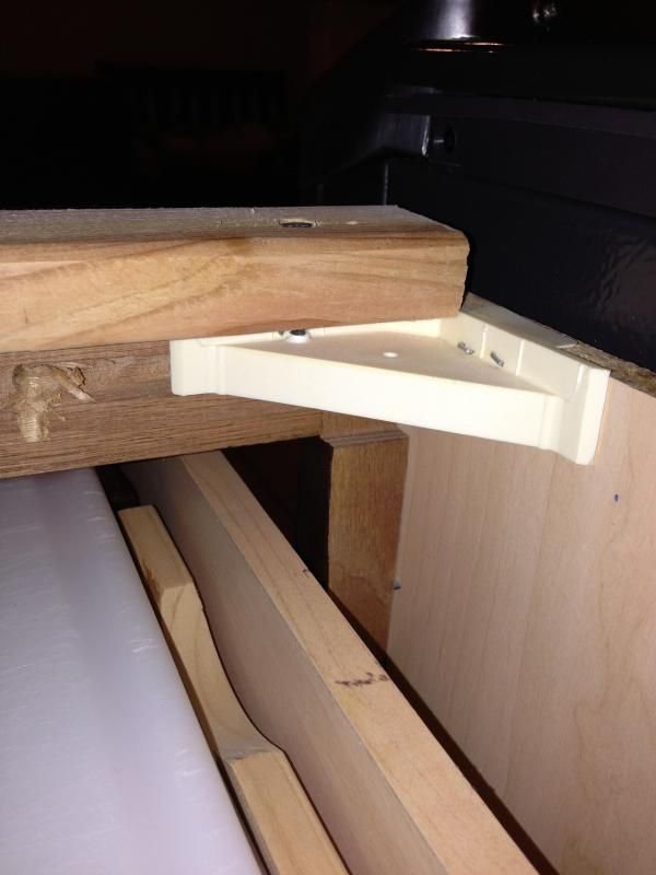

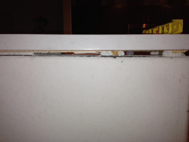

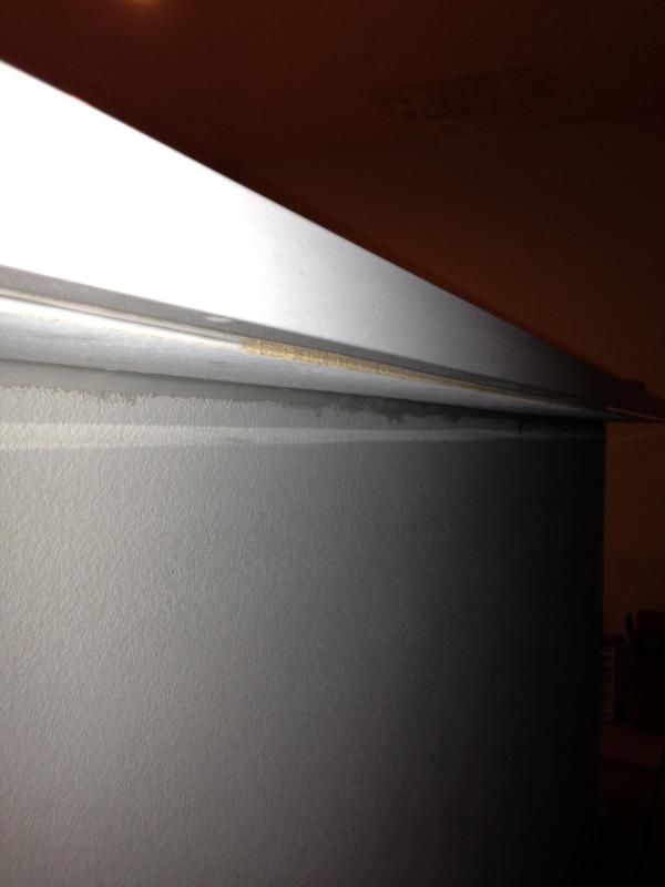

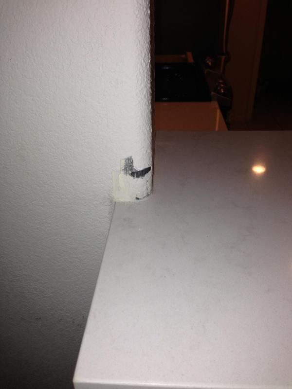

The installation of my new counter tops looks unfinished and horrible. I was curious if this was typical? I will let the pics speak for themselves.
Damage to bullnose
Wood underneath bar top is not flush with the edge
Poplar screwed into a plastic square that's stapled into the cabinets

She didn't have your back, but she eventually will once you get their corporate headquarters involved. Judging from your pictures, the installation was crap. Why was the 2x lumber used? Certainly not to level the countertop. No intermediate support. The plastic triangle is where your original countertop was fastened from the factory. They didn't leave the sub top looking like the top picture, did they?

In part, the gap shown in the top pic was caused when they leveled the top. It's normal to have to caulk under the top to make the gap disappear but that's too much gap for caulking. Normally wood trim is used to hide the wider gaps but the bullnose on the drywall would complicate that.
Are they responsible for the drywall repairs or did you sign a waiver releasing them from any damage caused by the installation?
