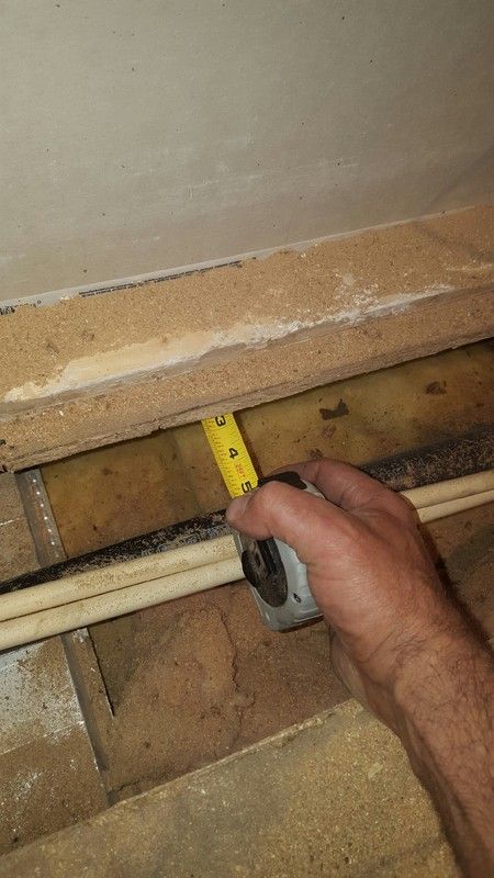

My first question is about order of work.
Obviously teardown to studs is first, then mildew removal/abatement is next. But then should I set the tub or start on floor or sheetrock?
What's there now for a subfloor?
Most older mobile homes used partical board.
That would all need to come out down to the joist.

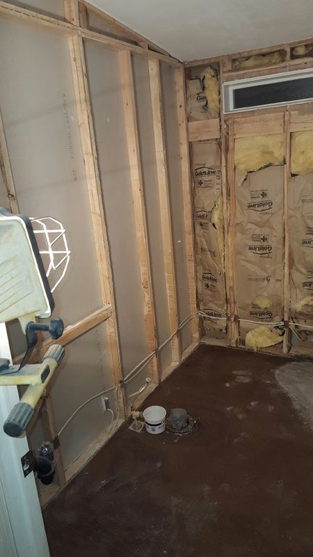

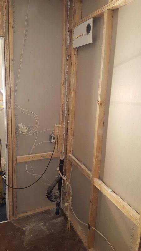

The floor is particle board. I think the joist are 2x8s. I really was wanting to do this without changing the floor, but it is looking like it is going to have to be changed. But what do I replace it with?
Here's the pics.
I didn't get the faucet removed yet because I have to figure out exactly what kind of pipe I have. Then I can get some valves or caps for it while I work on everything up to that point.

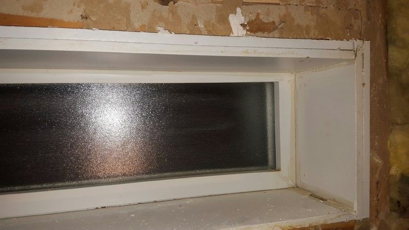

This is the window surround. It is plastic laminated on particle board. What do I use to replace it? The window is screwed in from the outside on the siding. The particle board has a few small nails in it from the looks of it. I am pretty sure if I cut the silicone carefully I can get the surround out.

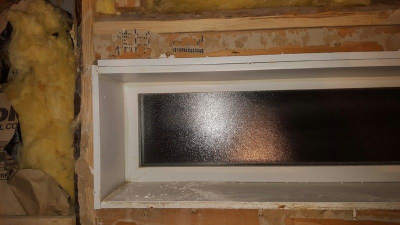

This window case needs replaced.
The window is attached on the outside of the house to the paneling. I am thinking I can remove the case from the inside without messing up the window itself. I will carefully cut the silicone and try to get the small nails removed.
Because it is just plastic laminated pressboard I am not sure what to replace it with?? Any suggestions.

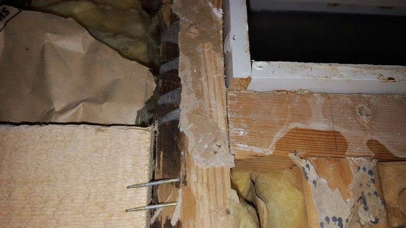

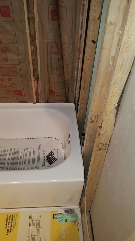

The floor joists are 2x6 or maybe more accurately 2ish x 5 1/4", typical trailer crap.
The floor is particle board. What do I replace it with? What do I do at the edges because the walls are on the joists?
I have been thinking how to do it and the best I can come up with is Nail or screw a 2x4 along the current joists to get it where I can put my floor on it. Then on the ends of the floor put the 2x4s between the joists.
I sprayed everywhere I could last night with some mold killer. I will spray again later today with bleach/water to kill everything, after I get the tub faucet removed. Do I need to paint over it to seal it? Suggestions?

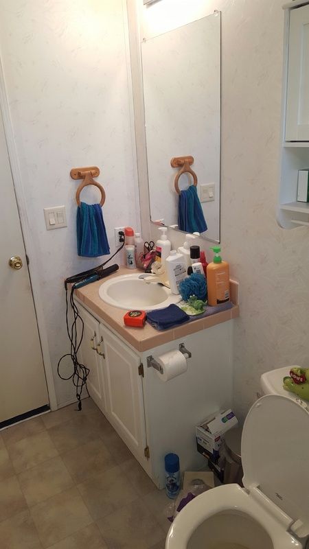

And a before pic I tried posting earlier but it didn't work.

Most MHs use 5/8" PB. I'd cut out what PB I could and replace it with 5/8" plywood and then add another layer of plywood over it all to get the stiffness you'll need for the tile. I don't think the 2x6 joist will be too big of deal since they are supported by the MH's steel frame. You do want to make sure the outside edge of the floor is good and stout!

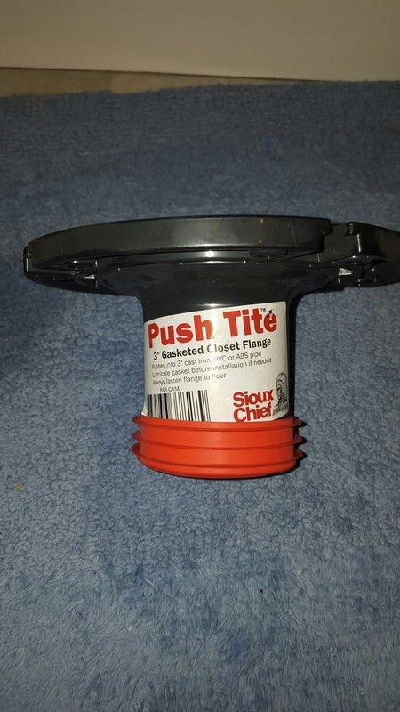

I just got back from the store with the proper fitting to change the cpcv to regular pipe thread. They all get capped for the time being.
Since the floor is coming up a couple layers and that depth hasn't been exactly determined What is the best thing to do with the toilet flange? Where does it end up? at top of floor tile level? or top of subfloor?

Cement board doesn't add any strength to the floor - it's just for the tile to bond to. Normally 2 layers of plywood are used to make the floor rigid and then the cement board goes on top of that. I put the top of the commode flange on top of the cement board .... but I'm a painter - the pros may do it different.

You can not self level direct to wood, you need to add lath to give the leveling compound something to grab.
I would replace the floor with a single layer of 3/4" Avantech subfloor material and then go over that with a product like Ditra-Heat which is basically designed for exactly what you have here.

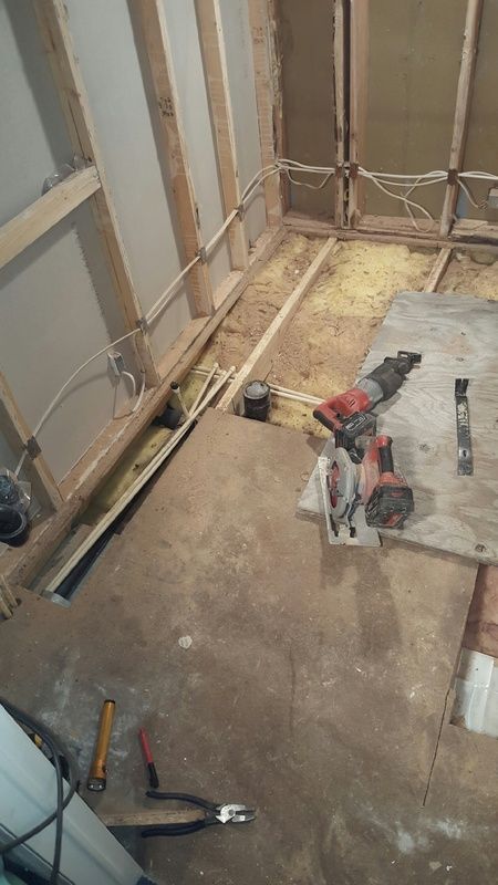

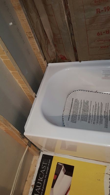

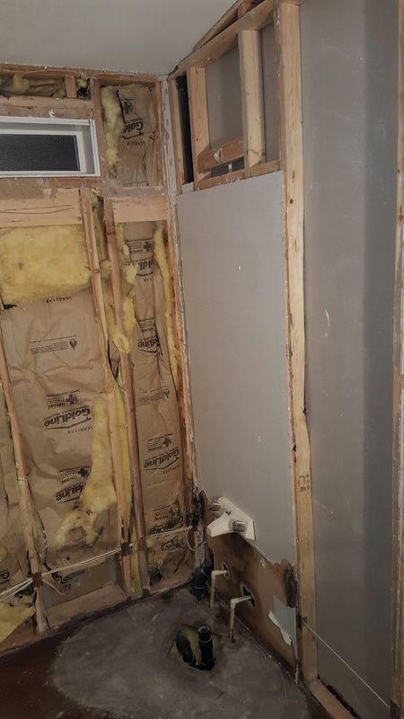

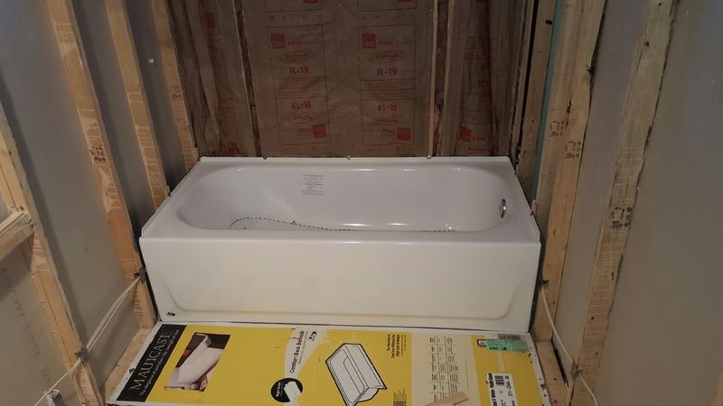

homedepot.com lied. My local store had 5/8". I bought enough for 2 layers. Then today I got roped into helping a buddy and didn't get much of anything done.
Pics of where it is now.
I had really big plans last night. Then realized the particle board is glued like a mofo to the Joists. Each one is scraped/chipped off by hand with a wood chisel.
I anticipate the floor to be higher when done but oh well. I am thinking 5/8" plus 1/4" self leveling cement plus tile which I think will be about 1/2". But no real other way to do it.

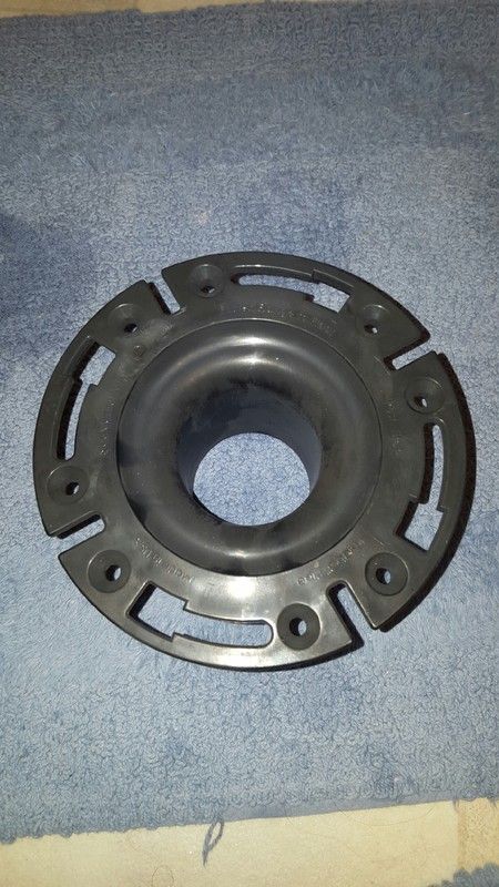

I was stressing how I was going to redo the flange. Then I found this.
Now I can just jam this thing down in the pipe at any level and set it where I want. I never knew such a thing existed but found it while looking at the flanges for options.
Mark, I also found out why you said put the flange on top of cement board not tile height. There are several options for seal rings. I haven't ever used anything but wax until looking at the store last night. Some of the rings also have spacers to get more height to seal.

I make it easy on myself when doing a bathroom floor and go under the floor and cut off the tail pipe so I can pull the whole flange out.
Just use a Fernco to reconnect after the floors done.
To remove that glued down subfloor I make cuts along side of the joist to remove most of it and use a sawsall to trim off what's left on top of the joist.
A Toe Kick saw makes quick work of cutting along the outside walls, using a sawsall with a short, wide, course toothed blade held at a steep angle, or an ossilating saw to cut the inside corners.
I was going to try to use the couplers for the sewer pipe until I found the one that just slides down the inside. One thing that was giving me fits is the flange was directly on a sweep tee, but the new flange eliminates that issue. I was kinda thinking the couplers were a hack job/jerry rig fix, but what do I know?? That's why I'm here for help.
My sawzall skill level doesn't allow me to trim the top of the joists with is. I'm trimming close to them, then using a sawzall scraper to get most of the PB off. Then chisel the wood glue.
Does everybody have a favorite kind of glue to put this all together with??
#26
To add quote bubbles, click on the quote icon on the task bar (furthest icon on the right). It will open up a pair of quote words. Copy/Paste your quote between the two words
#27
I think you will need to cut your floor closer to the wall and then add blocking that goes from the next joist to the one visible in the room. Toenail 16d nails to make as strong as possible if you have an air nail gun. If not, 3" deck screws toenailed into the blind joists and you can shoot directly through the visible joists. You will have to contort yourself at odd angles but is needed for the stiffest floor possible for tile.
To glue your ply to the joists, use Liquid Nails for Subfloor (all liquid nails are not alike. must say subfloor on it).
Question weather the new flange will work if your pipe immediately turns upon entering the floor. How far above the particle board is the flange now?

Here is my project. Tub finally set.
As you can see the tub is about 1/4" to 3/8" from the side walls. I had to put shims in to not bend the tub or pull the wall studs out closer to the tub. Does the backer board stop at the edge of the tub or does it go down over the flange? From the diagram at the top it looks like it stops at the tub. Then how does the waterproofer work to keep water from running down the concrete board and the ouside of the tub? Just the bead of silicone between the cement board and the tile flange?
I copied this picture from here.

And another question:
What kind of material should I use to rebuild the window case? I asked earlier in the thread with no response. Is regular 1x4 sufficient? Just primered and painted? Certain wood that is more moisture friendly considering it is above a shower?
#32
Shingle down the wall some 15# felt paper overlapping both each sheet and also in each corner. Cut the felt paper about 8" longer than the tub and wrap 4" past each corner. Do the same for the ends of the tub and overlap the backwall as well. Leave the felt paper long so it hangs into the tub. Then put up your cement board setting in on the flange as in the diagram. Trim off the felt paper after the fact so water will sheet into the tub and not the wall.
Look into expanded PVC trim boards for the window. Looks and works the same as lumber yet will never rot out on you. Make sure you have a positive slope toward the tub so water will drain off the sill.
One thing is is the felt paper sticks out the bottom of the cement board would't it get sealed in when you put the bead of silicone around from the tub to the cement board? Then any water behind the board but in front of the felt would have nowhere to go? Am I missing something?
Most of the videos they used Hydrobarrier to waterproof the cement board but of course it is not locally available. So I think I am going with Hardiebacker and sealed with Redgard.
Of course the only PVC trim boards wide enough have a rough wood texture to them.
#34
In a properly constructed tub/shower tile job, it doesn't matter about the felt paper. I have never put a bead of caulk between the tub and the cement board. In between the studs, you have nothing but a big crack and air behind it. You are not sealing anything. And if water gets to the back side of the cement board, then it will be directed back into the wall cavity. So the thinking is somewhat backwards. I have only recently started adding redgard to the mix as a feel good for the customers like yourself that spend all day watching videos. Key point here is that when the wall is constructed, the tile is up, in the corners, that you do not grout that inside corner, instead you use a flexible color matching caulk to seal. 80% of water issues are that the inside corners are grouted and the grout cracks. The other 20% are doors not sealed, silly weep holes installed, splash past curtains and not properly prepared pan liners on curbs. I just repaired a beautiful shower that had water damage because water got past the tile on a half wall in the shower. The half wall was capped with regular bullnose tile. Once inside, the water expanded the framing, which further cracked the grout, which opened up letting more water into the framing. It festered because the customer was told that that was how tile walls usually look (with cracked grout). Only reason I was aware of it is that I asked if there was anything else that needed attention after I installed a door for them.
Call around to lumber yards and inquire about expanded PVC boards. The ones I use are textured on one side, smooth on the other. I have also found ones that are smooth on both sides.
