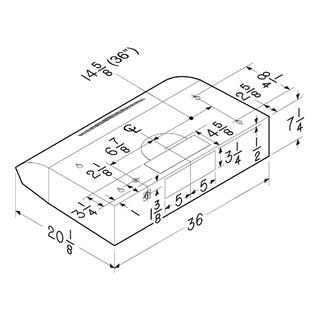

The diagram I found online seems to show a rectangular duct, convertible to exhaust out the top or back. Yours has a 7" round collar (with damper)?

Most hoods come with a choice for using either round or rectangular duct size.
From Broan....
Choice of 3-1/4" x 10” rectangular or 7" round ducting ensures reliable discharge without re-positioning the blower.

Yea, I've installed many of these. You can vent rectangular (only) out the back.
For top vent, you will use the rectangular knock out for 3.25x10. For 7" round, you will knock out both the rectangular and round holes.
Unless it's changed recently, these units come with a rectangular damper. You will need a 6" round damper.
