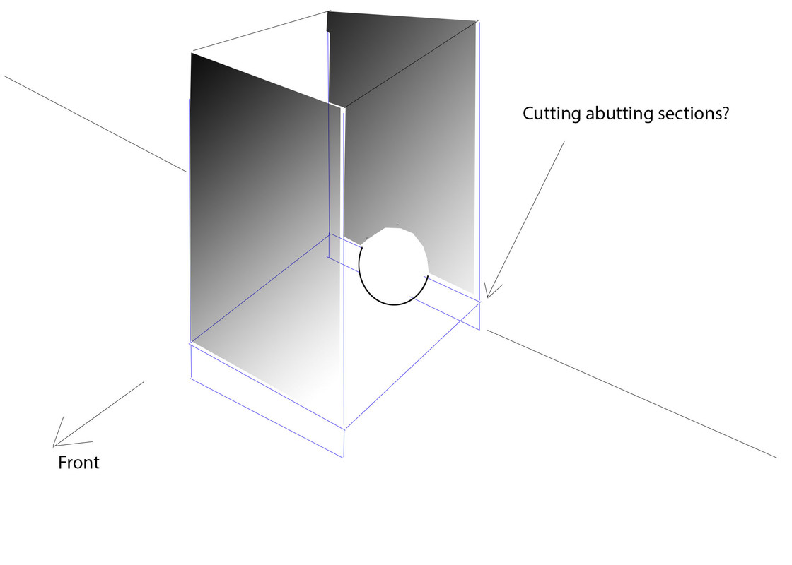

The toe kick is not removable on this unit, and even if I drilled a hole in it to see there is the same toe kick on the rear of the cabinet. But lets say I do cut out the backs, this is just a quick sketch of what I imagine it would look like.
Lets say I do cut the middle section of the cabinet marked by the circle in that picture, you see how I have to cut through the rear toe kick in order to get to the wall? That's not going to be an easy cut and it will leave the cabinet high and dry without the rear support. But lets say I manage to do that, there is no guarantee that the hole will be behind that cut section. So I would have to cut these kind of holes every few inches, ok still doable, but you see the section I marked abutting sections, that is where the adjacent cabinet begins that corner joins 3 wooden boards together, I would have to cut through it completely, which will be very difficult and it would now mean that I'd be working away at the walls of the cabinet too. Now can you imagine what condition this will be in once I'm done cutting everything and how difficult these cuts will be to patch up?
The cabinets when installed should be pretty solid from the floor, the wall, the counter and the cabinets on either side. You could pretty much remove most of the cabinet without much issue.
Question, how do you even know where to cut? What are you going to have after making several guesses, a huge mess!

Yes cutting seems to be out of the question. So you're saying that it's not difficult to just move the cabinet? I don't have to remove the counter top or disassemble it or anything like that? I guess I can see if I can try that, but like I said it's one big cabinet with dividing walls to make smaller ones so I have to remove the whole thing. So where can I find the attachment points, which I assume are to the floor? If someone can direct me to a video or give me a run through the process I'd appreciate it.

$50 is not even going to come close to the amount of $ needed to do this job. Removal of the tops, damage to the wall where the top meets the wall, materials, and of course your time will greatly exceed this number. If you are bound to fix the issue, I would use a 1/2" one-side finished plywood, cut sections small enough to seal what needs to be sealed and still fit through the door openings, and simply overlay the existing interior of the cabinet. Use hole saws to cut for piping, then cut the sections through the middle of those holes so you can use these "patch panels" as giant escutcheons. These site-built cabinets are a nightmare to work with, and in reality should be replaced. It sounds as tho you are working with a typical bottom-of-the-barrel landlord, none of which I have ever met in my 40+ years as a finish carpenter was ever profitable to work with. Do yourself a favor and walk away if you can.

I am told a mouse can squeeze through a hole the size of a dime or a slot just a quarter of an inch wide or high. Can you at least find out how the mice are getting into the cabinet insides? or other viewable areas? Then patch the hole or slot (in the cabinet back or floor, not in the wall behind) as seen from the living area or cabinet insides.
Where the water pipes and drain pipe and dishwasher hose enter the cabinet interior is another place to patch.
No exploring, no cutting.

Before I got carried away tearing apart cabinets etc. I would buy a can or two of the spray foam and spray around all the penetrations you know of such as water pipes, electrical lines etc. That's a cheap quick fix that may solve your problem without getting heavily involved.
