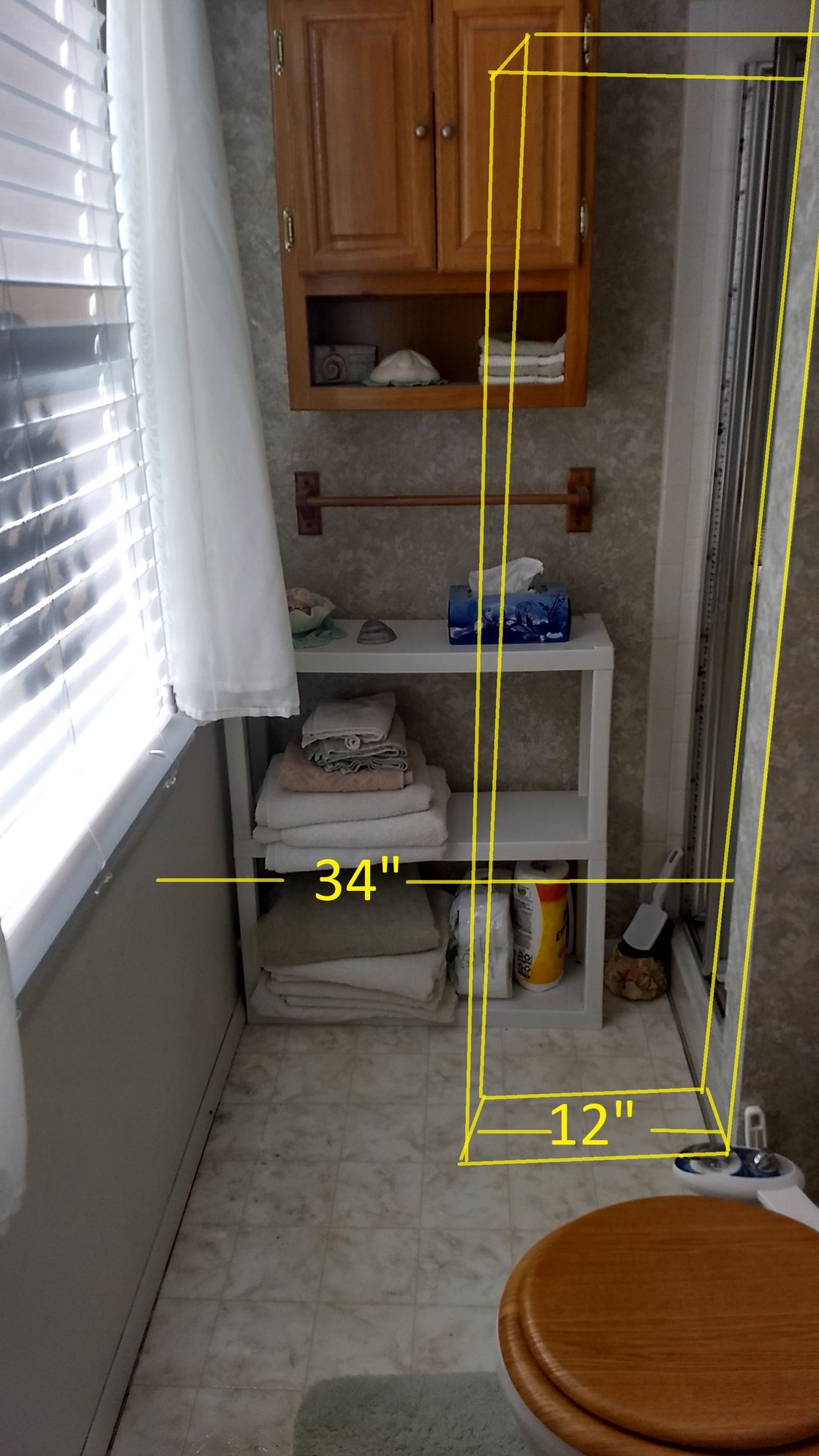

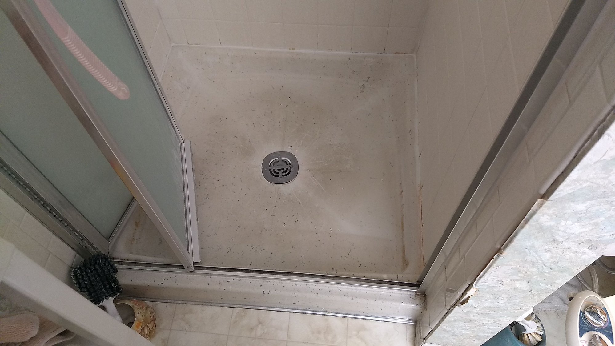

current shower install
as it now stands
What she wants
In addition my other half wants to extend the shower to make it into a “walk-in” style without a door. She wants’ to extend the wall to the right towards the window as the shower entrance. The pictures are deceiving. There is more room than it appears. I told her that it is not possible, mainly because it will interfere or intersect with the window and may not be to code. And the drain will not be centered. That might mean a custom made shower bed.
The other point I want is your opinion, suggestions and tips on what is entailed to remove existing shower bed and installing a new one? Is the shower bed just sitting on wood framing or is it set in mortar or some kind of “material” bedding.
If it helps the house was built in the early 70’s and located in Western New York (West Seneca suburb of Buffalo). Many plumbing and electrical codes were not established or overlooked back then, but by comparison to the older part of the subdivision, my house and section was more closely inspected and built. I have no plumbing issues or electrical problems
At 71 years old I just might have a professional come in and at least provide a quote.

What she wants

The old pan looks like it's fiberglass, so it should pop out reasonably easily. Though the pipe may need to be cut underneath first, or the pan cut out if the pipe can't be released from below. Not a big deal though. It's likely just sitting on top of the plywood subfloor.
Old shower pans would often be on a mortar bed, but I think there are much better solutions these days. There are much higher quality shower pans (I don't think they are fiberglass, some kind of resin I believe) which just drop in. Or you can use a Kerdi (or similar) which is basically like a sealed styrofoam pan which has the appropriate slope that you tile over. The pre-made pan is certainly the easiest, but Kerdi provides a full custom tiled look.
Once you're down to the subfloor, it's not a huge deal to move the drain, depending of course on joists. The pans you choose can have a centered drain, or a drain off to one side, or the corner. There are even curtain drains now, so you have lots of options depending on how crazy you want to get.
I would also consider a glass shower wall to separate the toilet and shower instead of a built out wall. It will make the bathroom feel much larger - but of course that's your call. Or maybe a half-wall with glass on the top-half, those seem to be all the rage these days.

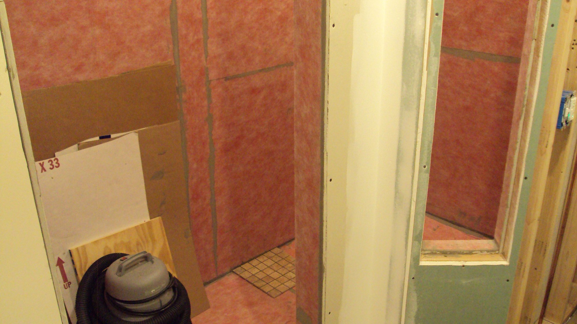

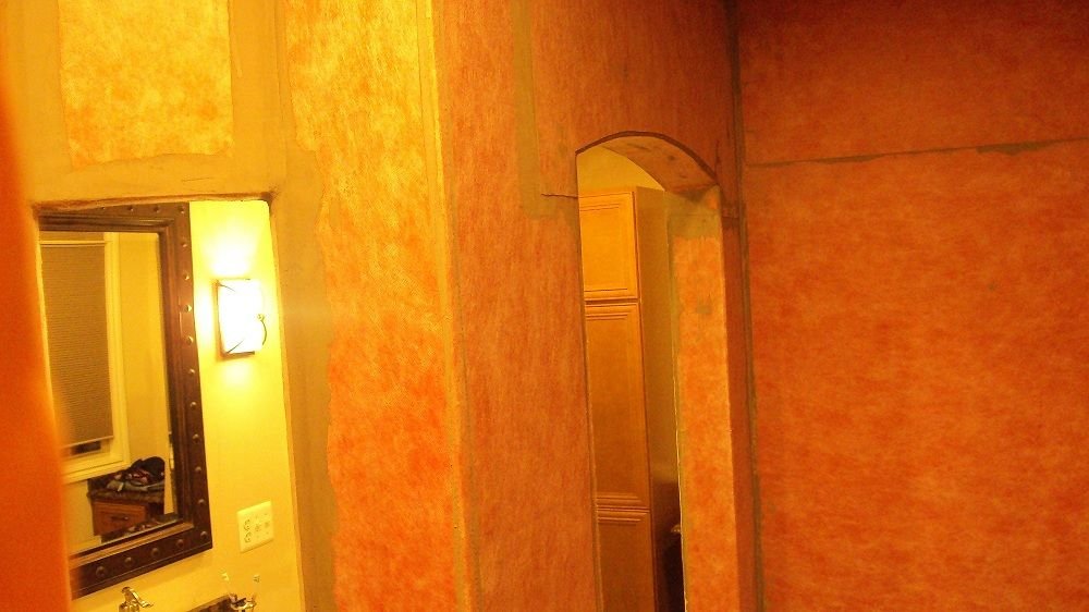

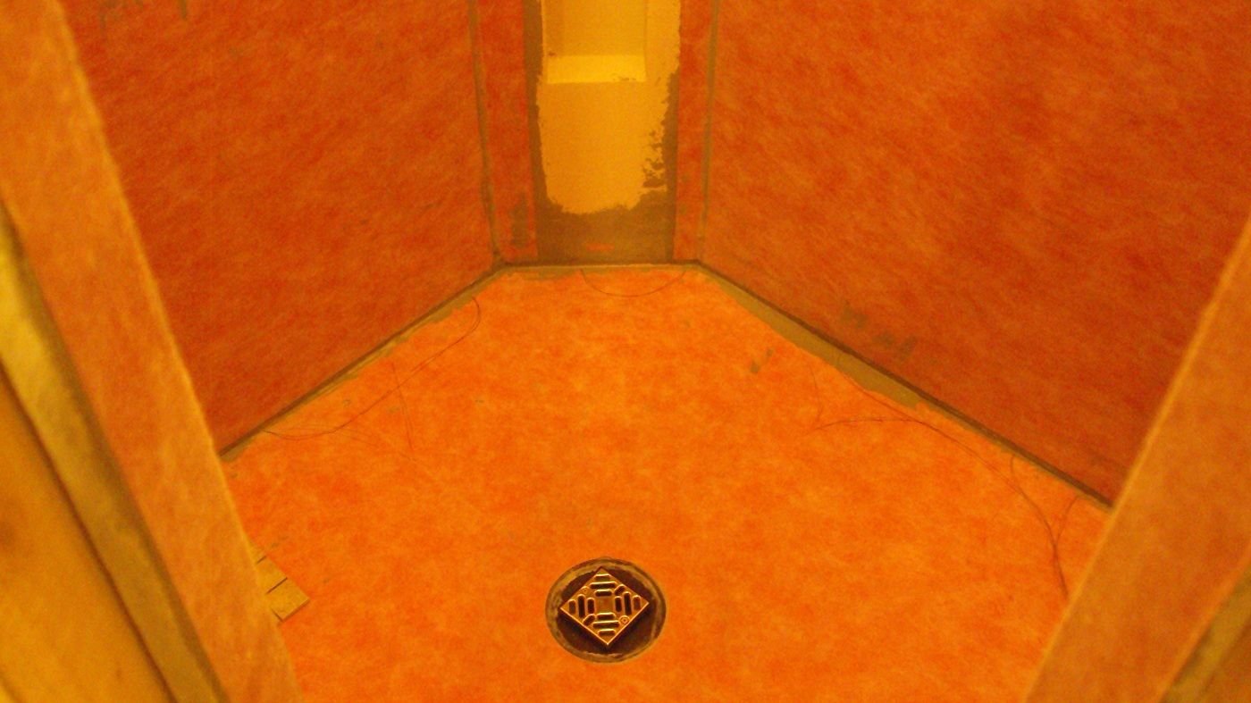

1st picture:
This is looking into the shower, opening on the left is entrance, the area inside is 3' deep x 4' long, opening on right is an interior window to the shower area which is 4' deep x 4' wide so a bit of an "L" shape.
2nd picture:
Looking in the window to the Prove drain, floor is tiled!
3rd picture:
Looking from shower area to window on left and entrance on right!
One comment, we also had initial concern about cold drafts without a door but found once water heats up and steam forms nothing, and I mean nothing, makes it's way into the shower so no cold air concerns!

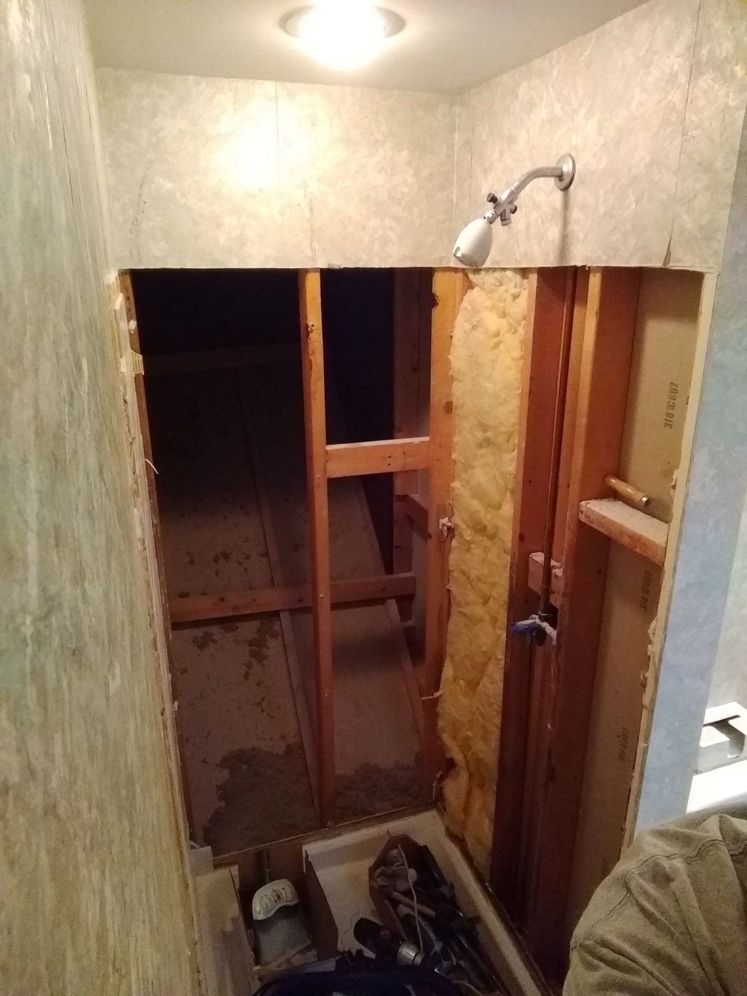

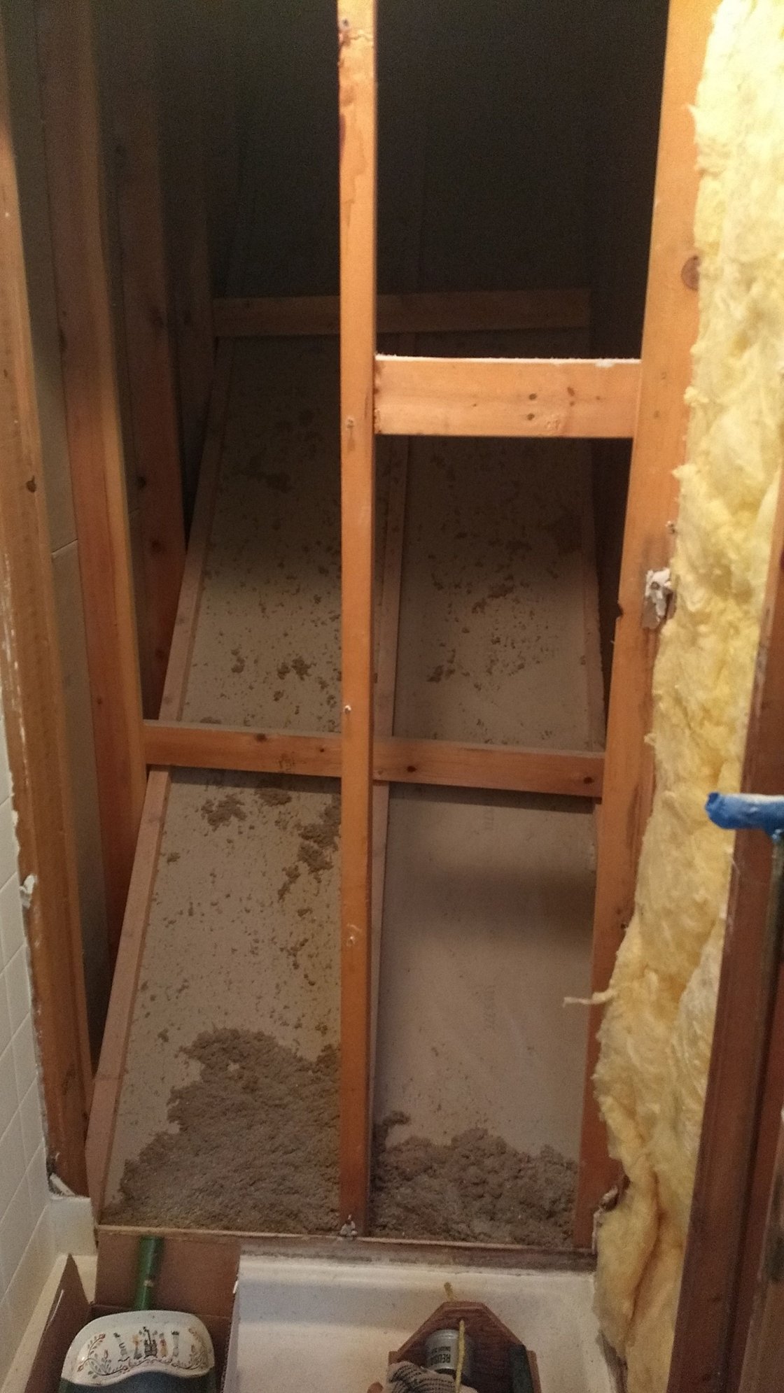

Update!
I actually started the remodel project. Stripped two walls of the existing shower so far. I promised my wife I would take my time on this and work at my leisure.
Supply piping comes along the right wall
Stair well behind back of shower wall
Notice I only removed the area of shower wall that had tile. I'm thinking that I may not need to remove the upper section. How about after I strip the old wallpaper I coat that area with something like red guard since it's very unlikely to see water that high and it will be tiled up to the ceiling. The new wall sections will be cement board. Then tiled. I'll be lowering that shower head by about 6" to 8" to allow wife or short people a chance to reach it.

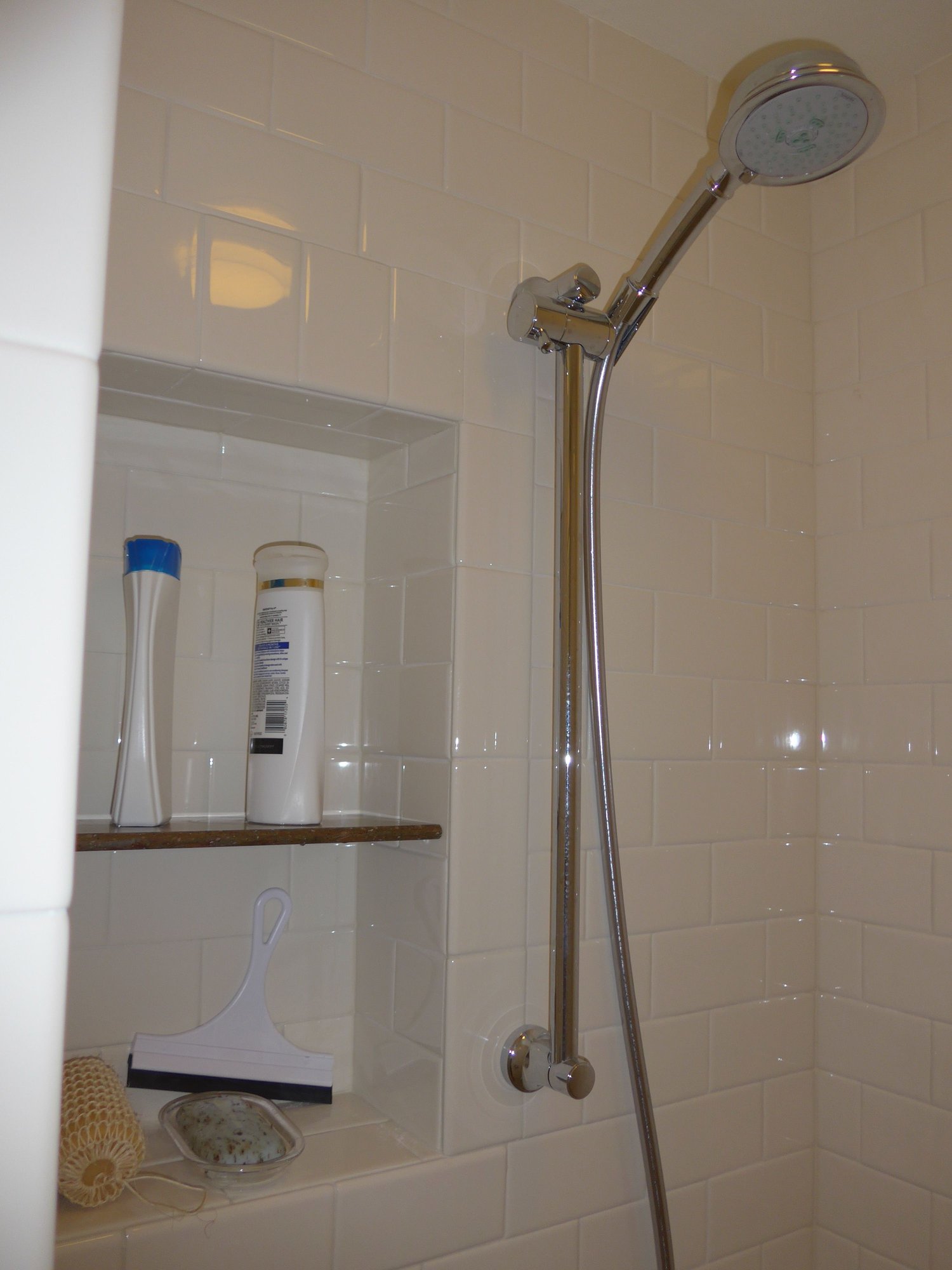

I kind of like the external or surface mount spa systems that have multiple nozzles along with shower head and hand held wand.
Don't short cut the quality, life time guarantee of the shower components you don't want cheap!
I will say the hand held attachment is handy, I just spent the weekend cleaning the grout, that's about the only time we ever use that feature!
We had a really nice rain shower head in there but my wife didn't like it (not enough pressure for hair washing) so that came out and just a basic shower head (less the water restriction) so that's our custom setup!
The hand held is a must for us. We seldom use the overhead shower.
Another item I want to avoid is MOEN"s POSI-TEMP feature. I prefer a single handle faucet but goes in both directions, i.e. hot and cold as opposed to starting only in the cold position and then turning towards hot.
When I redid our main shower a couple of years ago we opted for a hand held head only. It has a full volume setting (almost like rain head) and is mounted on a sliding rod bracket for adjustable height.
Adjustable/removable shower head
When the shower was first built it had a fixed head so we mounted the valve on the side near the door to avoid getting wet until the temp came up. This new valve sticks out more and occasionally gets bumped (down) to a cold position. If this was a new install I would mount the valve on the side wall where the head is mounted since the adjustable head can be aimed away to start.
Maybe a good place to work in a bench and deeper-than-stud-depth niche.

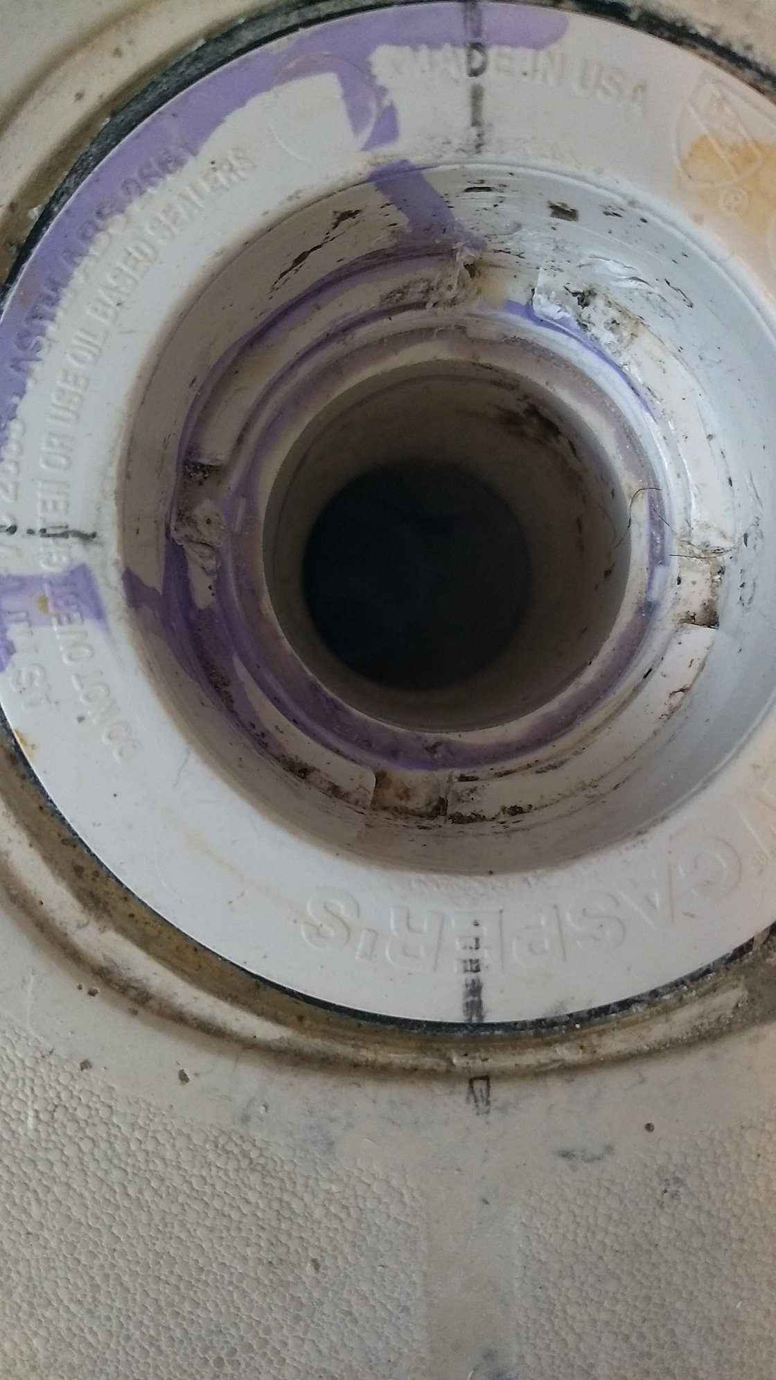

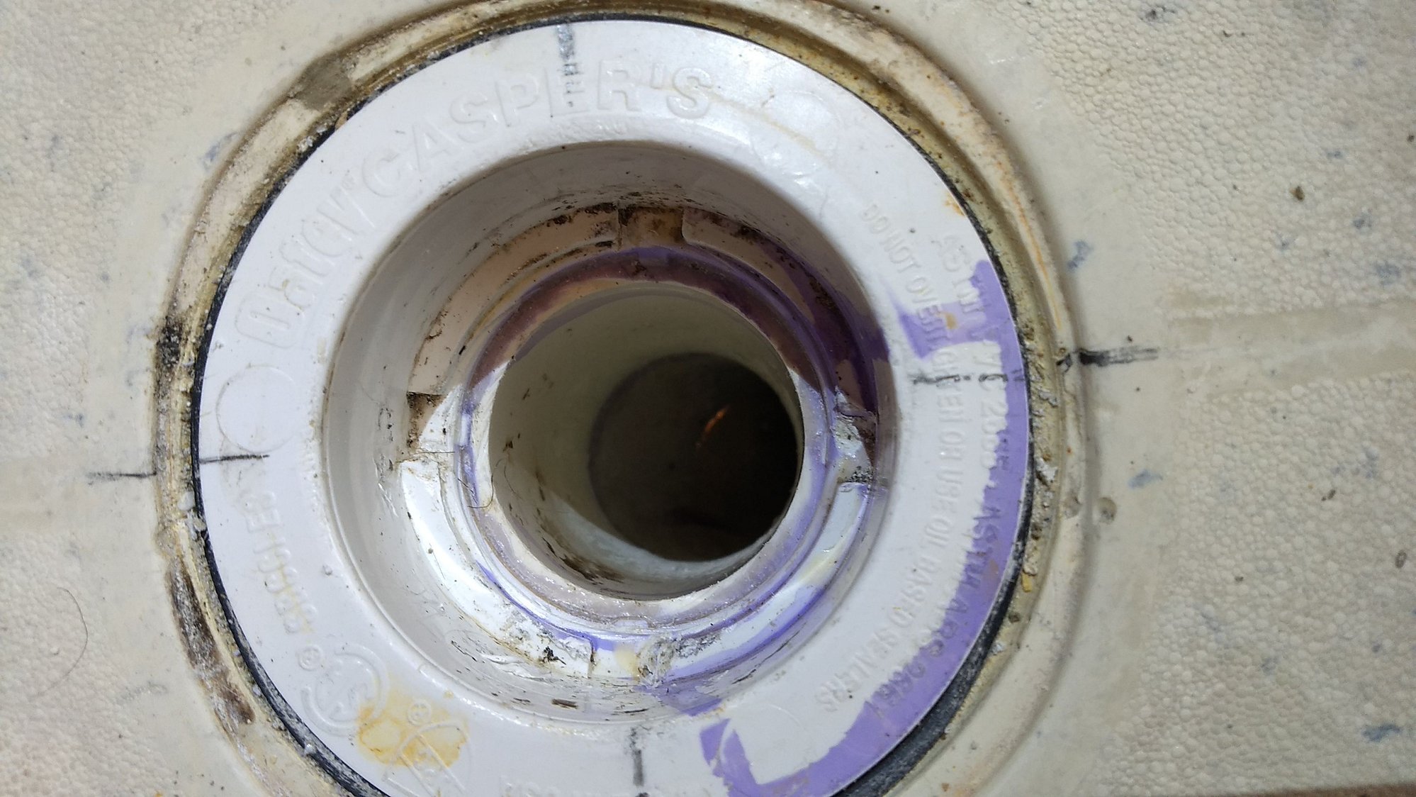

What is the best way to remove this drain from old shower bed? It's glued in. Should I just cut the flange area and lift the whole bed out? Or is there a way I'm not aware of. I'm a little concerned about the trap. It's shallow trap sometimes referred to as a Los Angeles trap.
#21
See the two dark notches part way down in the drain. Insert something into them (think massive screwdriver) and unscrew the top part of the drain. That should leave the rest down below undamaged.
#22
PD, about 25 years ago I replaced this drain. IIRC properly I don't remember any screw on mechanism. Right where you see those notches, below the next step is a heavy fillet of glue. I just bought a rotary saw kit and will begin to cut just below those notches. Then I suppose I will need to cut off the "sleeve" portion that slips over the drain riser.
#23
Let me retract that last post. PD, you appear to be correct. It does screw on. It even says so on the edge not to use oil or any type of grease. But how can I unscrew it. It seems seized on. I tried a rod and hammer on those notched section but it won't budge. Looks like a special tool is need to grip all 4 notches and a long pipe to get enough torque on it.
#24
Drain wrench with nubs that will fit into those grooves?
Drain wrench
Aren't you the hardware store guy?
Drain wrench
#26
I cut a scrap of steel bar to the size (about 2" long) needed to drop in the slots. Then I put a wrench on the scrap of steel and use a second wrench to turn the first. It will be hard to turn. It's a big fitting with a lot of thread touching creating friction. Worst case you can chisel it out but try to preserve the drain piping underneath in case you are able to reuse any of it.
Norm201
voted this post useful.

I guess committed to cut this sucker out. I even called a plumbing supply house (IRR) and they have nothing that big to remove the drain. I tried using a sink wrench like this . I was able to jamb it inside in a reverse action. I was actually able to deform the shape of the drain and put so much pressure on it I nearly broke my wrist when it finally slipped.
Here's a better picture of it.
#29
I had to cut it out and finally removed the shower pan.
Well I kind of screwed up a bit. 25 or 30 years ago when I had fix the leak that developed I must have done it from the underside or hallway ceiling below. The part with the nubs is in fact a shower drain coupling glued to the riser from the trap. Under the shower pan is a large hex screw that screws on to the pan drain. There was no way I could've unscrewed it properly without cutting open downstairs celling.
So now I'm stuck with this dilemma. See pic. The glued part of flange coupling is still glued to the riser pipe. I need to get that off in order to install another one. Any possible ideas that I can remove it and still make the riser pipe usable?

After lots of patience and careful grinding I managed to remove the old shower drain from the riser pipe. I bought a 2" repair coupling to use as test fitting. I was very careful not to nick or grind off any of the pipe riser. And the coupling fits smooth enough and tight enough that I feel confident that the new drain receptacle will be leak proof when glued on. I also found an interesting fitting. They have a shower drain adapter that is slightly offset. That could allow for any minor dimensional error to make nice fit with a new pan. I was not aware of this. It pays to roam around the hardware are of store every so often just to see what's available.
