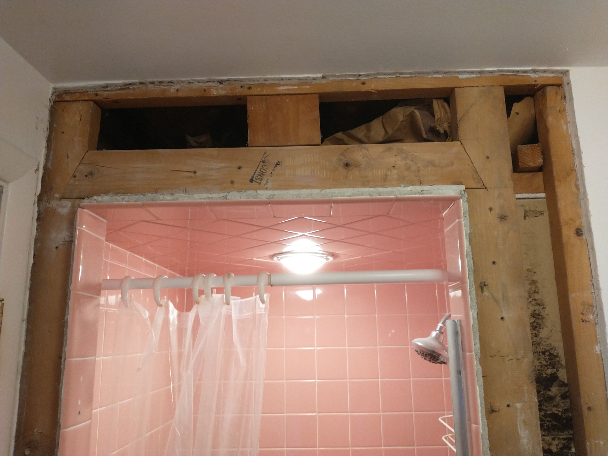

I am gutting a shower stall. You can see in the picture that there is a false ceiling. I am guessing that may have been to allow for a recessed light. Insulated attic is right above. Do I leave the false ceiling or is there a reason to remove it and go right up to the ceiling floor joists? Thoughts?

Do you still want the recessed light? That should be you determining factor. If it were me I would go right to the joist and install a combo light, fan and night light. In fact That is what I'm doing in my shower stall.

​​​​​​there is already a fan 2 feet to the right in the ceiling outside the shower so I just need to update the light. All else bring equal, do I take down the ceiling?

Unless there is plumbing or HVAC in that space I'd be inclined to remove it. With a higher ceiling it isn't necessary to tile the ceiling. Is that mold on the backside of the drywall on the right side of the shower?

Yes. That is mold. I was going to wash it down with some bleach one I get the old tile out. Will that be enough?

It might be. Mold needs 3 things to grow; heat, moisture and a food source. Eliminating any one of the 3 will stop mold growth. Even so you want to remove what you reasonably can.
