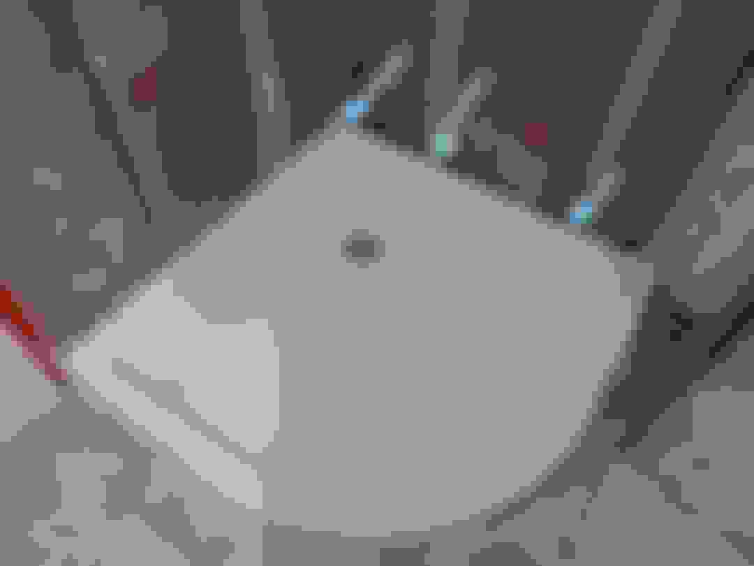

I'm installing a corner shower base, my inside wall corner is square but my shower base is out of square a 1/4". Can I just fur my studs and run the wall out of square so my base fits tight? The outside edge is tight but my inside corner shows a 1/4" gap. .
I thought it was my wall at first then I checked the shower base with a square, sure enough the inside corner of this this base is out of square. I'll have to run furring strips on the studs and make the wall out of square with the base so my backer board is past the flange lip on the inside corner.
Also consider how that might affect your tile pattern and any accommodations you might have to make. Probably not much of a problem with a corner shower, but one with opposing walls might have an issue if a wall ended with a full tile.
Definitely would be a problem for intersecting tiles if the wall was not plumb.
When I go pick out the tile I'll make sure to measure them first so I'll have enough overhang length and not end up with a full tile. Planning on going with a longer rectangle tile not square, I believe last time I looked I found some what were about 4 inches longer than needed so I could cut the ends.
