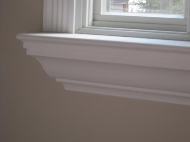

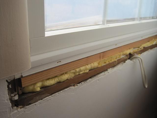

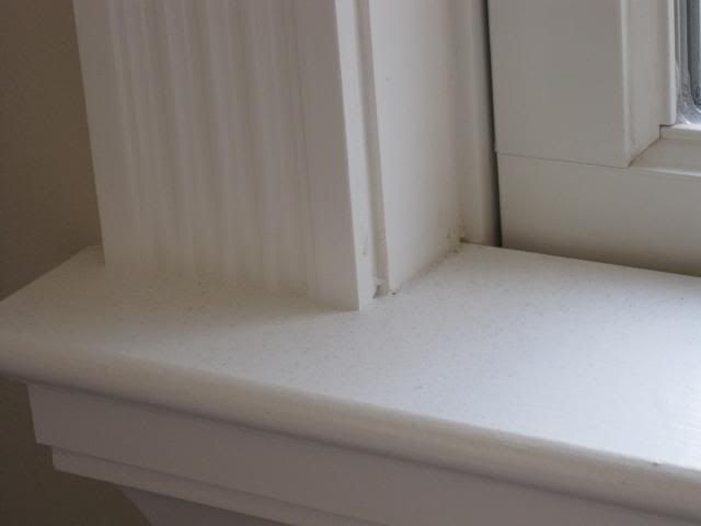

Old 12-05-13, 09:27 AM
Join Date: Jan 2004
Location: Baltimore
Posts: 1,143
400 series (my wall is little bigger than 4 1/2 since old house.
400 series. the surface of wall would be right where the nail of my finger is. so window pretty close and you can't put sill on this.
finsished 400 series. note how sill is against wall and window and does not "step" in where window is located.
200 series. note how the sill does step in where window is located. so the sill is sitting on the lower jamb.
finished 400. because my window sill receptacle has to sit out from the wall, the sill has to be deeper and the crown bigger to accommodate it.
finished 200 series. because of the step in, the receptacle can sit "within" the wall and the sill doesn't have to be as deep and the crown can be smaller.
