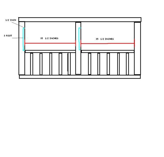

Screen Deck to Enclosed Deck-window issue
I have a 10x14 screen deck that we are turing into an enclosed porch. I have 4 windows in the front and i need to add 3 more to the side. BUT the openings on the side are a 1/2 inch to small for the windows. Windows are 36 inches accross and the 3 openings are a 1/2 inch to 3/4 inch to small
What can i do? Can i saw into the beam to cut out a 1/2 inch area so i can fit the window in? What kind of saw or tool should i use???
Thanks
Matt

You said you needed to add 3 windows on the side, so I assume your illustration was to give us an idea as to what you want to do, although it only showed 2 windows. Cutting the vertical support is not usually a good idea. I know you have already purchased the windows, but could you exchange them for ones say 32" wide? It is always better to fill in than to cut out.

Yeah sorry illistration was off, after i finished i realized my error.
Thats the thing, we are putting in slider windows and they only come in 3x3, 2x2,1x1. Our others are 3x3. So our only option would be to use up and down windows, but we want it to look universal.
Ideas???
THanks
Matt

Thanks for the input, we are just going to settle with the up/down windows and sliders. Dont want to take on more then i need to
