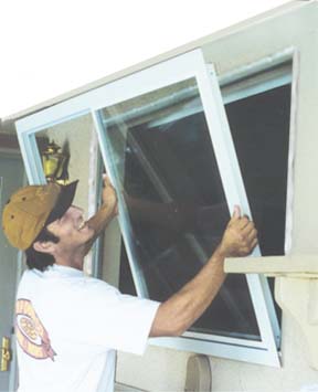

Actually, from what I've seen the retrofit windows here in California (such as Milgard) have a reasonably wide flange on the outside of the window that gets sealed against the aluminum frame and then caulked around the edges onto the stucco. Such as this:
http://www.dpdoor.com/images/brent%2...g%20window.jpg
While new construction they chisel away the stucco and remove the old frame, then secure the window to the framing via the nailing fin. Then they repair the stucco back up to the edge of the new window.
Well, kiss my grits. Yeah, I see, but it actually isn't technically a "flange", but a frame trim. I see how it goes on stucco. Never dealt with that before, just common woodframe construction. Thanks for the heads up, GG.
