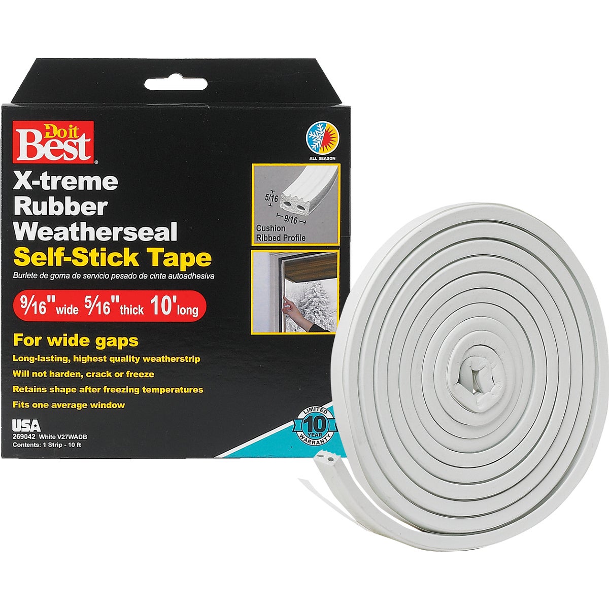

Well... I know nothing will stick to a cold icy gasket, and today and tomarrow probably aren't ideal days to be working on a window but for a few bucks you could try getting some weatherstrip tape (rubber or foam), and experiment with adding an additional layer on top of your existing gasket. Perhaps that would help seal the sash up as you bring it closed and lock it.
I'm thinking something similar to this:
Image credit: DoitBest
Additionally, the area where the crank is happens to be practically impossible to seal well, especially if there is no "fin" weatherstrip attached to the casement sash itself. Perhaps some open cell foam could be stuffed around the gear box under the wood trim to help slow air movement in this area.
Another idea would be to actually caulk a couple of your windows shut and see if you see any improvement in the icing. If they are caulked shut that should eliminate the possibility of air infiltration causing the icing. I'd recommend a product like DAP Seal-n-peel, which is a temporary caulking that can be easily removed.
