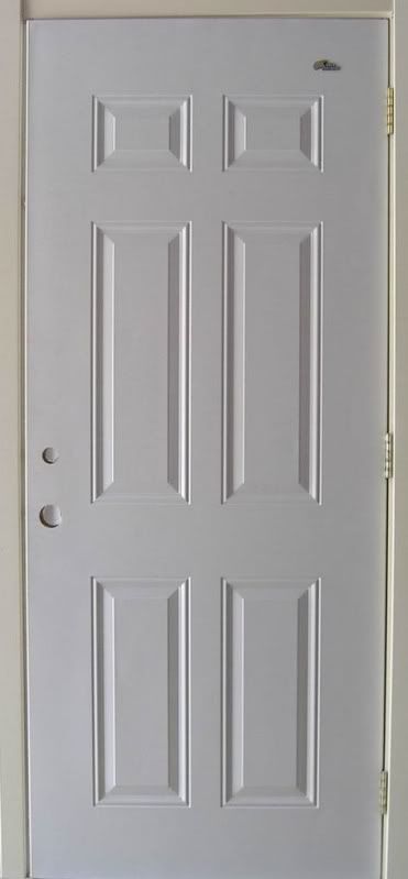

In a house, there are multiple sizes of doors. One has a broken panel and they want it fixed. I suggested that it would probably be cheaper to replace the door than repair the broken panel.
The door size is 32 x 80.
But all the other doors in the house vary in widths, some wider and many narrower. What is the standard width?

The particular door in question looks like this:
The bottom right panel is broken.

Looks like a standard Masonite faced door. Would need trimming and fitting, but should be a common item at most any home center or full service hardware/building supply.
I've heard and seen the results of repairing similar hollow core doors (with newspaper /cardboard and spackle, not always good), but it's just as simple to replace and repaint for most people.
You need to match the beading of the panels (if thats important to the owner), but its a pretty simple job for a good craftsman or handyman.

Ya, I agree, it looks like masonite.
Since I usually paint the doors and seldom install any, I'm not fimiliar with brands and such but that looks like the type of masonite panel door that doesn't have the fake wood grain. Some do and some don't so you may want to pay attention to that when you look for a replacement.
If you do opt to repair, cut out the damged area, insert a piece of wood the same size as the hole and slightly thinner than the door and glue it in place [if necessary use a nail on the other side] and spackle over the patch. Sand when dry, prime and it should be ready to paint. Those type doors aren't all that expensive so replacing makes more sense ........ unless you have a plenty of free time and not much money
