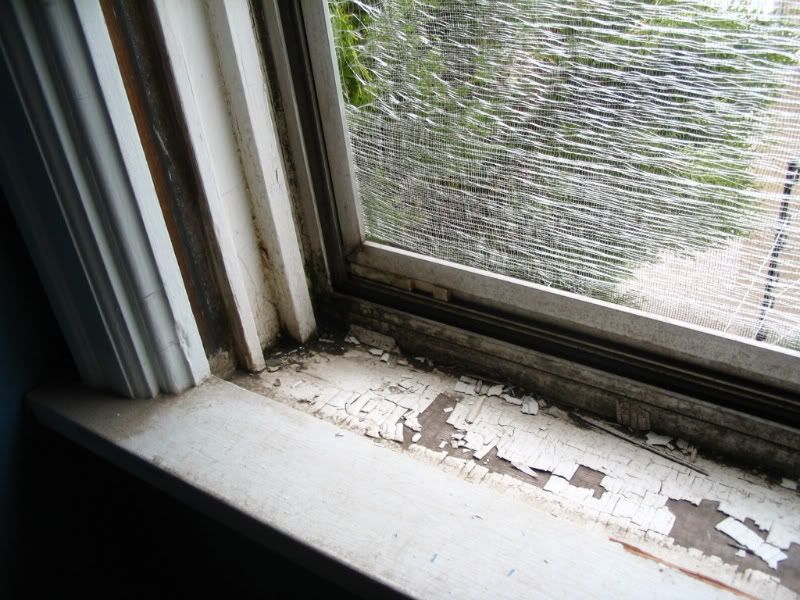

My house has seven double-hung windows that are 70 years old and in bad shape. I'd like to replace them but have a few questions. Here is an image of what I am dealing with:
I'd like to just do sash replacement type windows. From what I can tell, a couple of them might need the sill replaced due to some rot. For the others that don't need the sill replaced, what should I do to protect them? I'm assuming the best time to replace/repair the sill is when you remove the old sashes for replacing.
Regarding the aluminum storm windows/screens: Do I just remove and ditch these when I install new windows, remove and rebuild them, or replace them? It seems like the storm window design is what led to the deterioration of the sills: When they are opened (like during the summer), rain can pool behind the aluminum frame on the sill.
Any advice would be appreciated. Thanks.

Typical older house situation. The old storms go to recycling, modern L0-E glass eliminates the need for storms, and most storms will not fit under new replacement windows.
Rotted sills can be reapired and the others wrapped with aluminum to prevent further mositure problem and maintenance. You are correct in you assesment. There are small drain slots in the storms to let water out. Too often they get caulked over or blocked by debris which results in rotted sills.

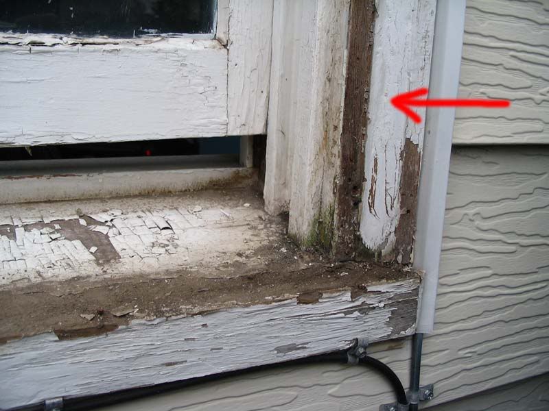

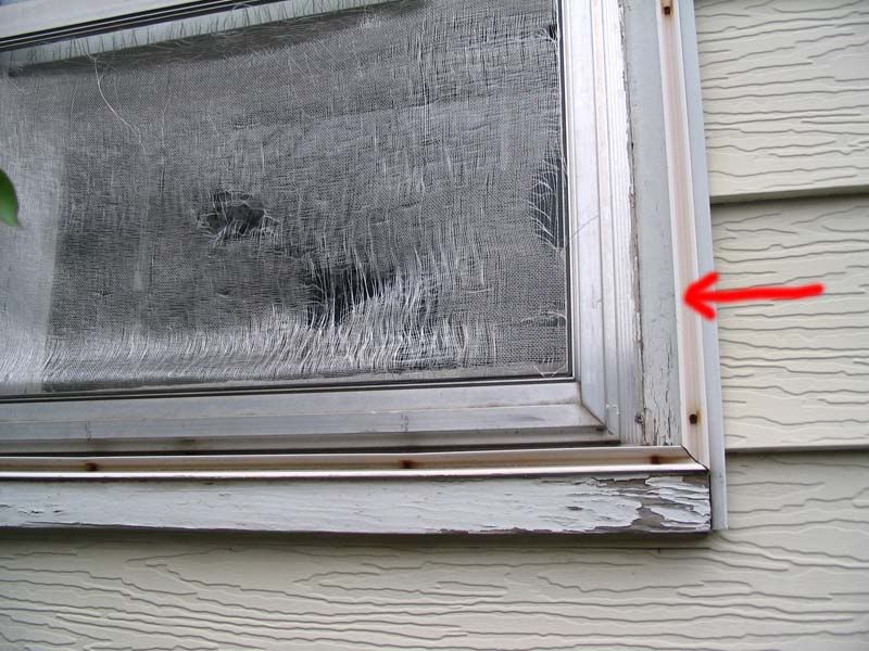

More questions for you. I took a look from the outside yesterday. Here is an image as they currently look:
Any idea what that red arrow is pointing to (channel looking thing)? I'm assuming it was for yet another storm window type thing but I'm not certain.
here is what it looks like with the storm window and unknown channel removed:
The trim the arrow is pointing to looks like the most rotted part on all the windows.
So, seeing these images, what steps do you recommend? I'm thinking of ordering the windows and in the time it takes to get them delivered, replace the trim I pointed to and repair/cover the sills. Sound reasonable?

Install quality vinyl replacement windows, which means nothing from big box stores, and nothing that advertises windows at $150 including installation. The sills look solid, so install new replacement windows, scrap the storms, wrap exterior trim with aluminum, forget them for the next 20 yrs.
