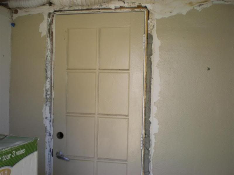

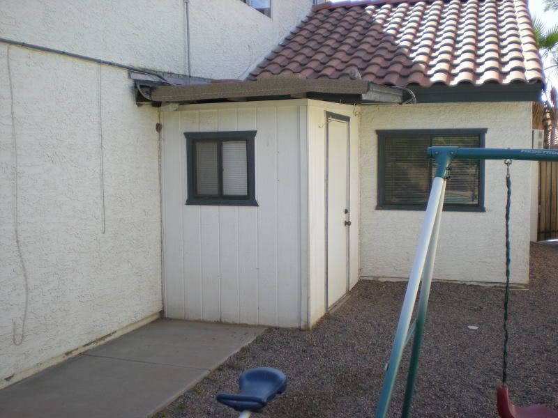

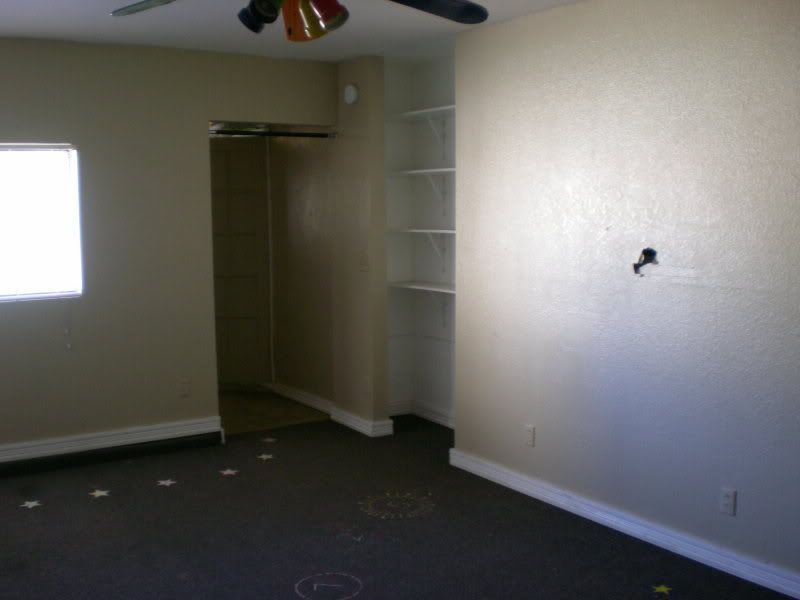

Hopefully in the very near future I will be dropping in to new exterior doors and knocking down the horrible add-on job the previous owner did. I am a little confused when looking at a few things.
In this pic the wall you see next to the door is really the outside wall of the house the previous owner tried to make a walk through and put an add-on over that area. The house is all stucco on the outside but now the wall is flat with texture on it from what i can tell. I thought it may be a thin sheet of sheet rock nailed into the stucco but fear I am wrong. How else would they get it more of a flat surface, just mud the whole thing over?
To the right of the door there is what looks like cement running up it which is all cracked and falling out as well as to the left. The door looks like it is pressed right up against the framing to the right and on the left there is a bigger gap and some shims.
I am curious as to what needs to be removed to put in a nice door. I figured I would go pre-hung and afterward have the stucco re-done in that area once I remove the add-on. I can also provide more pics if it will help but figured most of it could be seen in those.

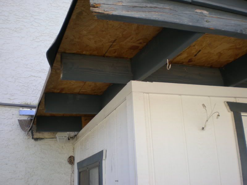

There is also another door that needs to be dropped in as well. This one leads from the 3 car garage to the outside. I have been hanging new sheet rock in the garage and when I removed some of it near the door area I saw the framing for the doorway and noticed a layer of styrofoam right up against it. I tried to re-search it a but but didn't really come across anything. Gotta turn your head sideways!
This is the doorway for the garage to outside
And this is the outside add-on that is being removed after the doors are in and good to go.

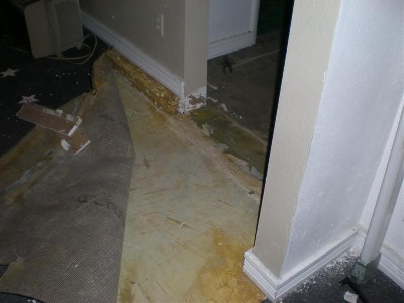

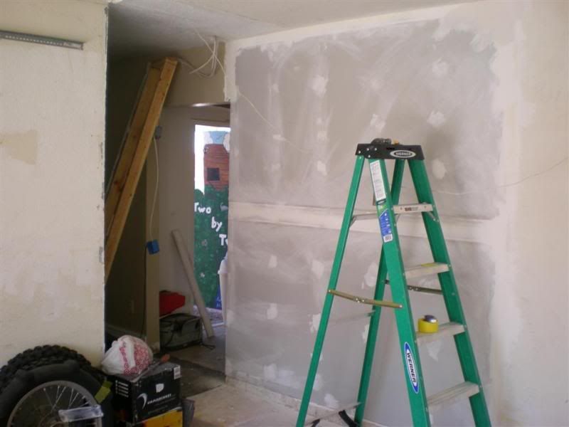

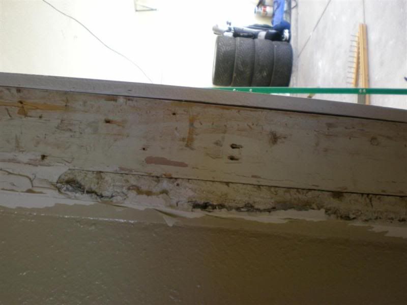

My first question was, what is over that doorway, but your pic answered that question. Looks like it is well supported and only needs minimal support. How thick is the wall?? That should be your guide for a new door. A standard door comes with 4 9/16 jambs, but you can order whatever you need from a local lumberyard, avoid big box. Order the jambs to fit the wall, don't try to re-engineer the wall.
fox_forma,
Well, looking at the pics, I would say that the previous owner started with a pretty nice home, bought some fairly decent items to do the addition with, then proceeded to make a mess out of it all!!
Where to begin?
The 1st and 2nd pictures. How wide is the door that he installed? If it's a 32" wide, could you tear out all of the patching and install a 36" wide door? THAT would clean up a lot of mess. Those vinyl ducts above it -- are they for exhaust fans in bathrooms or something?? Get them to run without the dips in them, and even slightly uphill would be even better.

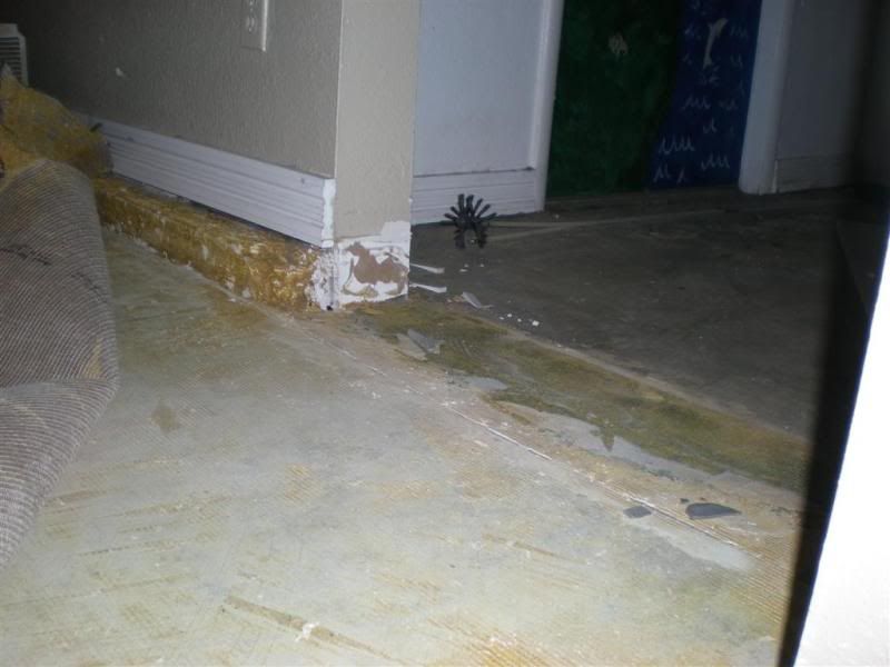

3rd picture. I turned my head and got that stack of 4 tires properly oriented. I have no clue what he was thinking or trying to accomplish!!

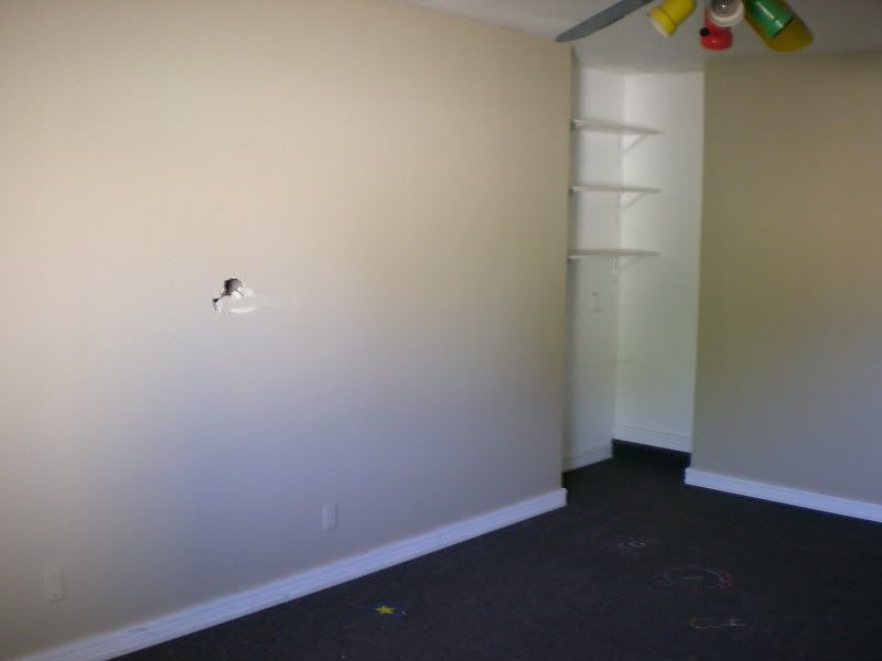

4th picture. Get down to the rough framing and install a door.

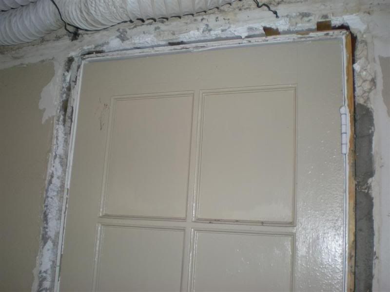

And the 5th picture. A mini-excavator comes to mind!!
YOU, my friend, have a project on your hands!!
I would start with a pencil and a piece of paper and sketch out what the house was originally. (That's point "A".) Then, on a second sheet of paper, sketch out what you want it to be when you are finished. (You've got it -- point "B".) Having seen photos of this guys work -- and the photos only show the surface!! -- I wouldn't even think about leaving ANY of it!

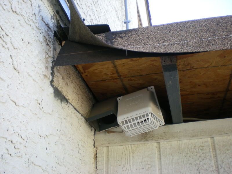

As for the vent tubes running like that, they will be secured and mounted properly once I can rip down that add-on. They originally just come out to the right of that door and are mounted to the exterior wall but the previous owners ran them like that so the heat and lint didn't blow into the garage/bedroom. To let you know how crappy that extra add on is, I can stick my arm right through the top of it to the outside from inside of it. I'm surprised I haven't had any birds in my house yet or even see a lizard or something running around my house.

The great carpet job
Got most of the self poured slab up today, it was actually higher than the foundation slab for the garage, luckily we haven't had much rain this year -- before picture...

And this is where I can stick my arm through from the inside to the outside. Pretty nice eh?

Oh no not at all surprised about the carpet, sad thing is its like that in the front room when you walk in the front door. Hardwood will be layed throughout the whole first floor eventually so I'm not worried. I think the husband of the previous owners were a DIY'er only he never researched a thng on how to do it since just about everything that has been changed or modified is done wrong.
There is something I am a bit confused about and its really hard to get a decent pic of it is I put up a lot of new drywall in the garage and above the doorway where I left up the previous drywall there is a considerable difference in how far it stick out. It looks to be a good 1/8in higher that the new drywall. After looking at the drywall I pulled down around the door frame it looks like the whole thing has a layer of mud on it. Isn't there a process that has to do with this? Can't think of the term but I am not sure I am going to be able to feather this out as its a pretty big difference in height.
Now we're getting down to specifics!!
How thick was the sheetrock that you installed? If this is the wall between the garage and the house, it's a firewall, and old code called for that to be 5/8" 'rock. The new code (2006 IRC) says that 1/2" 'rock is acceptable, but every builder in THIS county is still using 5/8". (That same code also says that rebar is no longer required in a footing. I don't know of anybody around here who has poured a footing WITHOUT the rebar!!)
An 1/8" is a lot to feather out. If you only installed 1/2" 'rock, I would change it to 5/8". $100 of wasted sheetrock vs. 3 days to get it feathered out and have it look like something.
