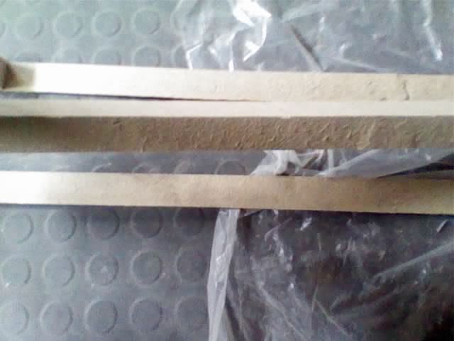

I am installing a hollow core door that had to be trimmed down from the standard height. (This is a pocket door and I am trimming from the top since the top is partially concealed by the door frame.)
Sadly, I trimmed a bit too much off the top of the door and the hollow interior is exposed.
First question, is this a problem beyond being ugly if seen?
Second question, if it is a problem, what are the best options short of buying another door and trying again?

Take the piece you cut..peel off the skin and clean up the wood core. If you can't salvage the core, you can make one from 2X material on a table saw. Remove any material inside the open top that may interfere...coat the wood core with wood glue and insert into top of door..clamp in place. Predrill the sides and run a finish nail though the sides into the glued core. Countersink the nail heads and putty the holes.
You may have a problem since the hardware mounts to the top of the door, so the attachment of the core needs to be as strong as possible.

I've always liked to rip a new piece to install in the opening - removing the skin and glue from the cut off piece is too much work

One problem with reusing the piece is that many makers have started using MDF on the edges..not as easy to peel the skins as real wood. Normally a painters tool or a wide chisel will peel it right off. Easier than having to set up a table saw for a 1 cut job on site.

Hi, Use wood for the top. MDF will not hold the screws for the hardware in about a year you will have to take the door down and repair. For information the repair I do is drill out the screw holes and glue in a 3/8 dowel and reinstall the screws in the wood dowel.

I was able to get out the stock core from the 'skin' of the door. It is not solid wood going across the top though it is solid wood going up and down the sides. (I assume it is MDF going across the top.) It actually was pretty easy to get the skin off. I knocked it off with a hammer and screwdriver and filed the edges clean. I then cut off the cardboard support running up the middle of the door to allow for the core to slide into the cavity. This was actually the hardest part due to it being inside the door. Once I had it trimmed close, I used a file to take off the last bit I wanted to make room for the core.

A second problem I noticed. The hardware to hang the door has one screw that will catch the core and one screw that is below the core. The core being an inch thick. So, even with the entire core left there, only one screw on each 'hanger' will catch on something besides the skin of the door. From what has already been said about the original core not holding the screws for the hardware, I assume that this is even more of a problem?
I may have to trash these doors and get 'flat' doors so I can hang them from the bottom where there is more core. I am going to examine very closely the doors that were hanging there with no problem...maybe have an autopsy...see what those doors can tell me...
Edit: Examination completed. The doors that I am removing had a thicker core at the top and both screws caught the core. I guess they are from the time when the core went deeper than just an inch. But, this gives me some hope that I do not have to replace the stock core with a piece of lumber. ??

Edit: In case this helps with my suggestions or with anyone that finds this in the hopes of solving their problem.
What the interior of the door looks like from top down view:
The above image is after I have cut out the cardboard support that runs up the middle of the door.
What the top core or rail of the door looks like when separated from door skin:
The skin is the two pieces on either side of the core.
The depth of the top core or rail of the door and the depth of the pocket door hanger:
The two divets above the screw hole are meant to sit on top of the door and be a guide for placement of the hanger. So, the door would not sit any higher on the hanger than pictured.

Hello, When I installed new bypass or pocket doors I learned to drill out the Mdf 3/8, glue in a 3/8 dowel where the screws are and put the screws in the wood. New doors have MDF rails and screws will let loose, a glued in dowel is more secure.

Ok, so I will attempt to remove the core from the door that still has it and replace it with actual wood. Since it has no core, I will replace with a piece of wood rather than just a dowel because the dowel would just be free floating, not surrounded with MDF. (woodbutcher, if I understood your suggestion, you insert the dowel into the MDF, right? It doesn't seem like inserting the dowel into the hollow part would be as sturdy?)
