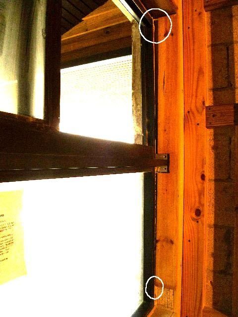

I had someone installed an aluminum window that's 60" wide by 48" tall. The window is composed of a top pane and bottom pane. The bottom is just fixed glass, the top is a horizontal sliding window. This window is located INSIDE a shower and facing an interior privacy courtyard.
I hired a window installer to install it several months ago and at the time I didn't see any problem.
Now that I am getting ready to install cement boards around the shower area walls, and putting up wood furrings around the edges of the window I see a problem. The right edge of the window is not plumb. The left edge seem to be OK.
Now the operation of the window is OK, the top window does slide back and forth OK. My concern is whether this will cause a problem when tiling later. The top edge of the window is out of plumb but about an inch. That's quite a bit over 48" of length right? It's visually noticeable.
This is from the outside. You can see the top edge is slightly narrower than the bottom edge.

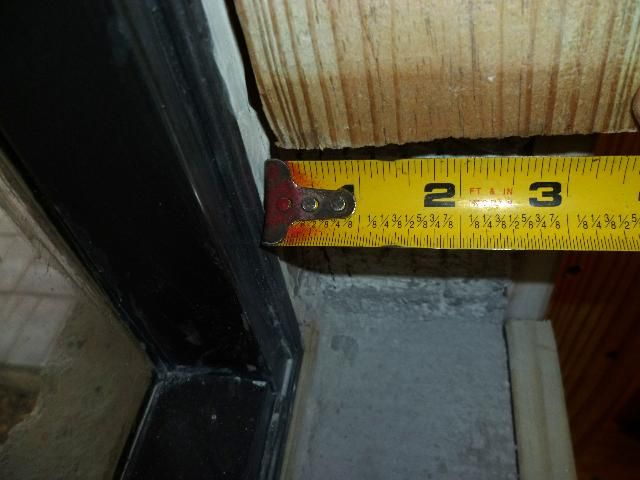

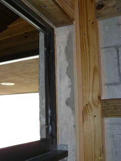

Now look at the inside, the top right:

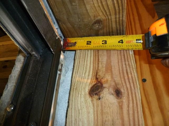

The bottom right:

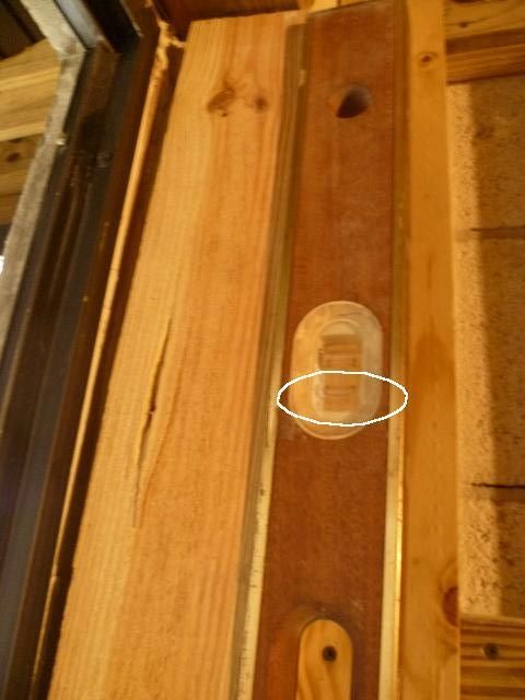

If I attach a piece of 1x4 along this vertical edge and set it to plumb you can see the top is over an inch from the window edge, where the bottom is touching.
and if I put a level against it you can see the 1x4 is plumb.
I think this much difference when I attach a strip of cement board over it then tile, the top edge has to be cut a whole inch wider this is going to be a problem.

Thanks. It is not plumb to the outside wall or the inside wall.
The first picture shows the outside wall and the window and you can see the space between the window corners to the outside plane of the exterior wall the top edge is narrower than the bottom edge.
On the inside, I put up a 1x4 just as an illustration and set it to be flushed with the edge of the wall again, and shows the upper edge to be 1" further out then the lower edge.
The exterior wall surface is plumb for the most part, but irregularities of the stucco made it difficult.
The interior face of the concrete wall is also plumb.
The only thing that is not plumb is the window frame. The problem is it's obvious it's crooked visually, and only on the right side.

Well, try your best to get him to come back and look at it... It most certainly "is not within tolerances" if the walls are plumb and the window is not.
