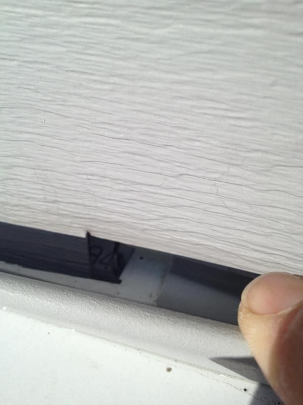

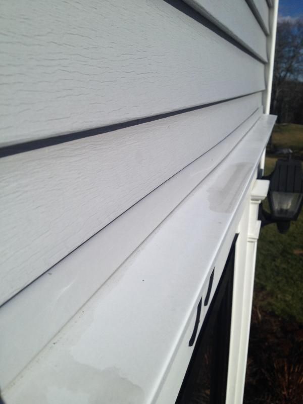

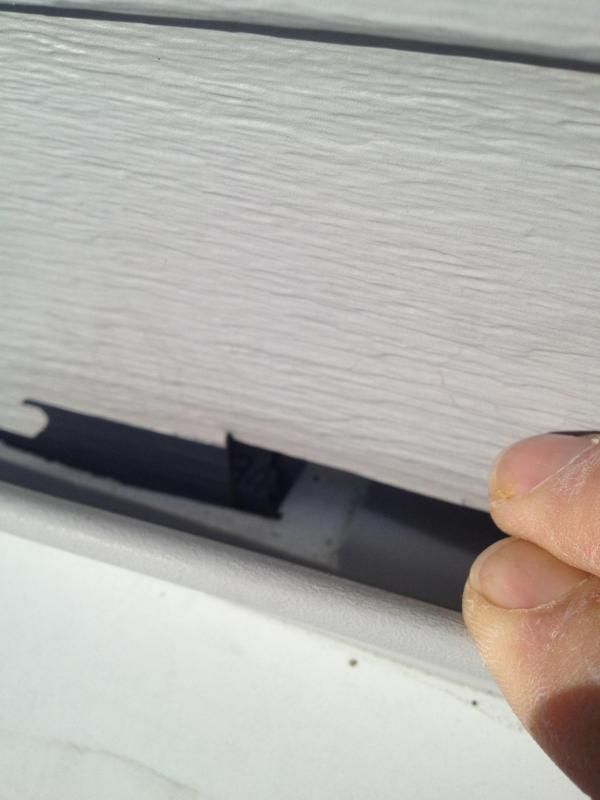

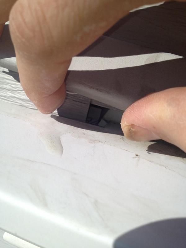

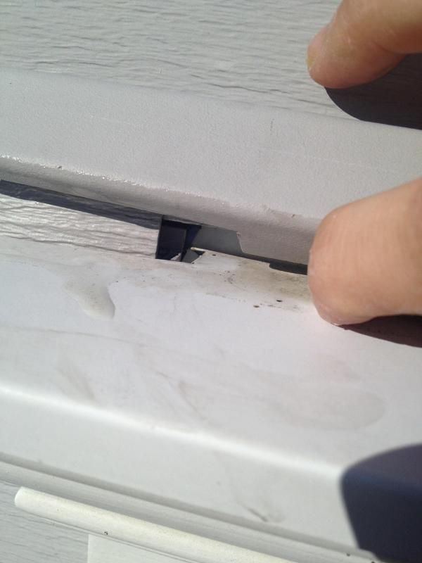

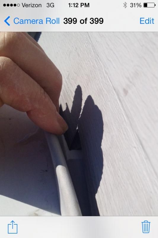

Figured I'd update this thread. Was having some water leak into the basement down the sheathing and onto the plate on the foundation. It's coming from upstairs around the corner of the door. I took some pics at the top of the door behind the j channel and found this.
[URL="[URL=http://s286.photobucket.com/user/moreira85/media/Mobile%20Uploads/image_zpsa614a7c4.jpg.html][/URL"][/URL
[URL="[URL=http://s286.photobucket.com/user/moreira85/media/Mobile%20Uploads/image_zps1c743b57.jpg.html][/URL"][/URL

I can kind of see a notch, but can't get a good feel for where that is located in relation to anything. I'm guessing it must be at the ends of the head flashing where the ends of the crown moulding head piece extend 1 or 2" out over the face of the siding. If so, that in itself is not a problem if everything under it was done and lapped correctly.
Water gets behind vinyl siding in many places and it is not a problem because the WRB is the primary barrier that protects/prevents leaks. If you have a leak it means the WRB is compromised somewhere, not lapped correctly, or not extended far enough below the sill plate.
9 times out of 10 water leaks come from the bottom corners of the door where the vertical j-channels end. I was just leaving on vacation when you posted your pictures on 11/29 and missed a few days worth of posts. But in looking back at those pictures, I don't see anything that's suspicious, and I also don't see any pictures of the siding on the left and right sides of the door. You seem to be looking on top... I would be looking on the bottom left and right corners. (Maybe post some pictures to the left and right of the stoop. Identify on the pictures where the leak is being seen inside, in relation to the door. Pictures should be back far enough that we can get a broad sense of what you have. Closeups don't always help.)
You can easily remove vinyl siding so I would unzip the siding at the bottom. Sometimes when you do that, the problem area becomes obvious (like a horizontal j-channel that is dumping loads of water out the end). If it doesn't seem obvious, slit the WRB and see if it is wet behind the WRB. if it is, you know the problem is higher up.
We can't be there to do the detective work, but you can, so that's the best advice I could give on where to start. Get yourself a Malco Sideswiper unlock tool and get to work. Start at the bottom, see what you find and work your way up. If it's dry behind the WRB and you can tell the sheathing has not been wet, you know that area isn't the problem.
Doing this as soon as possible after a leak is best, because once it dries out it becomes a lot harder to find the evidence.

The pic is the top left corner j channel
Old 01-12-14, 12:06 PM
XSleeper's Avatar
Join Date: Dec 2004
Posts: 20,508
Yeah, that's what I thought.
