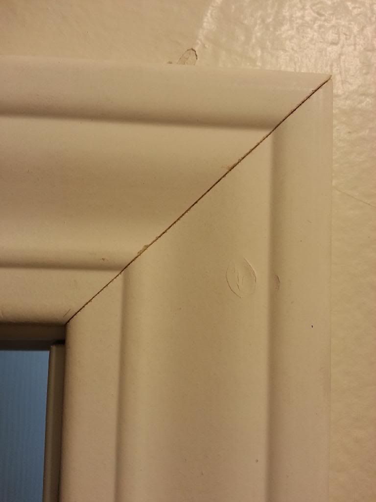

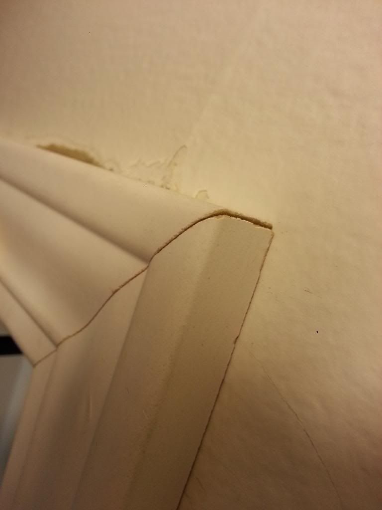

Can this joint be better?
I'm putting in new interior doors in my house and now I'm starting to trim the doors. I cut a few pieces to 45 degrees and they seem to fit together well, but I've never done this before, so I need validation :-) Is this joint good or can it be improved? The molding is pre-primed MDF and I plan to spray paint it after I have all the pieces ready. I think that the line should be almost unnoticeable after painting. I could even touch up the joint with some paint after installation to make it even less visible, if necessary. The slight gap on top can probably be closed by putting in a brad nail from the top. What do you think - good, OK or bad?
I'd check your saw and cutting technique. MDF can flex and squirm during cutting, more than solid wood. Clamping close to the cut might help.
Cut two pieces of hardwood and see if they exhibit the same gap. If so, saw needs adjustment.
Yes, the joint could be a bit better but it isn't bad!
Looks like that old crack in the upper right hand corner could be kicking your top piece out just a tad, so, if you haven't, you might try working it down a bit. Otherwise, as Gunguy said, it isn't bad. Keep your saw table dusted off, so you don't get a build up behind the stock, and, if you have closet interiors to do, that's not a bad place to start, until you work the bugs out. To Gunguy's point, saws need to be checked periodically for proper alighnment, etc., and, if you're using the blade that came with the saw, it might be worth considering a new one, because they don't always put the best blades on them at the factory.

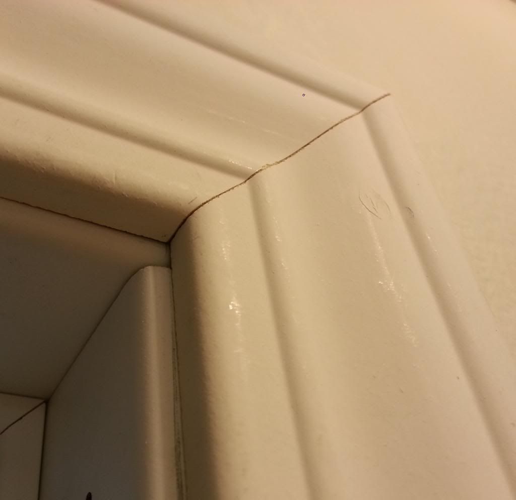

It looks good, but would probably be better if you had a better blade. All the microchips along the edges of the miter tell me that the blade is vibrating as you cut, either as you cut down or as you bring the saw back up. A better trim blade won't do that. Course it could be the saw too.
Cut slowly. Then after a cut, leave the saw down until it stops spinning. You should also be gluing those miters together. Titebond makes a moulding glue thats nice and thick and after you wipe it down with a damp rag, it works good as a filler. You should note that nailing the corners together will sometimes split the MDF. It doesn't like being nailed that direction. You are right that it will look good after it's painted.
If you spray the woodwork you'll need to do an extra neat job of puttying the nail holes. Sprayed enamel will accentuate any flaws in the woodwork while brushing can hide minor flaws.
Three cheers for Marksr as caulk is the only way to close the gap in a PFJ/MDF installation. Very curious as to why the OP would want to spray the trim? Makes no sense, as the amount of masking that would have to take place would more than chew up time involved to brush on two coats.

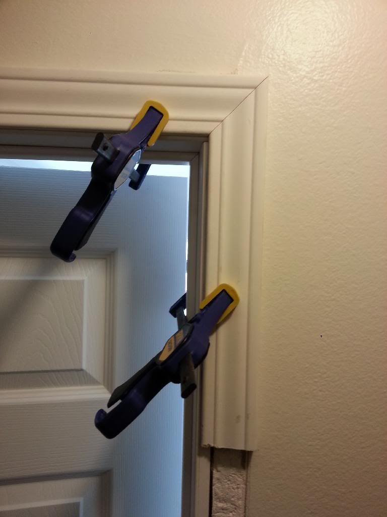

The trim need to be installed by installing the top piece first.
Then the sides.
You have no nails in the top or side of the trim where the two pieces meet that needed to be first to draw them together.
Then you install a nail about 6" down into the jamb.
That joint has to be nailed tight before working on nailing down the sides.
You only need 3/16 exposure on the jamb. To much and there's not enough left to nail to.
Looks like you used a blob of caulking to fill the nail holes. Using painters putty, or fast and final patching compound will not shrink or leave that mess on the surface.

If you look at the picture there are clamps holding the short pieces of trim which are test pieces. The MDF probably came that way, preprimed. Always scuff sand it before painting with 150 grit or similar. (3M sandblaster sanding sponge works best on that profile)

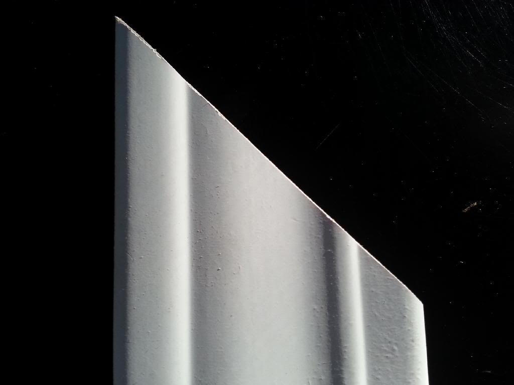

To clarify, I have not installed or nailed any pieces yet. I just cut the top piece and clamped down two scrap pieces on the sides to see how things fit roughly. When I start installing, I will nail the top first and I will glue the pieces together as I go, but right now I simply want to get the best fit possible - baby steps. Glue and caulk suggestions in this thread will come in handy later. Also, I am not going to spray paint the trim in place. The plan is to measure and cut all the pieces, then spray them elsewhere. I am casing 6 new doors, so spraying instead of brushing should save me some time and will look better. And finally, I am using spackle to cover nail holes. It seems to work OK, but isn't the easiest thing to cover up.

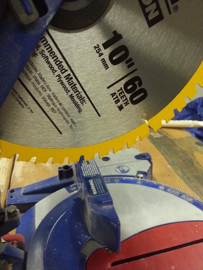

I'm using my father's miter saw (photo 1). It has a 40 tooth 10" blade - probably original equipment. It's a safe bet that the saw has never been checked for alignment. I'll try to figure out how to align it. I found a 60 tooth blade laying around in my garage, left by a previous home owner (photo 2). I may try using this blade to lessen the chipping.
I tried the cutting techniques you guys suggested - clean the work area, cut slowly, then stop while the blade is still down. I still got about the same amount of chipping (photo 3).
I also cut two pieces of scrap laminate at opposite 45 degree angles. They exhibit the same chipping and the same "veer" on top right (photo 4). Does that mean that the saw blade is not aligned correctly?

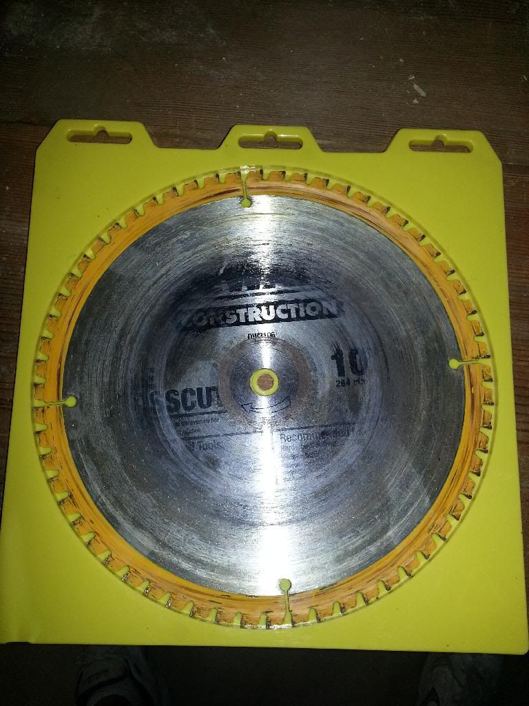

The blade that's on the saw now is a 40 tooth carbide, suitable for rough cuts. The other blade you have pictured is a Dewalt 10" 60 tooth "fine crosscut" blade, which- if it's sharp- will do a better job of cutting than the other one. It's no 80 tooth, but it's better. As mentioned, an 80 tooth will give you the best cut.
The saw... well, that could be the other part of the problem. Once you change blades you will have a better idea of how it performs. A $99 saw isn't going to give you the same results as a $599 saw, so don't expect perfection from your dad's saw. You could buy an 80 tooth blade and have the same/similar results if the saw has a vibration. You're doing paint-grade work which is the most forgiving, so I wouldn't sweat it too much. If you were nailing together those sample pieces that are pictured on the bottom- all stained and finished wood... those joints might not be acceptable. Just depends how picky you are.
The "veer" can be from a dull blade... or it could be the saw. When cutting, if the saw has to labor to get through a cut, it will usually push the blade to one side or cause it to vibrate. The hinge of the saw could be a bit loose as well. If you can see or feel any wiggle in the saw and can wiggle it either left or right as you operate the saw up and down, then it's not really tight enough to do fine work. Like I mentioned, your more expensive saws will just be of better quality and have tighter tolerances. But don't sweat it, I think those miters will paint up just fine once you glue and/or caulk and paint them.

Getting back to the original question, your crack is no more or less than that of the factory window trim, which you will need to caulk anyway (or painter's putty), so I say you should be just about through by now. Never cut laminate from the top. Always cut from the bottom, then kiss the blade goodbye for any other fine work. Laminate and trim aren't uttered in the same blade breath.

I replaced the 40-tooth blade with the 60-tooth one. It seems to cause the same amount or maybe slightly less chipping. I also sawed through a 2x4 to check bevel alignment. I was cutting slowly, but about half way through there was a lot of smoke and I had to stop. Does that mean that the blade is dull? Anyway, it works OK on my MDF trim. It looks like a new 80T blade is about $50, so I decided to make do with what I have and use caulk to cover up any imperfections, as some of you suggested.

Just picked up this DeWALT blade for $30 at Lowe's. Hopefully it'll give me nice cuts. Also got some White Lightning caulk. I'm curious to see the difference between Alex and White Lightning, so I'll try both. Thanks for all your help and Happy Holidays!

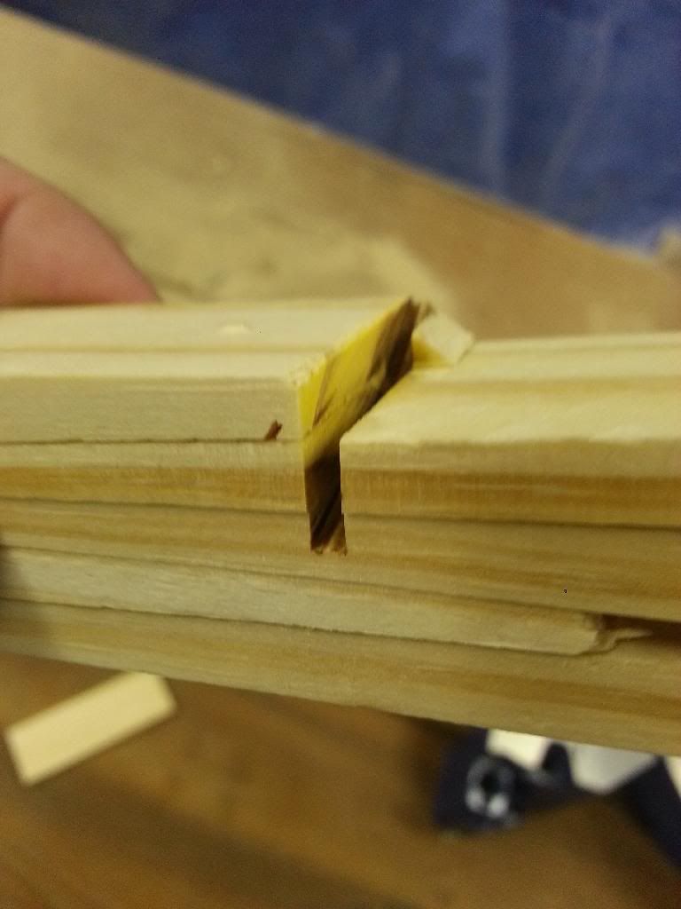

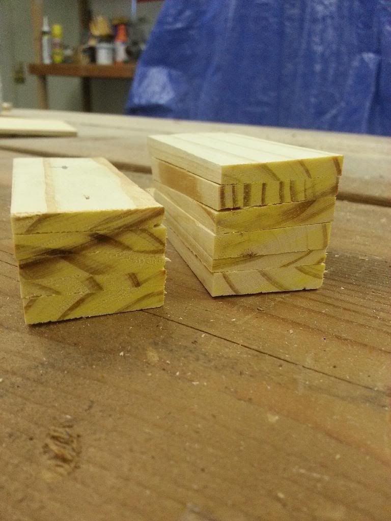

Oh man, I just tried cutting through a few wood shims stacked together and it started smoking. Some of the teeth started turning black. It couldn't be the blade or the material. Is something wrong with the saw? It seems that the original 40 tooth blade is the only one that will cut through anything of any thickness. I think I stopped early enough to not mess up the blade.
Some of the teeth started getting black.

Yeah, I'd say the blade isn't running right. I've only got a 10" as well and it will cut a 2 x 4 or a couple of stacked oak 1x2 w/o smoking or slowing, even with a 60T blade.
You do have to let the saw and blade do the work. If it bogs or slows, you are trying to force it or it has a problem.
Do you have an inner and outer washer on the arbor? Pretty sure most saws have them.
Any chance you have a dial indicator? If not, you should be able to clamp a block beside the blade and visualize any wobble.

I think it was a false alarm. I finished cutting that stack of shims at normal speed and there was no smoke. I also made a test cut of the MDF trim and I see less chipping, as expected.
Original stack on the left and a new one on the right.

My guess is that the blade is wobbling, causing vibration. Cutting slow might actually be allowing more time for this vibration to set up, getting incrementally worse as the saw runs. If you cut a piece of wood, and examine the cut, you should not see a bunch of saw blade lines on the end of the cut... it should be smooth. If there are lines, that's usually blade wobble.
As others mentioned, you can check this by clamping a piece of wood next to the blade, then by carefully turning the blade by hand as you examine whether or not the gap between the blade and the wood stays even. If the gap opens and closes as the blade turns, that's wobble. Sometimes it will check out when checking by hand but will vibrate only at high speeds.
At any rate, if you have it figured out and the cut has improved, then you done good.
