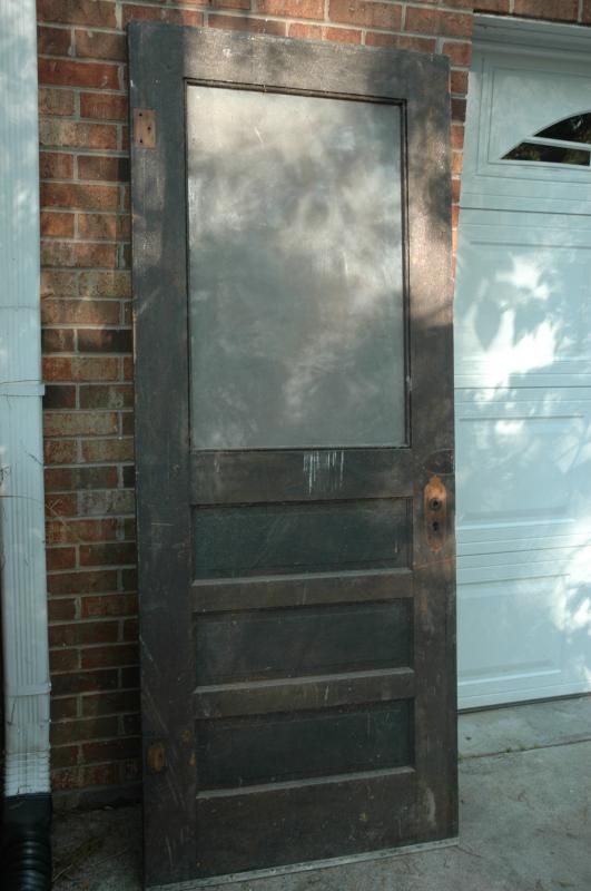

Well, finally got it done - I'm slow but I'm sure.
Here's the original:

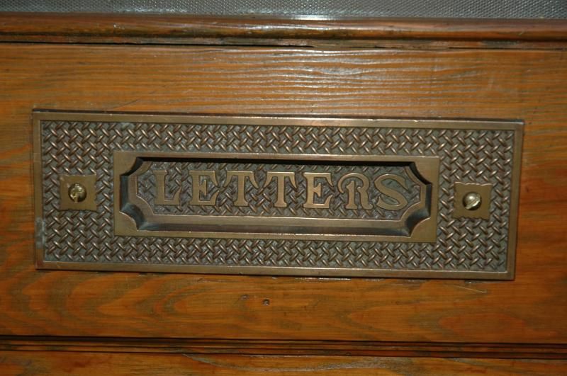

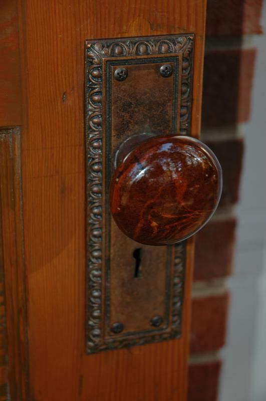

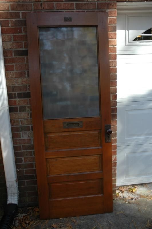

Here it is after trimming both sides, stripping, staining, addition of vintage escutcheon, Bennington brown swirl porcelain door knobs, vintage letter slot, and vintage door number rescued from old old razed convent. Just need to decide what to put on the semi-opaque wavy glass and my man cave is ready to roll.

Very nice. Thanks for letting us see it.

That really REALLY looks good! Fine job.

Have you installed it yet? Interested in seeing in action. Finish job is excellent. Congrats.

Looks good! did you remember to put a coat of poly on the top and bottom edge of the door?

Door is on - finally. A long and winding road made much more difficult by my lack of experience with this kind of thing. Never hung a door before, let alone cutting it down and reversing the swing of the door and cutting the mortise and . . . well, definitely a learn on the job experience.
