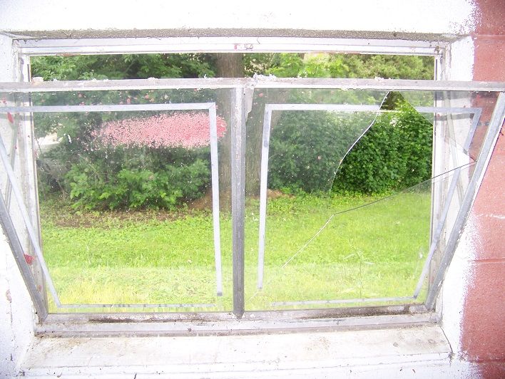

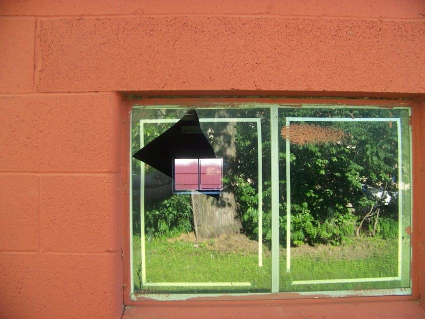

Hello. I need a quick patch job. The whole window doesn't need to be replaced. It's a cheap garage window. Would be nice if we didn't cover the whole window though because nice to have the little natural sunlight that we get from that window. Here it is:
Thanks!

Am I not seeing this correctly? I see a window with a black triangular patch on the upper left side and what looks like a photo on top of it. Or is it a window with a picture painted on it that is broken in the left corner?
What's wrong with it? Do you want to replace the glass? Is it suppose to open? Do you want to board it up? Do you want to trim it? The white tape around the edge, is that former security tape? You need to give us more info and another picture.

Is this picture inside, outside?
What do you mean by a patch job?

I'd hazard a guess that there's a triangular portion broken out. The landscape is a reflection behind the picture taker and what appears to be a window in the broken area is on the other side of the garage.
That's my guess anyway. Not sure about the white lines on the glass...old alarm system maybe? Or just some sort of decoration?
If the window has a sash that opens, the easiest thing would be to remove the sash and have it reglazed at a glass shop. If it doesn't open, they can do it onsite but it will cost much more.
You can do it yourself by removing the rest of the glass, see how it fits in the opening in the sash and getting a replacement cut, then glazing it yourself.

OK, Vic, your take seems to make sense. It's a pic taken from the outside looking in. And the small fence pic is another window on the other side of the building. Just could not get my head around it.

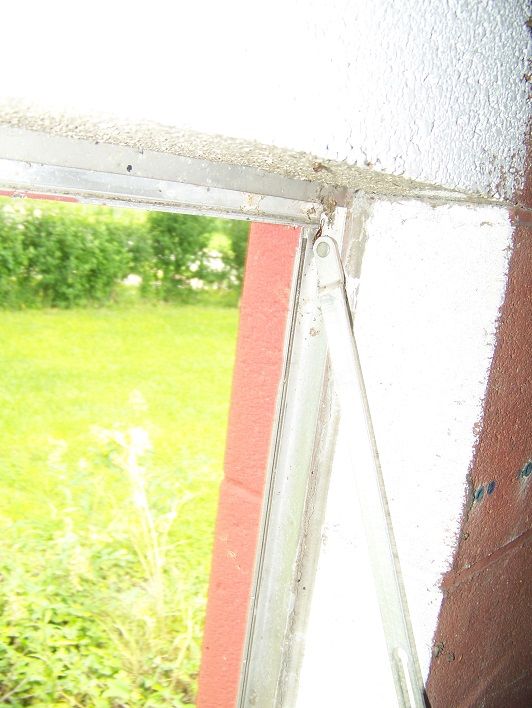

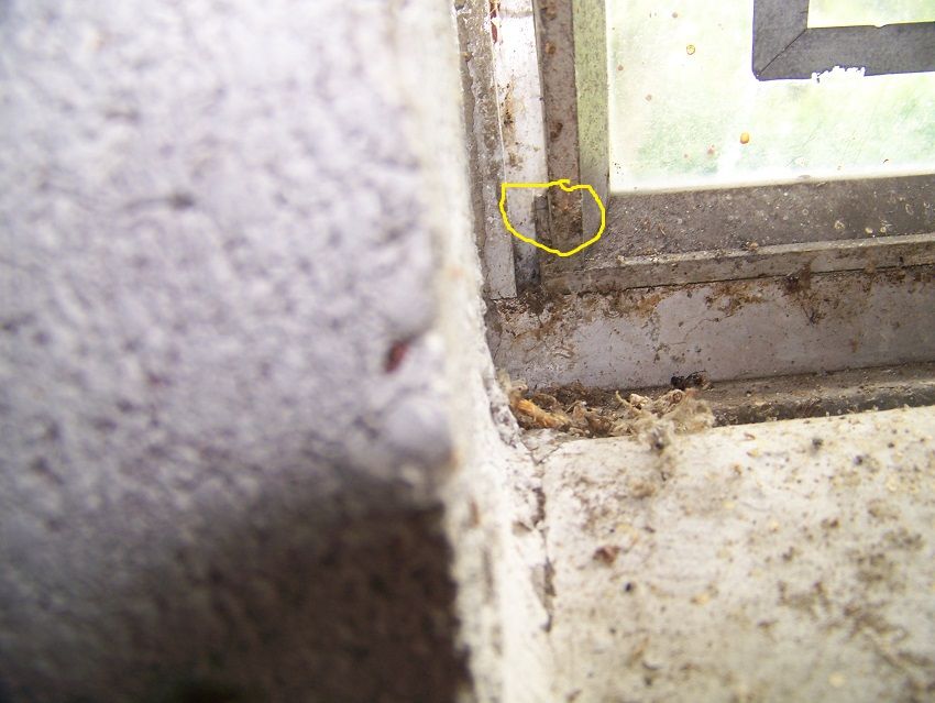

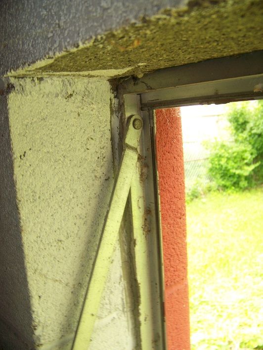

I am standing outside the window. There is a triangular opening in the window. The other, smaller, window is on the other side of the garage. The vegetation is behind me and reflected in the window.

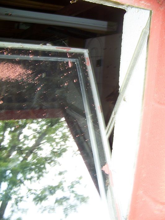

The owner wants the glass replaced. Here are some more photos of the window.
Inside:
Right arm (from inside):
Left arm (from inside):
Right arm (from outside):
Left arm (from outside):
Bottom right:
Bottom left:
How do I get this glass fixed? Trying to do as much as we can on our own to keep costs down and avoid service call fees. Thanks.

I hate to be the bearer of bad news, but these types of windows are a pain to fix. If the hardware is able to come off without breaking then it will be OK. But when their old and rusted they usually break. Not sure where to get replacement clips and hardware. I can't quite tell but is the glass held in place with clips or is it glazed in?
Old 06-26-15, 05:48 PM
XSleeper's Avatar
Join Date: Dec 2004
Posts: 22,707
Upvotes Received: 126
You can unscrew the arms from the sides of the sash, then if I recall, you hold the sash all the way open 90 and tip the right side higher than the left until those pins you circled in red come out of their guides.
I think this window has interior aluminum glazing strips that cover the spring clips which keep the glass pushed out tight against the external glazing. IMO, if you can get the sash out, your best bet would be to take it to a hardware store or glass shop so that they can repair the glass for you. Cut a piece of plywood to stick in the window in the meantime.
If it doesn't have aluminum glazing strips, then it is some really hard glazing that is wider than normal and is almost like cement. A real pain in the wazoo to remove, it takes a heat gun and some patience. And there are spring clips embedded in the glazing that you won't want to lose. The spring clips keep the glass tight until the window is glazed- you need both. Either way, if you can take the sash out, take it to a repair shop and they will fix you right up.

I'm thinking he doesn't even have to unscrew anything. See how the slot in the arm has a larger opening at the top?

Yeah, Vic maybe you're right... the bottom of the sash may lift up and out of it's pivots by tipping it slightly left and right, then once the bottom is out,tip the bottom of the sash toward you so you can lay the sash parallel with the arms and then as you raise both sash and arms overhead, the sash will slide forward on those arm guides until it stops... at which point they should pop off by slipping that enlarged part of the slot over the slot guide.
Buy a piece of thin Plexiglas and adhere it over the broken glass with clear silicone sealant.

That would be easiest. Heck, for that matter, you could just use glass. The problem would be you'd still have the hazard of the broken pane.
If the sash comes out like several of us think it will, it would probably be less than $50 at any repair place.

Those windows actually come out of those arms. Broke the glass a little more but at least got it out. Will need some goggles and gloves in case something goes wrong putting it in. Don't want a cut or to lose sight. Any suggestions on gloves and work glasses? Price IS an object.

Like you said, the arm has a slot with a larger opening at the end. You pull the sash out like you opening the window, raise it up, and slide the sash out one side at a time. Getting it out is pretty straightforward. Getting it back in is a little more complicated. I actually broke more of the glass getting it back in.

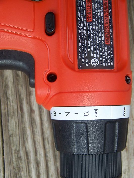

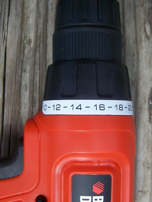

Here's my drill. You see these numbers and pictures that, presumably, determine the power of the drilling.
Which one of these settings do I use for drilling through cinder block? Also, which one should I use for screwing in the concrete screws?
Thanks.

Just as the picture says. The drill for drilling holes and the screw for screws. The numbers are a torque setting that you can use to prevent stripping the screw heads. Lower the number less torque and the drill will ratchet. For drilling you will usually want full torque. You will use anchors to secure the wood to the cinder block. The hardware store can show you several types of anchors to use. If you can find a small hardware store as opposed to the Depot or Lowes, you'll get better advice on what drill and anchors to use.
Before you start get a scrap piece of wood and experiment with driving screws. Most likely you will use Philips head screw but use a square head driver for them. If the wood is hard you will use a higher torque (larger number). Softer wood or thin pieces lower torque.
You're asking very basic questions but that's OK. Just a few times with working with power tools and a few mistakes and you'll be an expert in no time.
Seriously, don't worry about making mistakes. Even experts get it wrong sometimes but that's how we learn. You already took the first step by asking for help in this forum.

When you drill a hole with a drill bit, you match the drill bit picture with the arrow, because the clutch (which allows variable torque) will never engage when you have it set on the drill bit... it will be maximum torque.
When you are turning a screw, you put it on one of the numbers. A low number like 1 will provide low torque, while a high number will provide high torque.
It is also not a hammer drill, so you should not be using it to drill through concrete.
