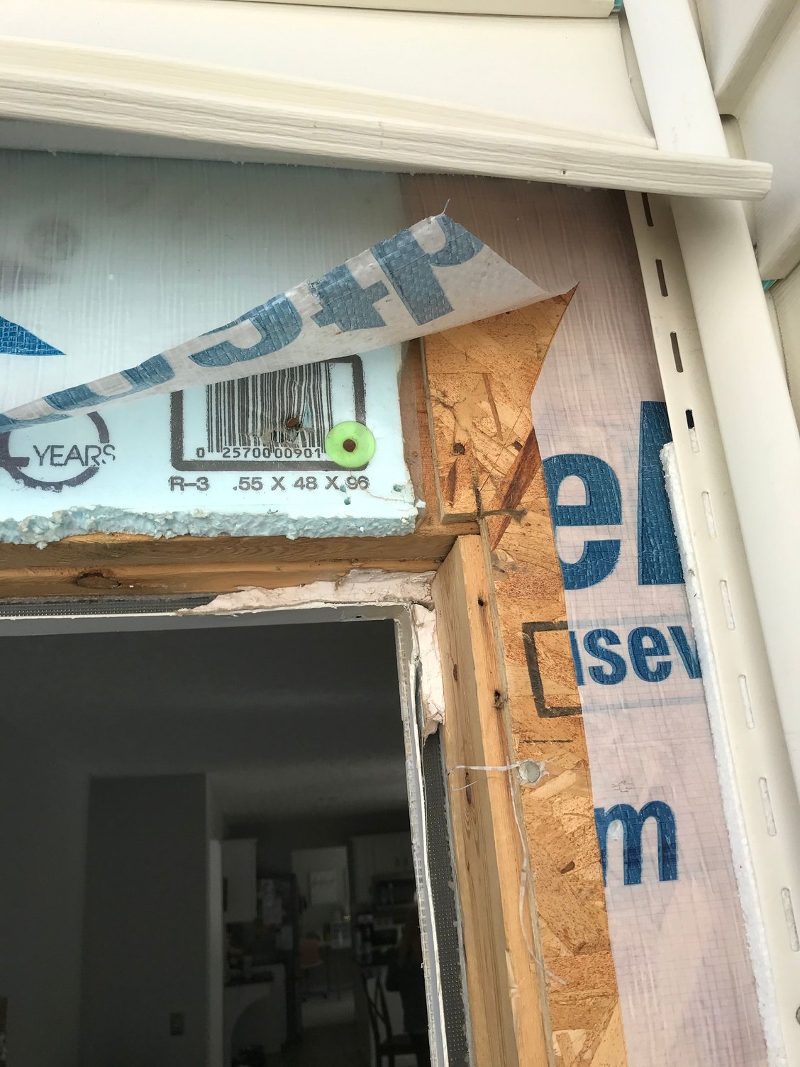

Hello All - I've been DIY'ing - out of financial necessity and enjoyment - forever and can't believe I'm only now finding this forum. Just wow, the Internet constantly amazes me how many generous people there are in the world.
The question: I'm looking to DIY replacement windows and trying to decide between new construction and replacement windows (sometimes called "pocket", but basically fit inside existing frames). I plan to still get mid/high quality windows with low e-glass, 2 or 3 pane, gas filled, etc. Some other research (Reddit has a few great threads on this) tells me that the mid-higher lines of Crestline (Menard's) and Reliabilt (Lowe's) are both solid choices....but brand is less important than install and trim process.
Background details: Two story home built 1993 in Ohio. 24-25 windows I think, all but a few of existing windows are single-hung Acorn brand metal frame (aluminum I think). House has newer, insulated vinyl siding so residing it not in consideration. Windows on front of house have wood trim as perimeter and vinyl siding butting up to that. Windows on sides and rear have vinyl J-channel butting right up against (and caulked to) side of window).
My thinking on New Construction windows:
Pros: By far the biggest for me is not messing with exterior trim wrap. Works for all but 2-3 windows. Can be positive about good seals to house wrap. Cheaper per unit generally. Could even build up rough opening to fit a stock (cheaper) window size. I have all the skills, tools, experience here - but more work per window and I really HATE heights.
Cons: working from exterior of home involves heights and complexity for 2nd story. Longer and more work per window with sealing and trim reinstall, paint, caulk.
My thinking on Replacement Windows
Pros: Faster, install from inside, generally find more higher end window options on replacements
Cons: Never worked with trim wrap (vinyl coated alumnium) and would have to fashion a DIY brake to mold it. Not positive of size needed and condition of existing window frame. Unsure how/where to caulk everything to maintain water tight to building envolpe AND trim wrap. Acorn metal frame single hung windows are supposedly tough to remove, could be a rough sawzall around the edge.
Bottom line: I'd love to do Replacement Windows, but how & where to do the aluminum wrapping is giving me a lot of pause. New Construction I know I can do, but will hate the heights and it's a much slower/longer process with all the extra work of cutting back siding, new j channels, and new wood trim.
Skills and tools: I would say I'm somewhere between a weekend warrior and a low-end professional in terms of skills. I've installed about 5 rooms/showers/backsplashes worth of ceramic tile, built decks/fences/swingsets, built-in shelves, relocated a laundry room including all mechanicals. All that is probably nothing for this forum, but what I'm trying to say is intermediate DIY skills are covered between myself/brother/dad.
Thanks to anyone who can offer anything - especially about exterior trim wrap for replacements!!!

I really don't think your windows are candidates for replacement windows at all. You will need to do new construction. And personally, I would order every one custom and not reframe anything.
That way every window should have the same formula if you measure your existing windows outside. Then remove all the interior trim and double check that those measurements will give you at least 3/8" -1/2" of room in the rough opening on each side on the inside.
If you dont already have a couple 24' extension ladders, but them. Then get yourself a pair of Werner ladder jacks. You can lay a plank on them. Easy peasy.
You will want all new j-channel around all your windows in all likelihood unless you happen to get windows exactly the same size as the old ones.
You could use Boral or Azek trim... both hold paint really well. L.P. Smarttrim is okay. Or vinyl brickmold. Avoiding wrapping with trim coil is my recommendation. You don't have the right style windows that need wrapping.
The windows in the brick.... you might want to make them 4 1/4" smaller than the brick opening so that you can still use the nail fin and then surround them with vinyl brickmold.
Dont get a brown window unless you go fiberglass.

Sleeper - Really helpful perspective....gives me a lot to think about. Thank you. I'm going to respond to pieces and parts because I have questions.
"I really don't think your windows are candidates for replacement windows at all."
Are you saying that because of something specific to Acorn, or the frames themselves, or the single hung? Asking because as I demo that first test window I'm wondering what I should be looking for to determine if replacement windows would be workable in the rest.
"Easy peasy"
For you maybe, haha, but carrying a new construction window up 10-15 feet and heights in general is not my cup of tea. However, I did do some research of ladder jacks and I think I could get comfortable enough. Might even spring for the wide stabilizer arms but we'll see.
"order every one custom and not reframe anything"
I'm wondering why not.....Most of my ROs are approx 36w x 60h, which I think is a little on the larger end but what do I know. I'm not in love with any one brand or retailer - and have reconsidered Crestline and Reliabilt after some additional research. That decision comes later. But since I'm going to wrap with new wood trim around each window (in the 3-5" wide range), what is the harm of slighly adjusting the RO. Anything other than less glass that I'm not considering?
"Dont get a brown window unless you go fiberglass"
Curious about why not....something wrong with biscuit or tan colored vinyl. I was almost certainly going to do white vinyl inside and out for cost reasons. I'd love to go fiberglass....especially the Pella Impervia black exterior/black interior, but I think those windows are in the mid $400's.
Last topic to cover.....One of my neighbors down the street got windows a few years ago....vinyl replacements of the same old Acorn single hung window. Looks like their trim is some sort of standard trim kit coming from the frame into the edge of the replacement window, and then vinyl/aluminum wrap for the outside perimeter. I could probably achieve the coil brake cuts and angles for the exterior pieces, but I think the inside pieces are a special vinyl trim kit specific to those windows. A picture of his window is attached.
Thanks again........can't tell you how much I appreciate all this.

A replacement window goes in an existing frame. Once you tear your old windows out, there is NO FRAME LEFT, just your rough opening. And putting a replacement window (the ones in your photo don't have nail fins) in a hole and caulking it in, like you show in the last picture is a real poor install. You use nailing fins to install windows, they are your flashing and incorporate the window with the WRB, your housewrap. Any window installation that relies on caulk to keep water out is not going to last long.
Custom sizes = less work. Maximum glass.
Brown is brown. Like the crayon. Brown is not biscuit or tan. Dark colors get too hot and even if some companies sell a dark brown vinyl window I would not trust it. Fiberglass can withstand the heat.
If you are even considering Crestline you should think again. (Biting my tongue) Your neighbors windows (the windows themselves... not the install) look decent. They remind me of Softlite Pro series / Gorrell 5300 series, which are decent windows. (Softlite bought out Gorrell a few years back.)

Man, can't thank you enough. Makes a lot of sense. In all my research, I really could not find a video or picture where my style of existing frame was getting a replacement window.....so this gives me some definite reassurance about pursuing new construction.
Yeah, my neighbors windows are very nice. 3 pane, gas filled, low e glass coating. I think he paid $800-1000 per window though and I have 26 windows.....so no can do.
Hear you on Crestline. I should not have even mentioned brand names as I'm not even close on that end yet.....lot of reading left to do. If I can afford fiberglass, I will be going that route but otherwise and likely white vinyl.
I will post some progress pics and feedback as I get into that test window......especially of the existing window frame demo. Thanks again.

Well, due to a lot of life and job and money circumstances, the 1-window test did not happen last summer......but this virus quarantine has a new list of projects being revisited and the window test made it.
No pictures yet to post, but have refined my thinking about a plan for the 1 window test:
First, I've decided on a window that faces my neighbors house and isn't visible from back or front of the house. And there are no windows on this part of my neighbors house, so it's truly the most out-of-sight. the window is also ground level, bottom starts at about 4 feet.
Still plan to try to do the whole 1-window test on a plank to simulate working on ladder jacks and a plank in between for the 2nd story. I strongly suspect the ladder jack comfort level to be a solid NOPE.....so I've already looked into a 3-level stack of scaffolds. There are occasionally some for sale secondhand via Craigslist, and I'm about 95% on going that route and just selling them afterward.
Completely agree that new construction is probably the long-term peace of mind solution, so I can incorporate into the house wrap. Just for pure price on the 1-window, I'm leaning toward the Reliabilt 455 series in a stock size. I don't precisely know my RO size yet, but I think it's really close to 36w x 60h.....hoping so. Will find out for sure when I demo the interior window surround which is currently drywall. I'm not married to Reliabilt for the rest of the house though, and this window has a down/closed blind on it 100% of the time so there is very little downside to having a different window than the rest of the house.
Also, thinking of buying a small battery powered 4.5" circular saw for cutting into the vinyl siding. From what I've read, it works well and especially well if you mount the blade backward so it cuts by friction instead of with the sharp teeth (worried about cracking the siding).
Last point of new plan is about reinstall: Planning to cut say a 4" perimeter around existing window into the siding (but not so deep as to cut into the house wrap hopefully). Then do all the demo of existing window via the nail fin. Then when I go to reinstall, I get the window installed and sealed up into house wrap......and then thinking install J-channel first all the way around ideally lining it up parallel with window edge all the way around. This might be tricky as I'll need to slide j channel in behind siding and secure it somehow. Maybe there is a product for this that's similar to vinyl J channel, dunnno...will look into it. Anyway, with window installed and a nice perimeter of new J channel, all I have to do is rip some azek/boral per Sleeper's recommendation above. Probably would paint on the ground and then install....dunno.
that's all for now. not as good as update with pictures, but this is a badly needed undertaking that I haven't been able to get going until now.
Any and ALL thoughts are welcome!!!!
Marq1 - I keep thinking about that.....but definitely concerned about my ability to cut siding close enough and get it right. Margin of error and just not knowing enough about what's behind there and how window j channel orients to existing RO.
I wasn't planning on taking down all the siding pieces all the way around, so if I went that way.....I'd have to figure out how to hold all that siding out of my way while I install the window and work into house wrap. Even demoing the existing ****e window would be trouble I think.
but the more I type this, the more I think maybe taking siding down all the way around is a really good idea. easier to cut....can really measure twice, cut once after I've got the window re-installed. No need to cut siding in place, mess with or spend $$ on new j channel, and no need to rip/paint new trim. Love it the more I think of it.

If you get integral j channel you have to remove all the siding around the window in order to remove and reinstall the windows.
Generally speaking your new window sizes should be exactly the same as the existing ones as shown in your first post, first pic. Tip to tip. No deductions. Brick openings will obviously be different if you want to use a nail fin. You would want 1 1/2 for the fin on top sides and bottom. These may need drywall work and / or new trim since the new window may be a little smaller than the existing ones.
Cutting the vinyl siding is a good idea... It allows you to get the old window out... Then once the new one is in you can take (for example) a 2" board and slide it along the window edges with a pencil and scribe another line to make an exact cut. Quick and dirty is to shove j channel behind, don't nail it to the house... just use the trim to hold it in place with a few small screws into the side of the trim. If you want to nail the j channel to the house the siding must come off. Wider 4" trim is nice as you can tape the fins to the house better.

On this first trial window, leaning hard toward removing all siding all the way around window, at least for this first one. More prep, but more room for error and evaluation when I get it down to wrap and existing window.
The ones on the front of the house have existing wood trim, so there shouldn't be any siding work. On the brick mold, leaning toward nailing fin and slightly smaller window than existing. Absolutely worst case scenario for me is having a leaking window a few months after taking on this project, so fins and integrated house wrap is worth it.
One plus side, demo'ing the inside drywall surround means I will probably full wood frame each window and paint white to match the new window. I think my wife will really like that part of the finished product.
Will be a few weeks.....but hoping to post pictures next of the 1-window test.

Demo first. As Sleeper said, going with a new construction style window with nailing fin means pulling off the siding all the way around is the best way to be really sure you're going to get that fin behind the house wrap. It's really not that bad with a siding removal tool and some patience.
Another major surprise was what passes for 'builder grade' new construction. My original window was held by maybe 2 nails in the fin per side. No integration with the house wrap, or at least not anything really deliberate.
You can also see the benefit of the scaffold here.....the ability to raise that platform up one level as needed was awesome.
I cut back the foam all the way around the window to get ready to reinstall. That presented a problem later on with fitting the siding into the integrated J channel on the window, but needed some foam cut back so I could open the house wrap and nail in the fin.
Not shown in a photo, but I then demo'd the drywall surrounds on the window jamb because I was going to refinish those out with wood and do a sort of DIY craftsman style on the interior trim. Pics of that coming.
