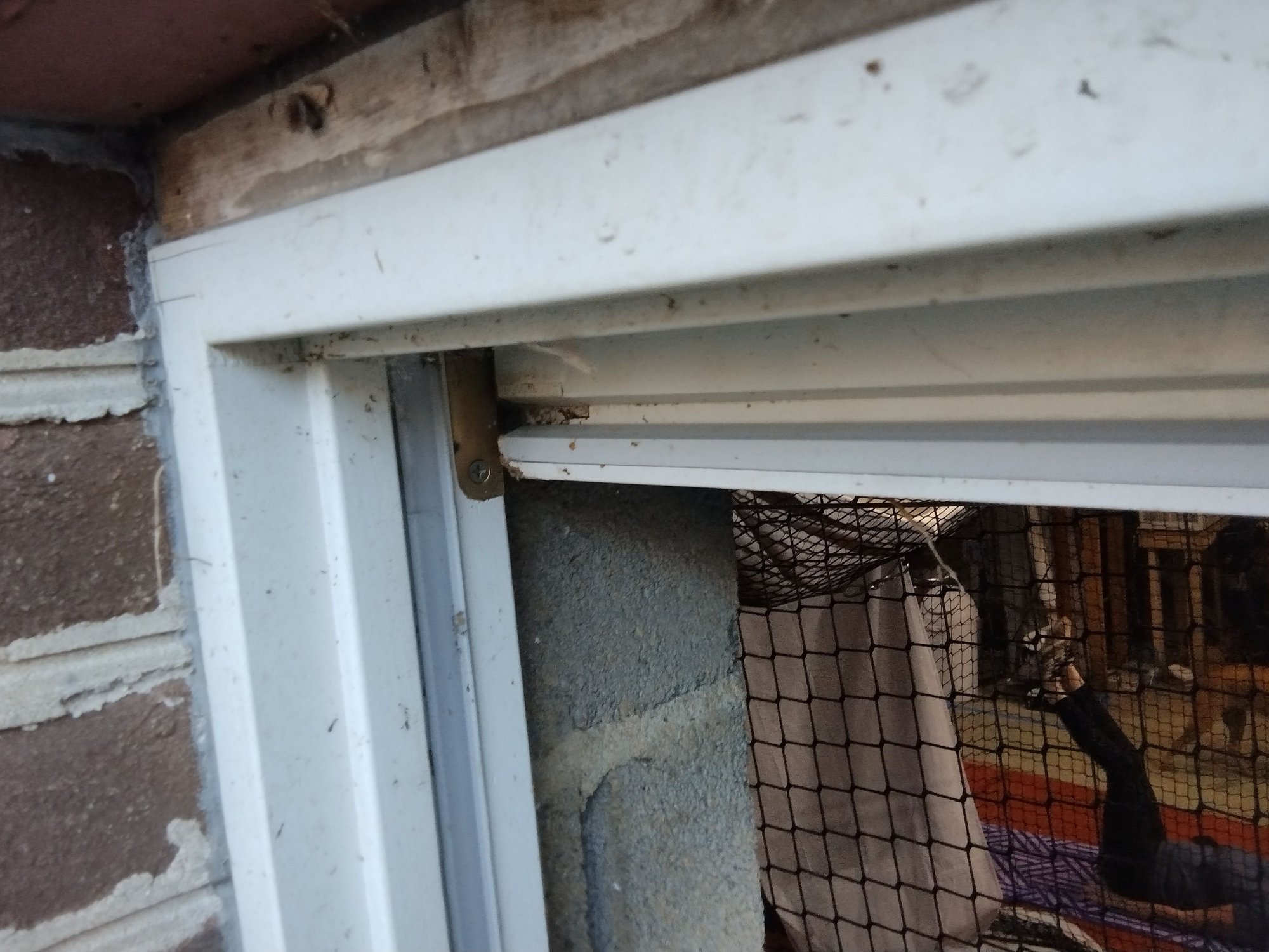

I'm getting ready to finish my basement and want to replace the original 1988 windows before I frame the wall there. When I did this in my last house, I chipped out the mortar that was built on an angle and then built a pressure-treated 1 x 6 wood frame around the windows that I ordered to fit there. It made it easy to frame and box in the windows for a nice finished look.
My questions:
1.) Do I need to chip out the mortar that is on an angle under each window? I'd like to do this (I think) for the extra light with that slightly larger window.
2.) Do I need a PT wood frame around the new window (either with the angled mortar or without it)? If not, how do I attach the new windows to the cinderblock wall?
Obviously, these answers dictate the size of the windows I order.

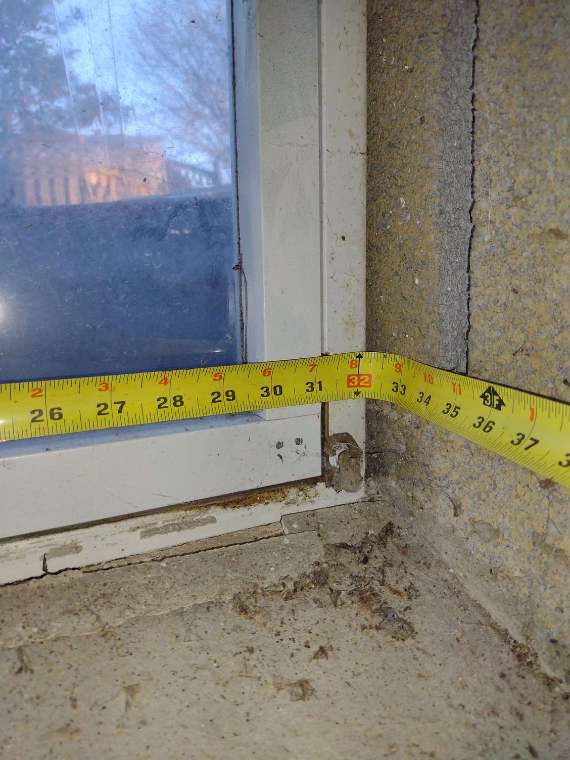

I looked more closely at the windows and realized they're not as bad as I assumed since I bought the house 18 months ago (a complete fixer-upper). They area not metal, like I assumed and appear to be vinyl. It's possible they were replaced 10-15 years ago, as compared to what I assumed (1988 original).
Also, they do not appear to be embedded in the cap. I took a few closeups and some of the cap is actually chipping away.

Future guest room. 2 joists over mud plate and window? Some mortar chipped off of window #1. Exterior of window #1. Installation screws and general condition of window #1. Interior and condition of window #1.

The windows look like Andersen 200s or 400s... Fibrex is what they called it, I believe. Wood wrapped I their fiberglass composite material... or fiberglass paint. I don't "think" they are permaclad... another Andersen line. Look in the corners of the glass for a trademark. Up to you if you replace them. Guess the question is why are you hot to replace them? Give them a power washing and recaulk them. If they aren't leaking, arent rotten, you really aren't gaining anything by replacing them. A new window might have better a glass package but you are talking about the difference between going from R-2 to R-3 in all likelihood. From an energy standpoint, is it really worth it for just 1 more R value point?

Thanks. I'll take a better look at them and see the brand, model, etc. My thought on replacing them came from my assumption that they were the old metal ones. (Just about everything else in the house was really old, rusting, moldy, etc., and needed replacing.) So I've been working from that starting place. But I get your point.
If I were to replace them, I'd just measure the exact size of the window and hope the cap doesn't break too much when I take the old ones out. Correct?
